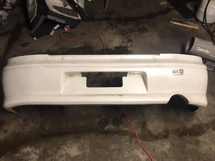

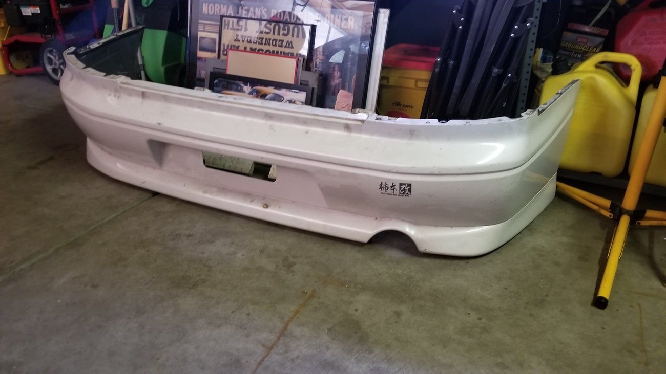

I have a JDM rear and was going to build a diffuser to close up the parachute of an air scoop that I have going on in the back.
Would it be better to just cut the cover? That's kinda the impression I'm getting after reading up on the topic.

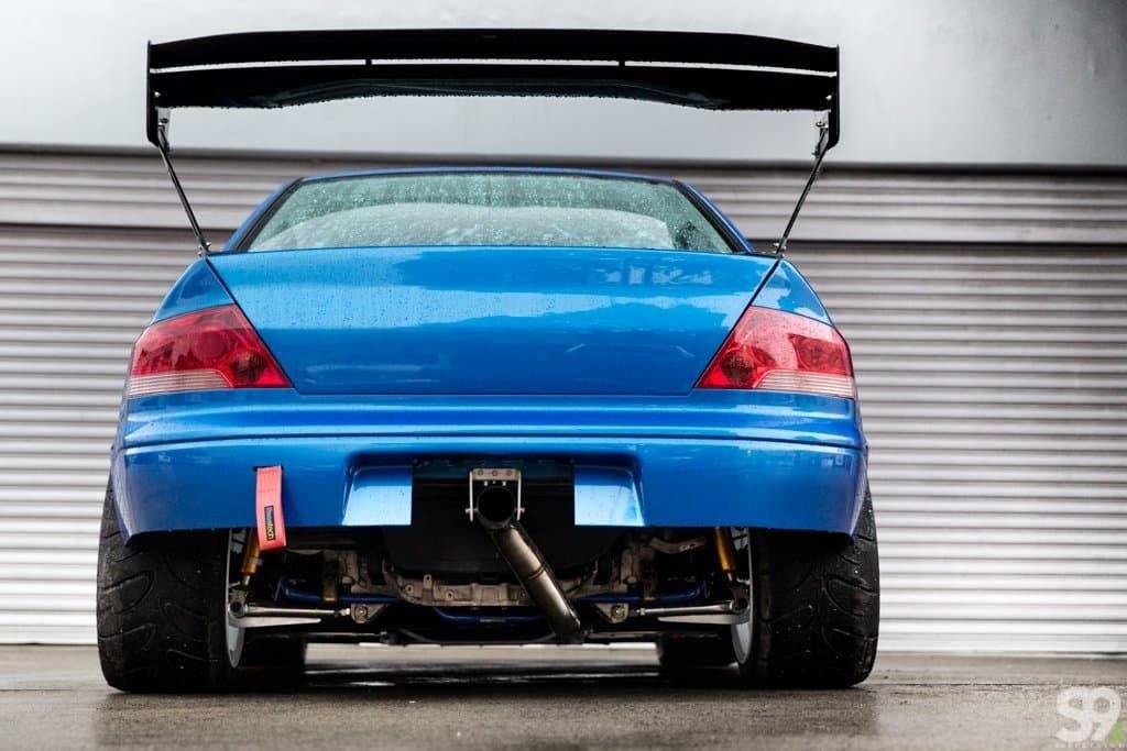

Oh stop. Its a supped up cheap econo car. And there are plenty of fast "hondas" with honda boy things done to them. I bought a JDM 7 rear bumper which I will chop. There is a nice line on Evo 7 bumpers which makes it easy to chop. Credit goes to Ayoustin who gave me the idea and was planning something similar but I think he just chopped his USDM Evo 8 bumper.

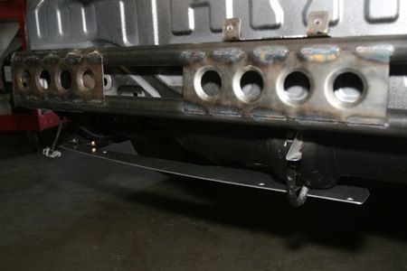

Don't cut the bumper, that's never going to look normal. Styling doesn't matter if it was a honda or a subaru or some drift car but don't do it to your evo. The jdm rear hardly has a parachute, its more the usdm rear has that problem. If its a genuine jdm rear then you have the license plate cut out which allows most of the air to flow out of that area anyways. Otherwise make a bracket like this to close that gap or something similar:

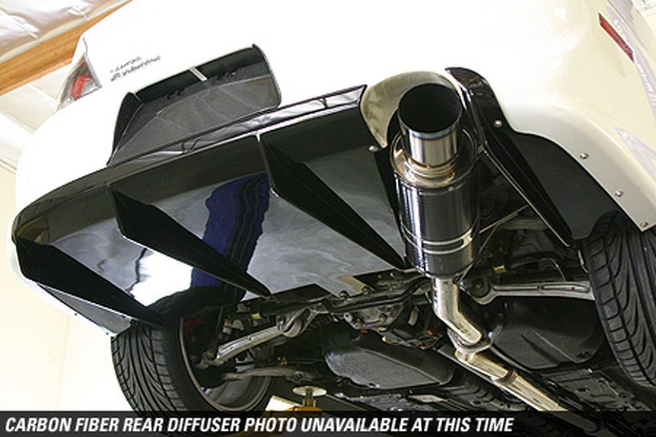

There's no point in cutting the JDM bumper my friend. Unless you're going to cut the trunk pan too cause it's quite close to it and very close to the same height. If you want to leave the trunk pan in place then you will never really need to cut the bumper because you won't achieve an aggressive enough ramp angle on the diffuser without causing flow seperation. If you're causing flow seperation you might as well have done nothing to start with back there.
Here is an Apr diffuser on a usdm bumper to show you how limited an angle you can run anyways. No point shaving the 1" off the bottom of a JDM bumper for that last 0.3 degree.
