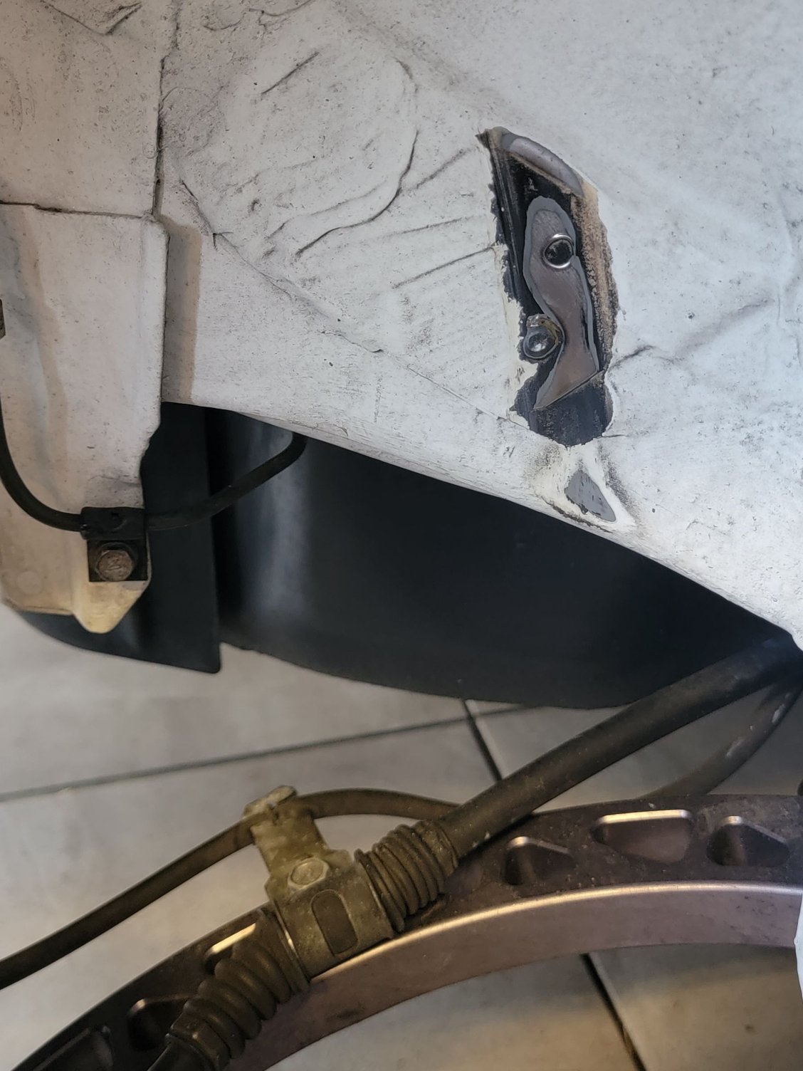

Originally Posted by ayoustin
The bushings are too small to have any amount of appreciable offset. Aftermarket arm is really the only solution.
ok I just checked, it seems the bracket wont allow the control arm to go inward
Racefab do fabricated rear uppers. If they have enough adjustment for what you require is a different question though.
Thanks, that should do it.
