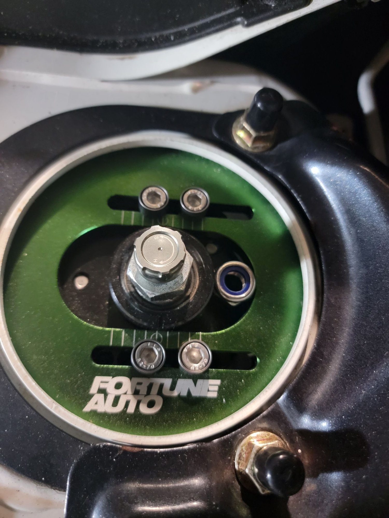

You guys probably know this already, but I'm just realizing this. I'm trying to max out camber from the tophat and just noticed the wheel/tire setup don't fit well anymore. So keeping my front struts vertical as possible seems to be the key
just FYI. I'm still trying to figure out how to get that extra caster from the tophat

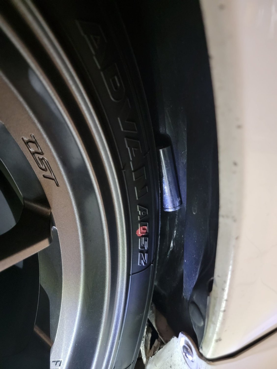

I initially set it up with max camber from bolt and tophat at zero adjustment. It cleared 99.9%. Trying out max camber from tophat (adds caster i believe) and a little from the camber bolt, the issue is not the tire-strut clearance but steering/full lock clearance ... the effective caster change gets the tire closer to the the backside fender lining and the tire now hits the frame. the tire seems to be sweeping instead of spinning on the contact patch

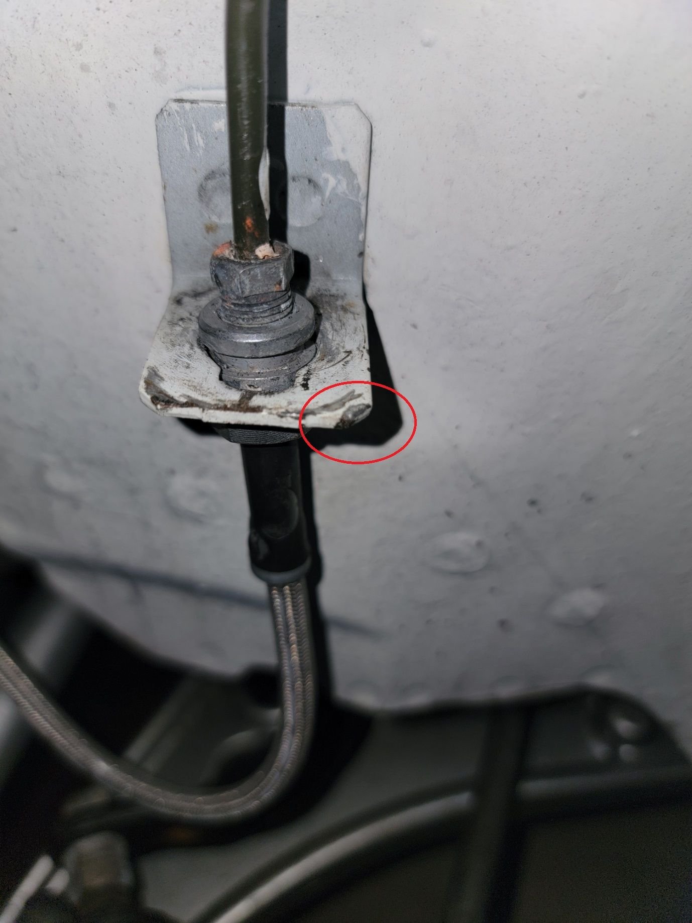

Found the rub with previous alignment settings. this bracket scrapes the very tip of the wheel lip
I moved some camber to the tophat so now it clears the bracket. I just figured out how to use the PA camber locks + standard camber bolts

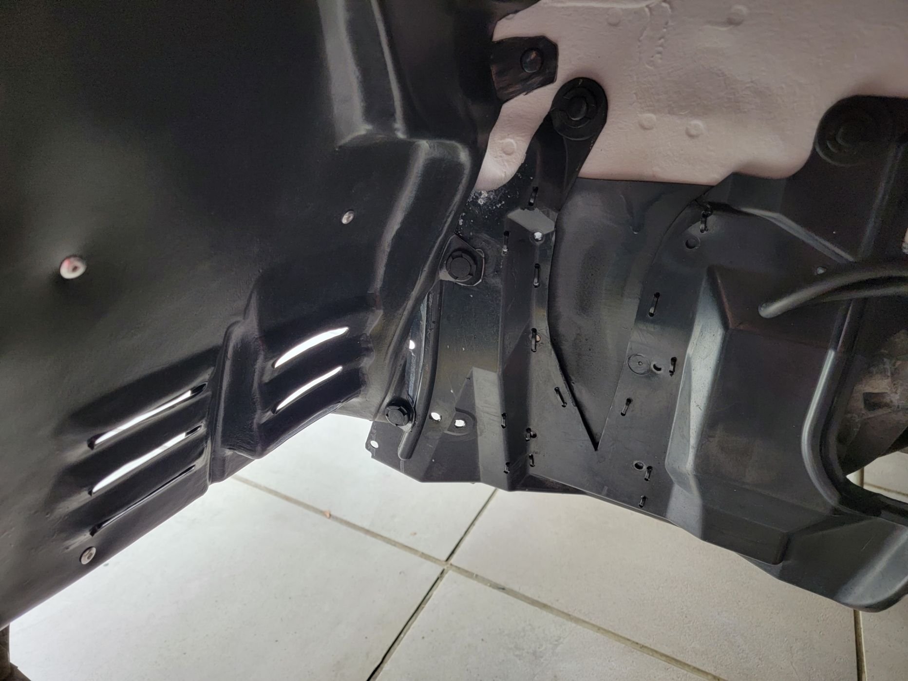

see here that I have moved the fender lining holes a few times. need to zip tie them too so they dont get blown in at track speeds
