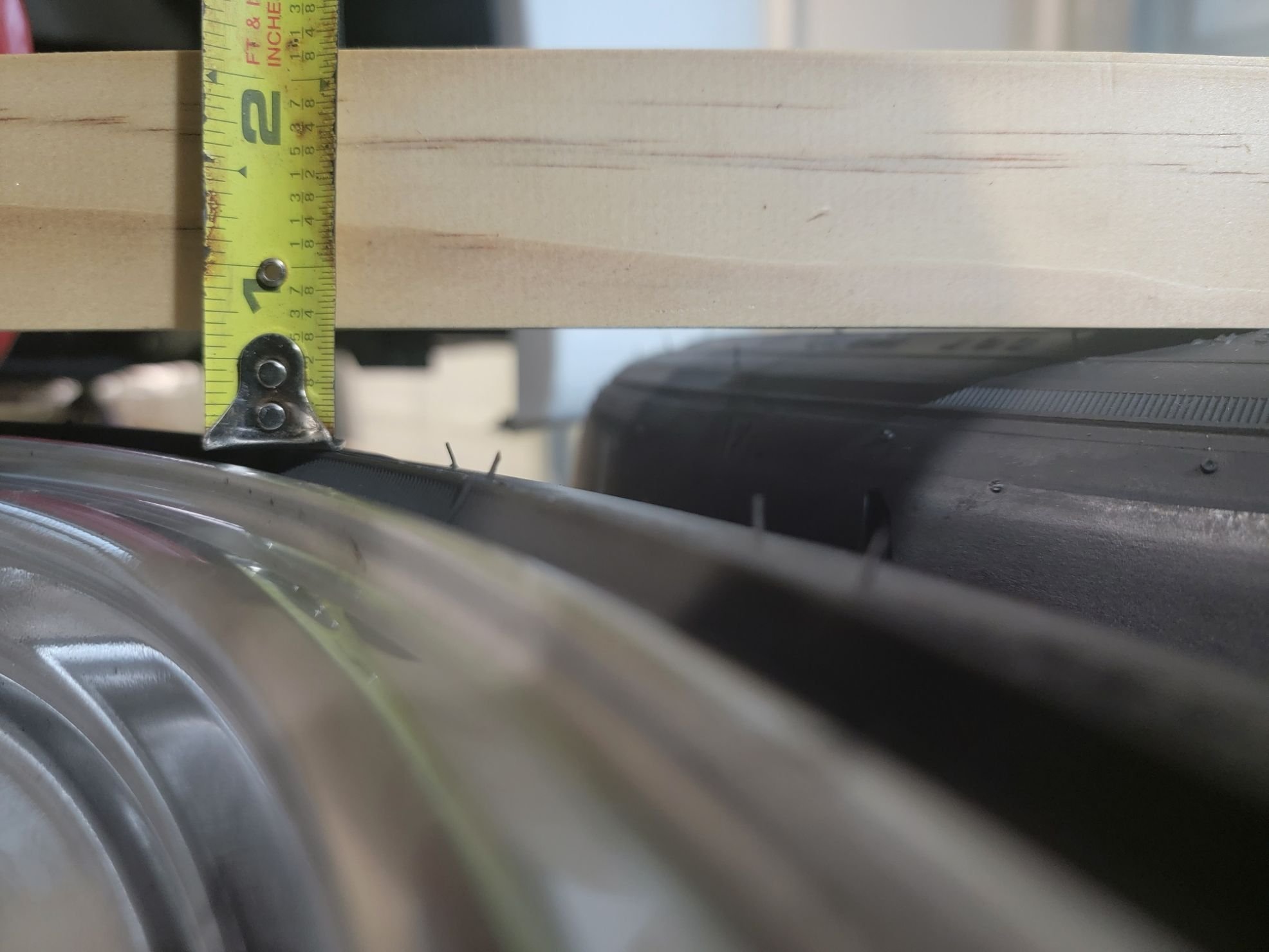

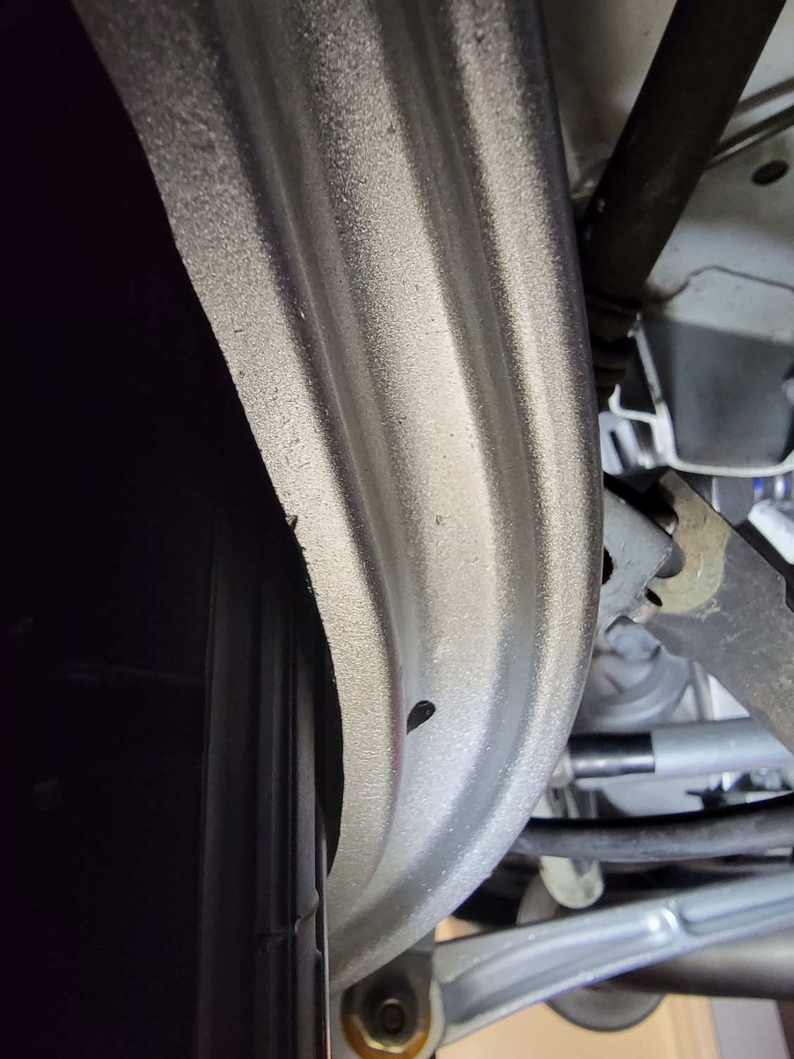

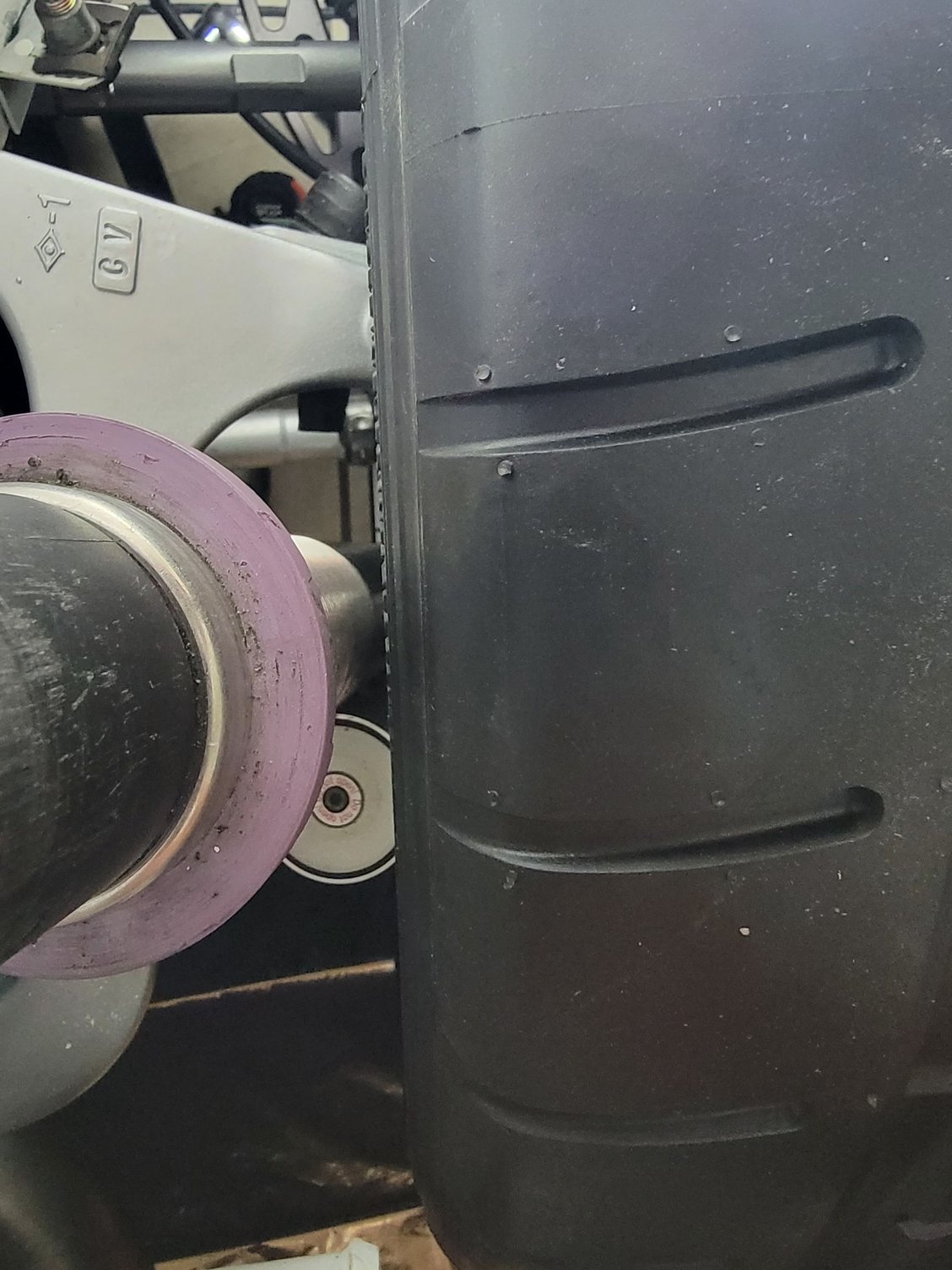

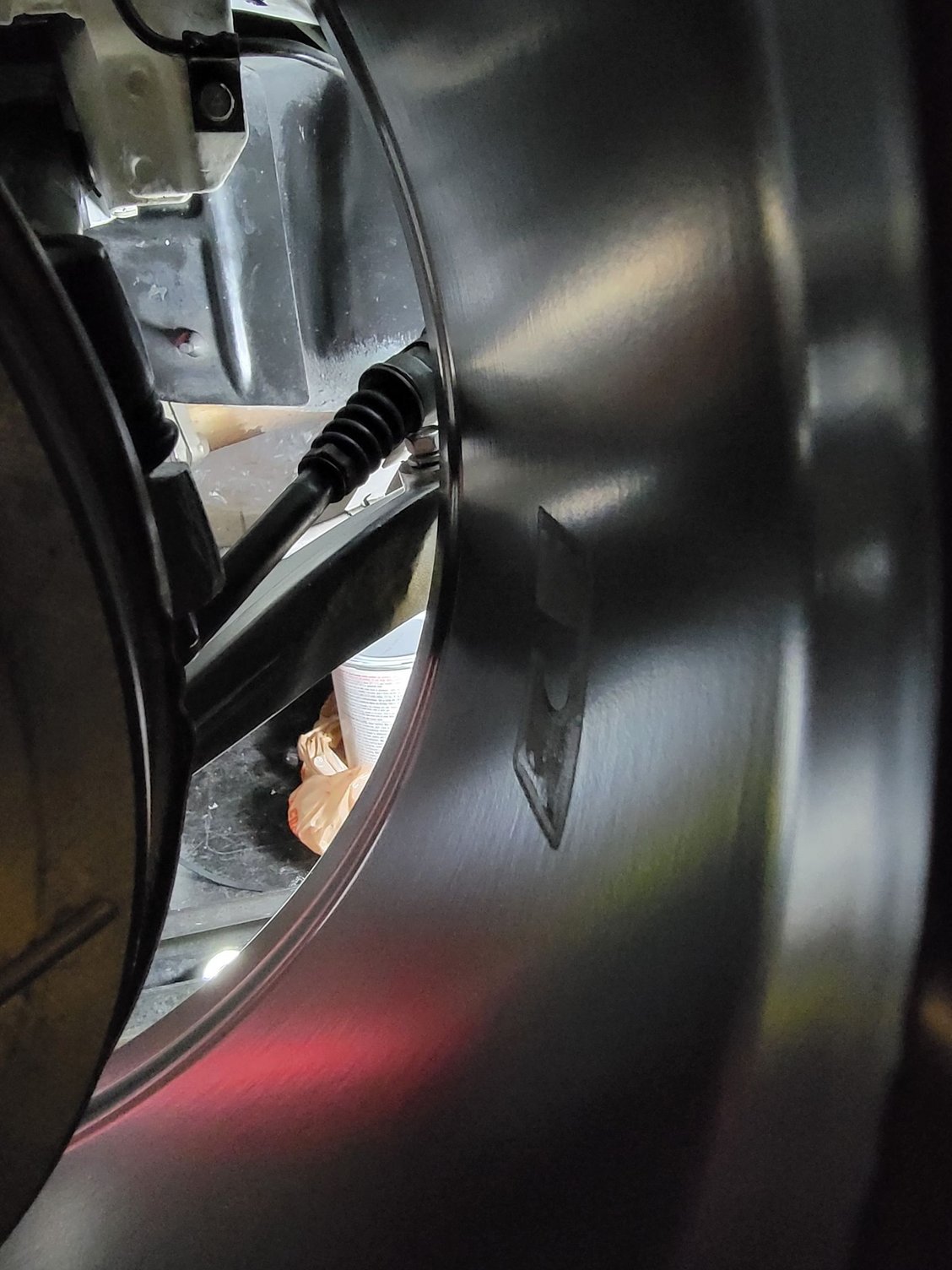

Oct 26, 2021 | 08:45 PM
  #65
Pics of 11" wheel & 295 tire. It's bit more square than I hoped. Currently with OE control arm, but might go back to adjustable arms depending on alignment settings
tire to frame
7.5" from perch to top hat
Reply 1

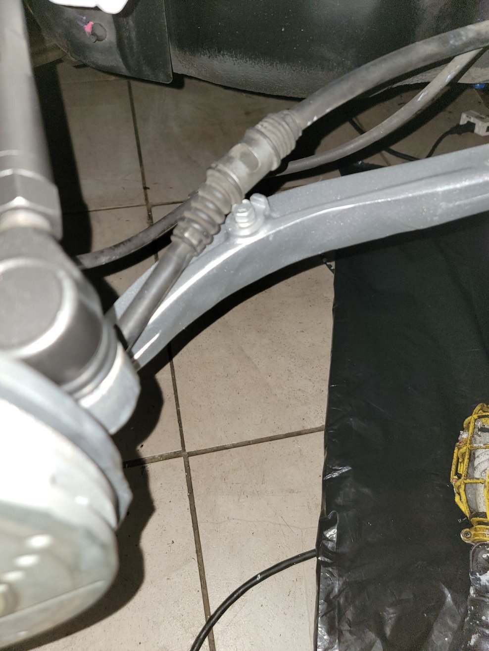

Oct 27, 2021 | 12:18 PM
  #70
Weil, it kinda fits. This is a control arm i had been grinding for 17" hoosiers, way back in my ASP days. A little bit more grinding and 18x11 wheel/295 tire might fit, but way too close. Maybe you can trim the shoulders of the trailing arm bushings. Goodluck to whoever wants to try it. Maybe one of these days i will cut my trailing arms on my table router

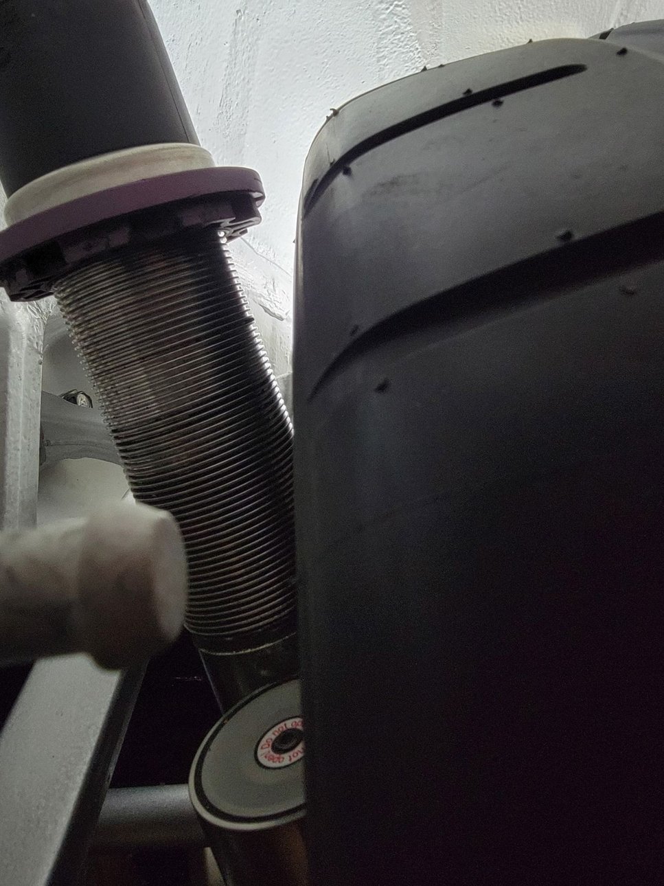

Feb 22, 2022 | 07:56 AM
  #73
Quote: I run the 18x11 +15 TC105X wheels with the 295 A052 up front. No spacer, completely stock front fenders. However, fitting these will be dependent upon what spring/coilover combo you're running up front.
@LV///R do you have a pic of the fender gap? looks like I have to lift my car a bit to save the fender linings :P

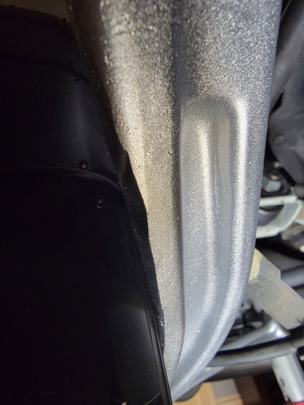

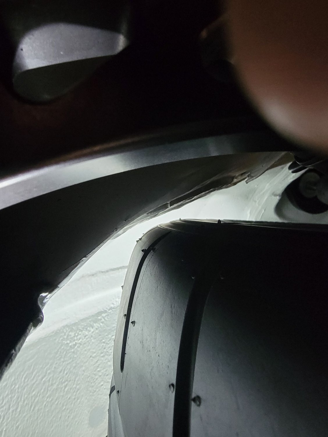

Feb 22, 2022 | 01:06 PM
  #75
Quote: @LV///R do you have a pic of the fender gap? looks like I have to lift my car a bit to save the fender linings :P
Absolutely! This isn't the greatest view and I'll do more looking when I have time. But this was taken in Sept '21. I know the inner liner is cut up from the tire. Other than that I think there wasn't any other noticeable wear (other than behind the tire on the side skirt of course)
