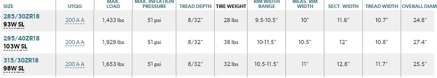

Anybody tried 285/30 RE71R or RT660 on an 11" wheel? The wheel is 0.5" wider that recommended. Is this a big no-no?

RT660 run wide, it would fit pretty square I'd wager. I know a couple guys running the 255 RT660 on 10.5" and they have a tiny stretch, just a hair more than my 275 RC1 is on my 10.5" wheels.
My bigger concern would be fitting the 11" wheel. If you're not wide bodied in the rear you need a very high offset wheel to make that work and those options are few and far between.

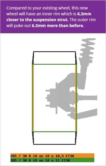

Thanks for the info!. STU guys are begging to buy my cruddy NT03 10.5" ET30 so I thought maybe i'd go wider. I just found out today that the Enkei GTC01RR 18x11" ET30 is not available with 5x114.3 (only BMW bolt pattern) *sigh*. so I'm back to shopping around for streetable wheel options.
My car isn't lowered and just enough to scrape getting off the driveway, and I was ok with a bit of tire sticking out at the back (shaved fender lip)..

Unless your rear quarter is very pulled an 11" +30 is still too low. You need to be around +40 to stay relatively underneath the stock metal. Konig, Forgestar and Momo all have wheels that fit the criteria but it's still a super tight squeeze and I don't know how much or little inner clearance there is.

I understand. just with 285, similar to what i have now (and not too lowered), the tire should technically stay where it is. the additional width will not reach the fender or spring perch (6" 60mm spring).
anything wider I'm back to the drawing board (shorter springs, mismatched offset, flares)
The additional wheel width will unroll the tire slightly, so I wouldn't count on even the tread width staying the same. I wouldn't count on ride height to avoid contact, unless you can confirm that your rear shocks don't have enough travel. Whenever I remove the rear spring on my Ohlins and cycle the suspension I'm amazed at how much up travel I have back there. The tire and wheel really tuck into the body and you have to be prepared for that

Yes the center of the tread stays in place but you still bring the sidewall out a 1/4" and that will likely rub.
Yes, tons of high level TA guys run Konig wheels. They make an 18x11 +40 Hypergram. I wouldn't run mustang wheels, they use M14 studs vs our M12 studs and you'll get a smaller contact area on the nut taper because of it.
I've run up to a 20mm slip on spacer on my ARP studs. I wouldn't run more, that's barely max thread engagement on my short open end nuts.

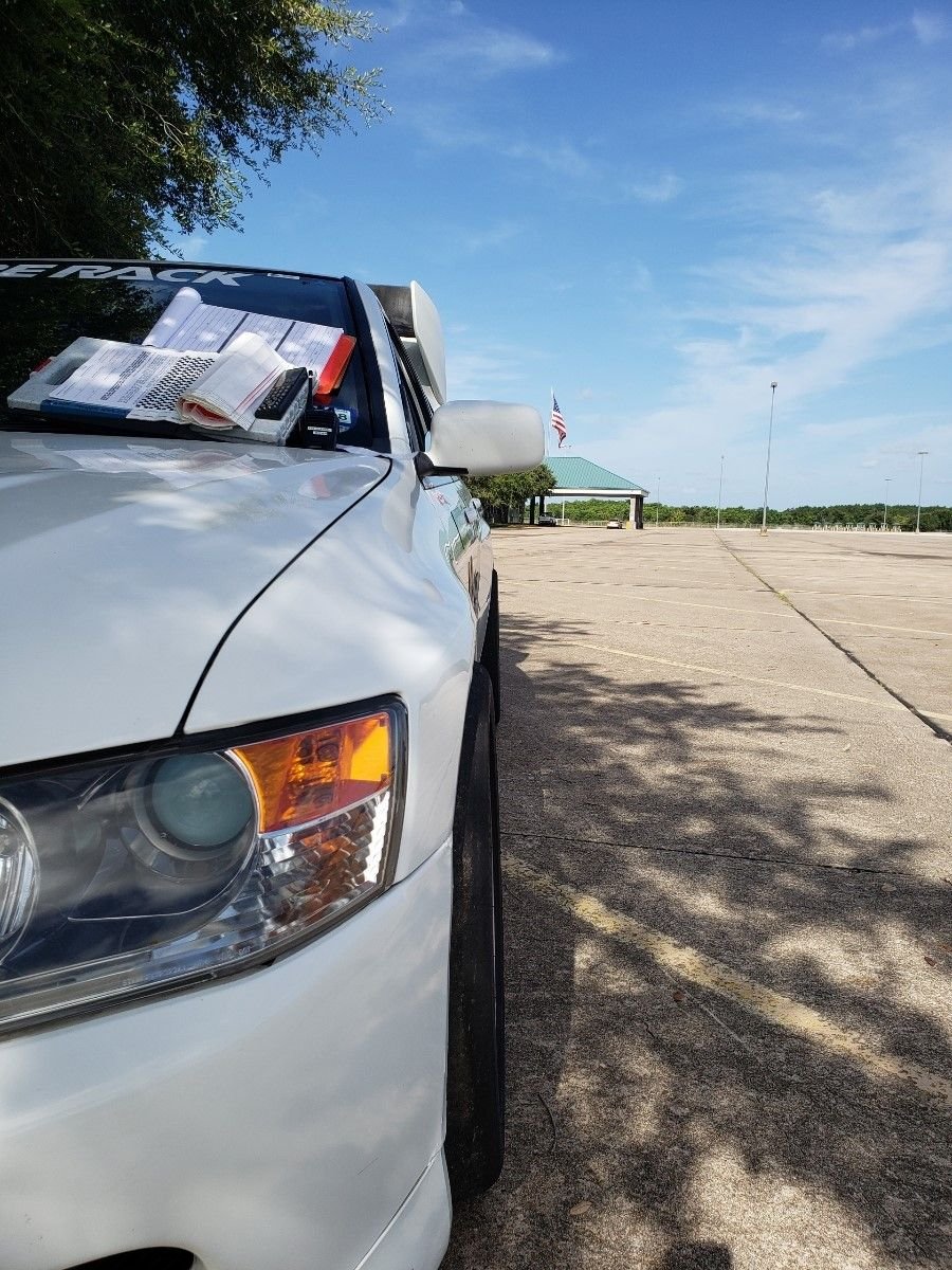

This was my pinched 295/17s. no issues with the fenders at this ride height, autox only set up tho.
