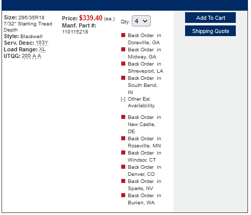

Old Sep 3, 2021 | 05:30 PM
  #44
LV///R's Avatar
iTrader: (36)
Posts: 1,593
Likes: 226
From: US
EDIT:
It shows that the 295/ 30 /18 (not 35) is in stock at tirerack....
I would only recommend the 30 series profile for the Evo 8/9 as it's aleady a tight fit up front. A 35 series will be even tougher to fit.
Old Sep 3, 2021 | 07:56 PM
  #45
ViciousLSD's Avatar
Joined: Oct 2011
Posts: 3,858
Likes: 600
From: Houston
Originally Posted by LV///R
EDIT:
only 2 for a week now
