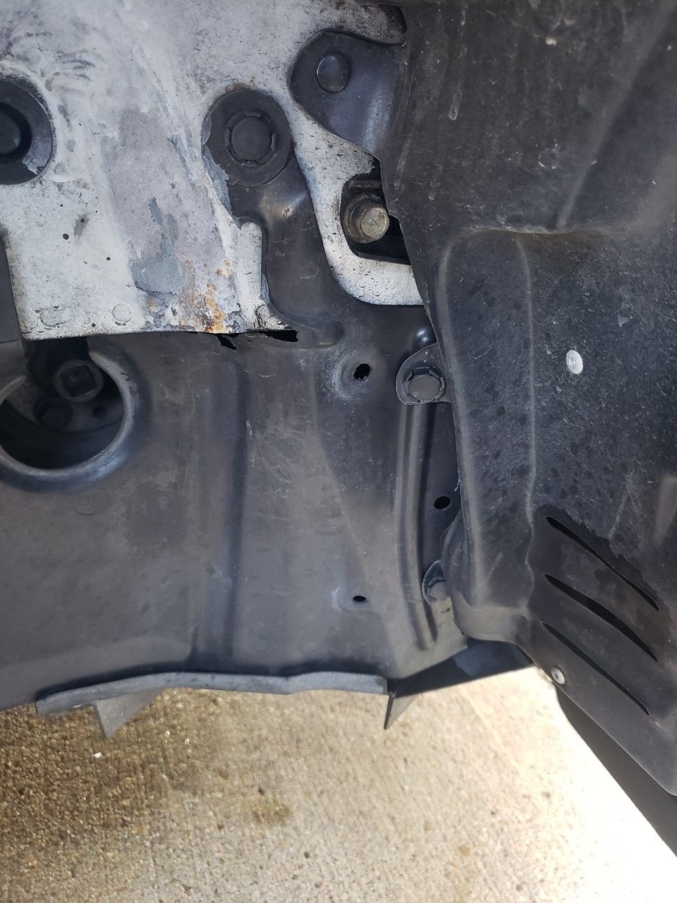

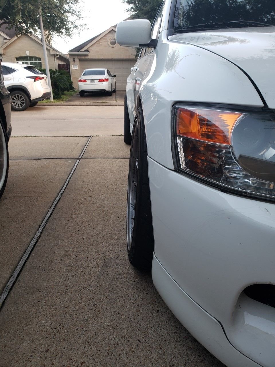

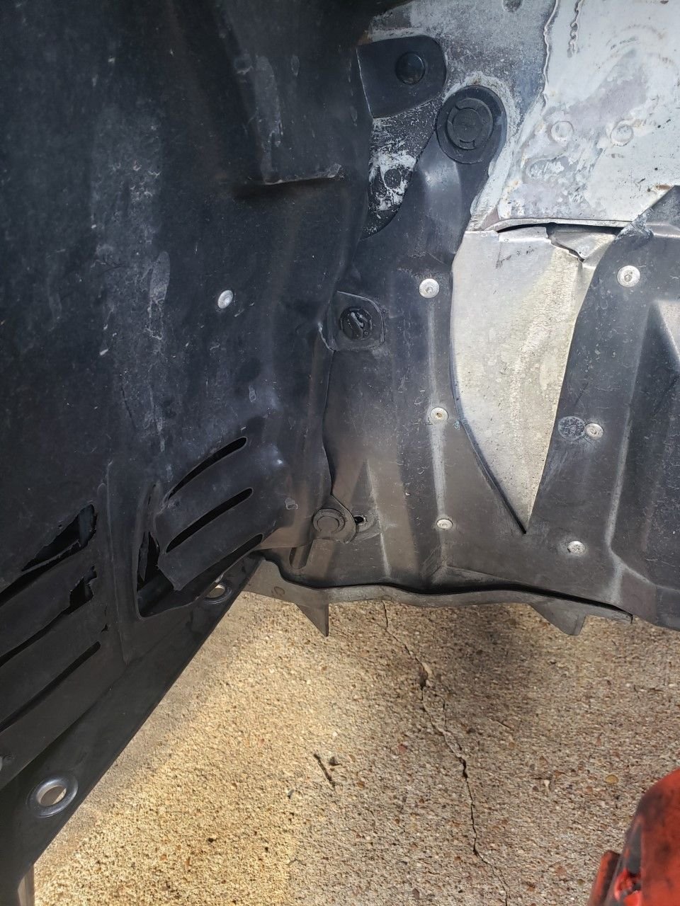

I took my autox setup (minus e85 and RSB on full soft) to the track. This protrusion of rear wheels didnt give me any problems even when going over those raised curbs. I won the 10lbs-to-1 class, setting my best time after boiling my brake fluid and brake-checking every chance i get. Looking forward to going back, in the 8-to-1 class next time
no contact with with the frame (shoe polish on the rub area). also note that I moved the rivets of the fender liners to make room. also the previous wheel setup already made some room by the frame side

Have any side view or close up shots of your rear wheel/tire setup?
Thanks!
Old Aug 23, 2021 | 01:27 PM
ViciousLSD's Avatar
Joined: Oct 2011
Posts: 3,858
Likes: 600
From: Houston
Thanks!
I just found one
I'm gonna miss these NT03s
