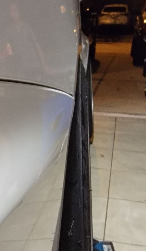

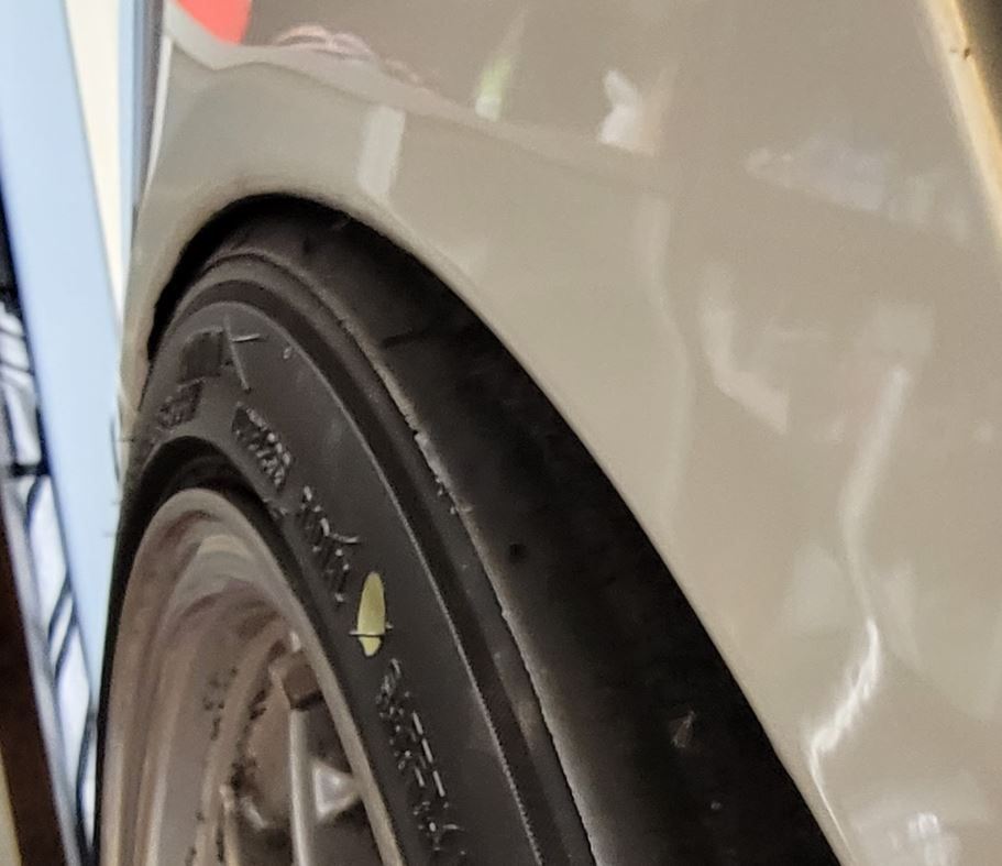

Current wheel NT03 18x10.5 ET30, 285 30 re71r, poking and tucking. I have shaved fenders, adjustable LCAs, adjustable toe arms and SSB trailing arms
basically only the thread pattern tucks

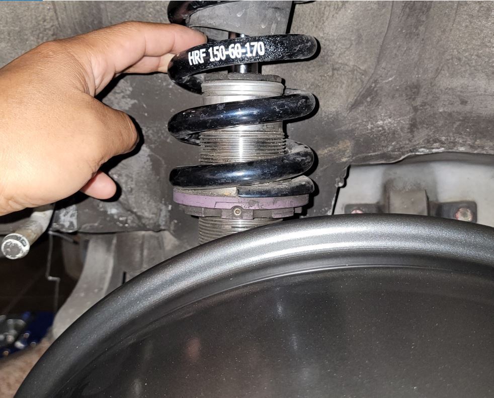

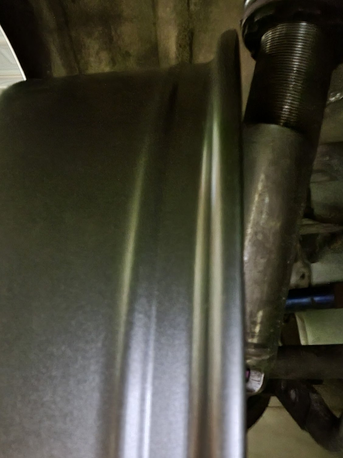

New wheel Konig Hypergrams 18x11 ET 40, minus 3.7mm poke (yay!)
6" spring, I will get 5" to clear 295 30

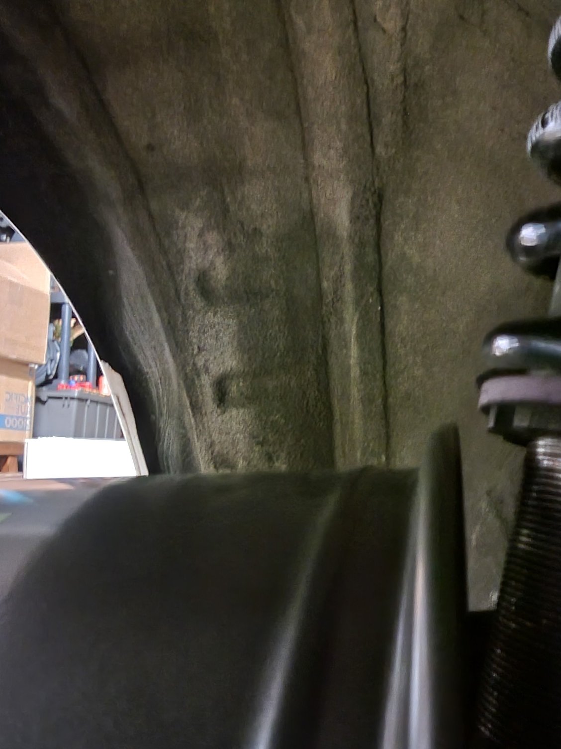

forward clearance

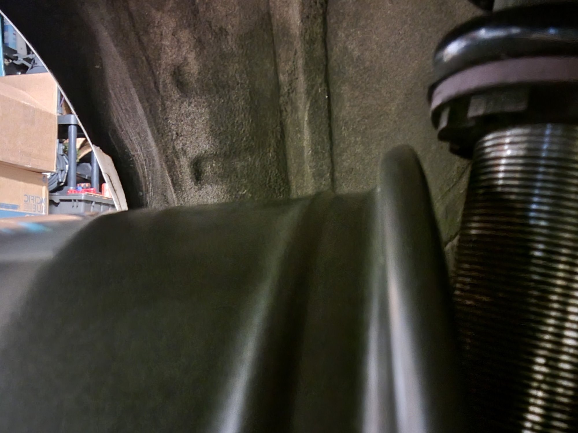

This is probably the best angle, the others are kinda misleading
(correction) there is 18mm between wheel and shock body, measured ~7mm under the spring perch, so theres more once its raised.
So yeah we can fit 11.5 wheels, 315/30 tires (rear only) (nope!)

From: SC
Thanks for the photos. Will definitely be interested to see what it's like with a tire mounted. From what I've seen, even on the 10.5 NT03 a 315 requires trimming the sheet metal at the front of the wheel well to clear the tire. That might be ride height dependent though, I've never looked for that on my own car.
Thats a no-go. the sheet metal will definitely chop on the thread pattern. even with 295s

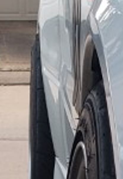

Just so we're on the same page, I'm talking about the inboard metal, not the outer fender. So I don't see how using a wheel which comes further inboard has more clearance. The car pictured below is on the 10.5 NT03 and a 315.
oh I see what you mean, especially when the suspension is compressed. that could work for me as a bump stop
so that car has cut outer fenders now too i suppose?
