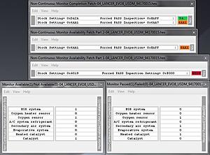

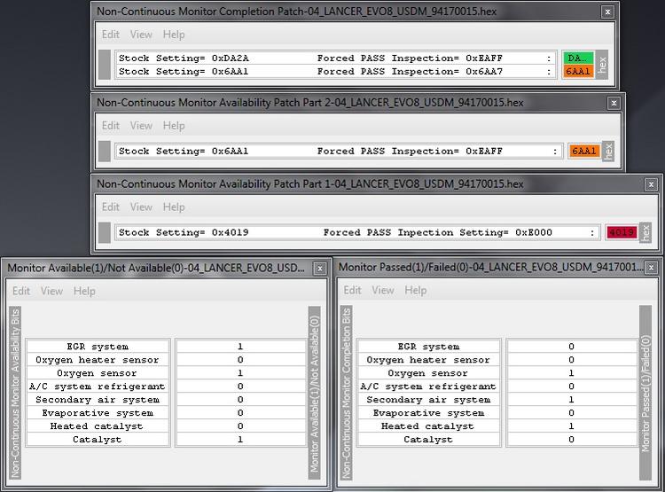

These are the factory settings for a 94170015 ROM. If you get a CEL, you will need to fix the issue prior to attempting to go to the MAC station. You can disable the notoriously bad P0300 periphery bits though.
Again, I am not condoning any illegal activity here. I am merely showing you how to put it back to stock settings so everything is fully functional.
