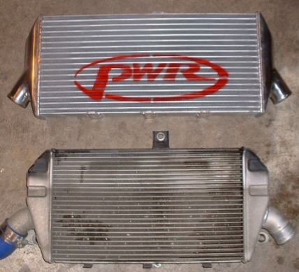

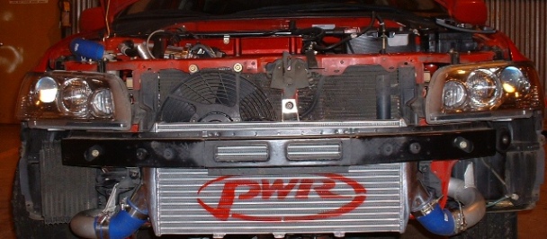

More pics.
Attached Thumbnails It begins now.....-ic-comparison.jpg   It begins now.....-dscf0005.jpg   It begins now.....-turbo-comparison.jpg

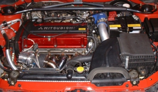

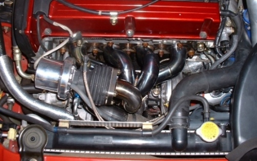

More....
Attached Thumbnails It begins now.....-engine1.jpg   It begins now.....-engine2.jpg
