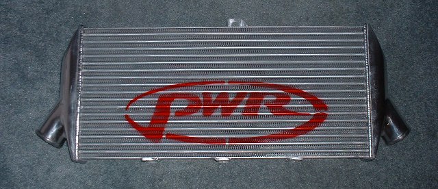

My new turbo and turbo related parts have began arriving. Here is some pics of my FMIC that came today. Since my new turbo is a little bigger then my GT3076, I figured it was time to upgrade the stock one.
Tomorrow the good stuff arrives.

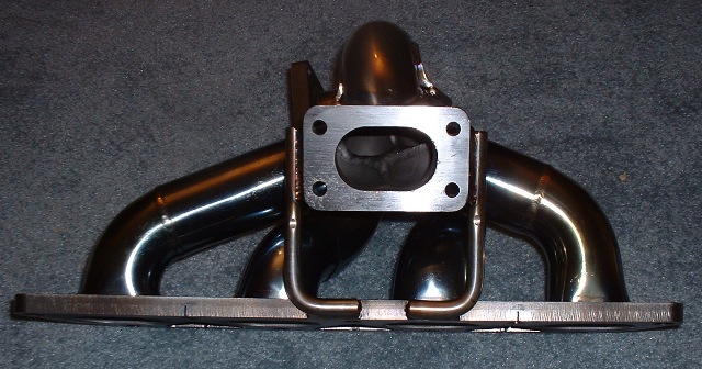

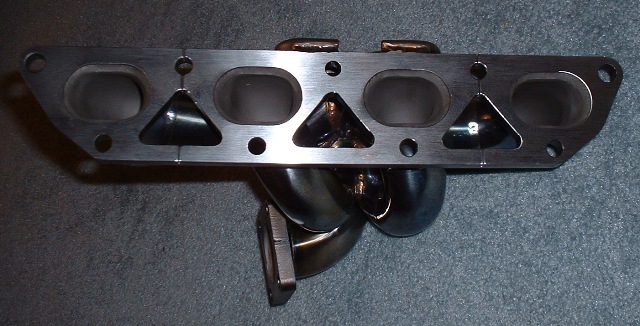

The manifold...
Attached Thumbnails It begins now.....-manifold1.jpg   It begins now.....-manifold2.jpg   It begins now.....-manifold3.jpg

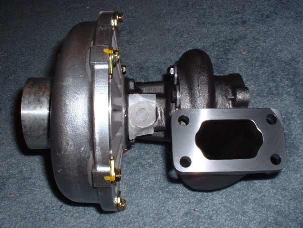

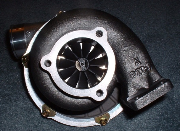

And the turbo...
Attached Thumbnails It begins now.....-ihi1.jpg   It begins now.....-ihi2.jpg   It begins now.....-ihi3.jpg

What you are looking at is the Apexi Isamu RX6B turbo kit w/ a RX6B TCW77L turbo. This is the most complete kit I have ever seen. It even comes w/ an A/C compressor heat shield and thermal wrap for the header. The turbo is rated from Apexi at 560hp, but the CyberEvo makes 750hp w/ it . I am looking for 410-425whp on pump and 500-525whp on 100oct.
The turbo is definitely bigger then my GT3076. The compressor housing is huge. Especially, w/ its small turbine housing.

In Garrett turbo terms, the turbo has roughly the same size compressor wheel as a GT35R, but the turbine wheel is just a little bigger then a GT30R. The biggest compressor cover you can get on a GT35R is a .70 A/R and this turbo has ~.81. It should spool up slightly better or the same as a GT35R.
