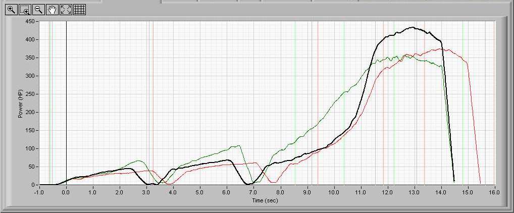

Here are some graphs compared to my GT3076. Red & black are the GT3076.
Not too bad for not making 20psi until 5500rpm .

Looks like with some more tuning you should be able to get at or over your 3076 !!!

The GT3076 was run at 23psi/28psi. The RX6 is only running 20psi w/ my messed up boost control. I am ordering a MBC today to try and fix the problem..
