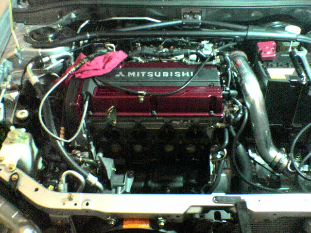

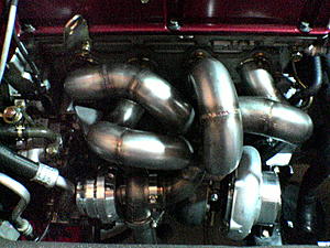

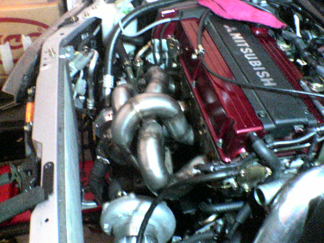

Build update Day 2
So today i got to remove the radiator and turbo/hotside. I am a 1 man army would of been easier if i had somebody help me but I couldnt wait. The o2 on the hotside was a pain in the *** to remove but i got it done. Reminder to put some antisieze on there when reinstalling.
Fitted up the turbo and forgot i need a slimline fan thanks to Ifarted2 for the reminder. Manifold/DP lines up nicely, hopefully next week i can get manifold/DP/wastegate dump pipe off to the ceramic coaters next week so i can start installing stuff.

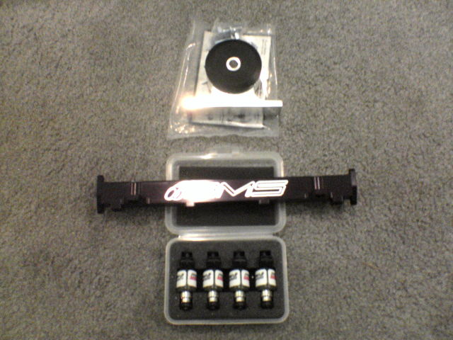

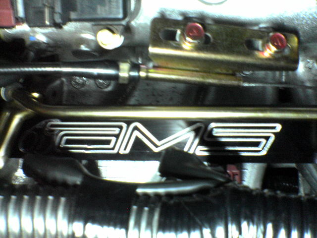

Build update Day 3
So well last week i had a little setback when installing one of my injectors i bough used i forgot to put the black spacer back in and it crushed one of the injectors ohh well. So got a new set of injectors and a few more goodies. AMS fuel rail and Agency front motor mount, and replacement 880 precision injectors.

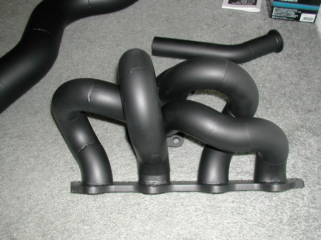

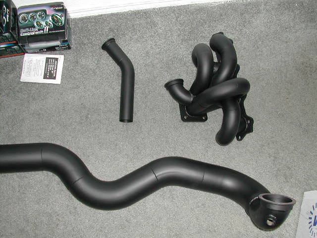

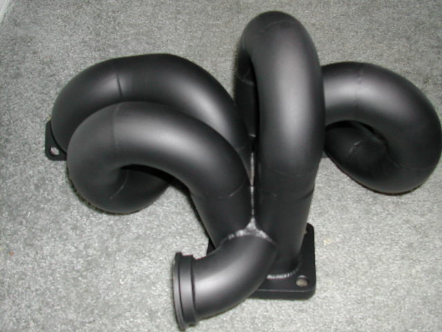

Build Day 4
Just got manifold/DP/WGP back from finnish line coatings!! All business Black! Now its time to start installing. If anyone wants to stop by sat/sun to lend a hand come on down Freebeer No cover. Hopefully I will be terrorizing the streets in a week or so.
Looks good, they did all of my turbo/exhaust stuff too. Just a little warning, I had the exact same turbo black finish and it burned off twice on the exhaust manifold. If you use see it start to flake, take it back and they will re-coat it for free.
hope i dont have to have it recoated last thing i want to do is take this stuff out again.
