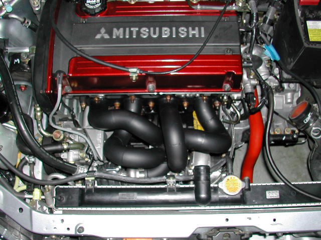

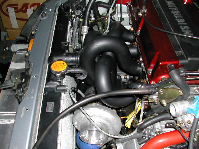

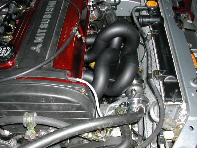

Build Day 6
Ok got manifold/turbo/DP all bolted up. Oil return line was a pain in the $#Q$#@ to fit right if that thing leaks i am going postal. waste gate dump tube is a tight fit with the DP/lower ic pipe right there i might have to reposition to get it just right.

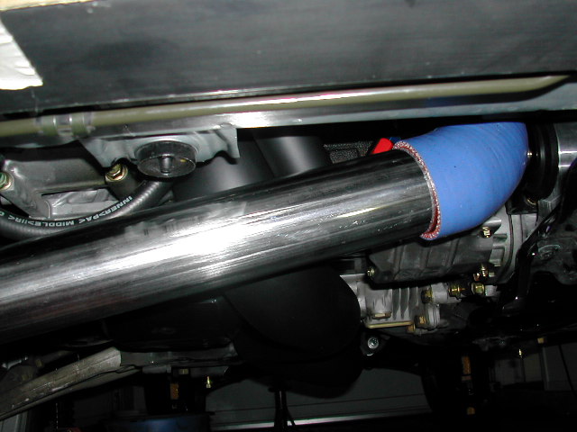

tell me paul which way do you have the Waste gate dump pipe pointed toward?? yours look something like this??

That is correct my son but however put a clamp on that licp...

Might have to extend the dump tube cause it will blow on the starter wires

Yeah i know that is just for mockup, and quit calling me your Son I am older than you remember!! I will try to get the wg pipe repostioned a little better off of the starter.

Well had to pull everything out and get the manifold seated better on the block a slight setback but got the coolant/and oil lines ran lower IC pipe is clamped up its a tight fit between IC/wg dump pipe/ DP there real close together should be ok with heat since they are ceramic coated. Need to have new upper radiator hardline made, and will be back at it on wednesday.

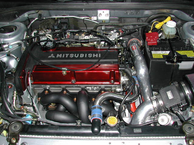

Build update day 7
Today got new upper radiator pipe/intake/upperpipes/Wideband in bung all installed. Now just need to wire egt/boost/wb/zeitronix setup and run the rest of the exhaust throw some colant in it and get MR tuner over here and we can start it up, and see if i got an leaks or other issues that need to be resolved.
