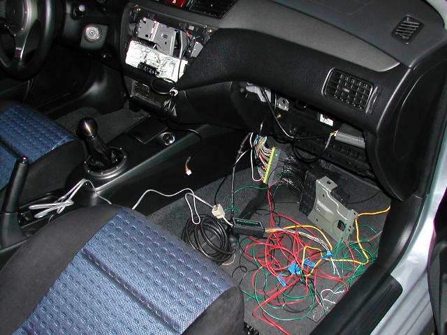

Build update day 8
Been a busy last couple days getting a few things to get this thing running. Exhaust is on, starter is fully thermal rapped, and wiring of zeitronix is all hooked up. Gonna get HPF Eric over here tommorrow and start it up!! Just gotta clean this wiring mess up.

Quick update,Start day!! pulled fuel pump fuse took oil line of turbo and put it in a bag started it up a few times to make shure I was getting oil to to turbo, we have oil. Put pump fuse back in reattached oil line checked fluids again looked good turned it over started!! Let it idle for a few minutes idled 14-15 afr, only problem no rpms looks like my rpm wire got disconnected, should be a quick fix.
