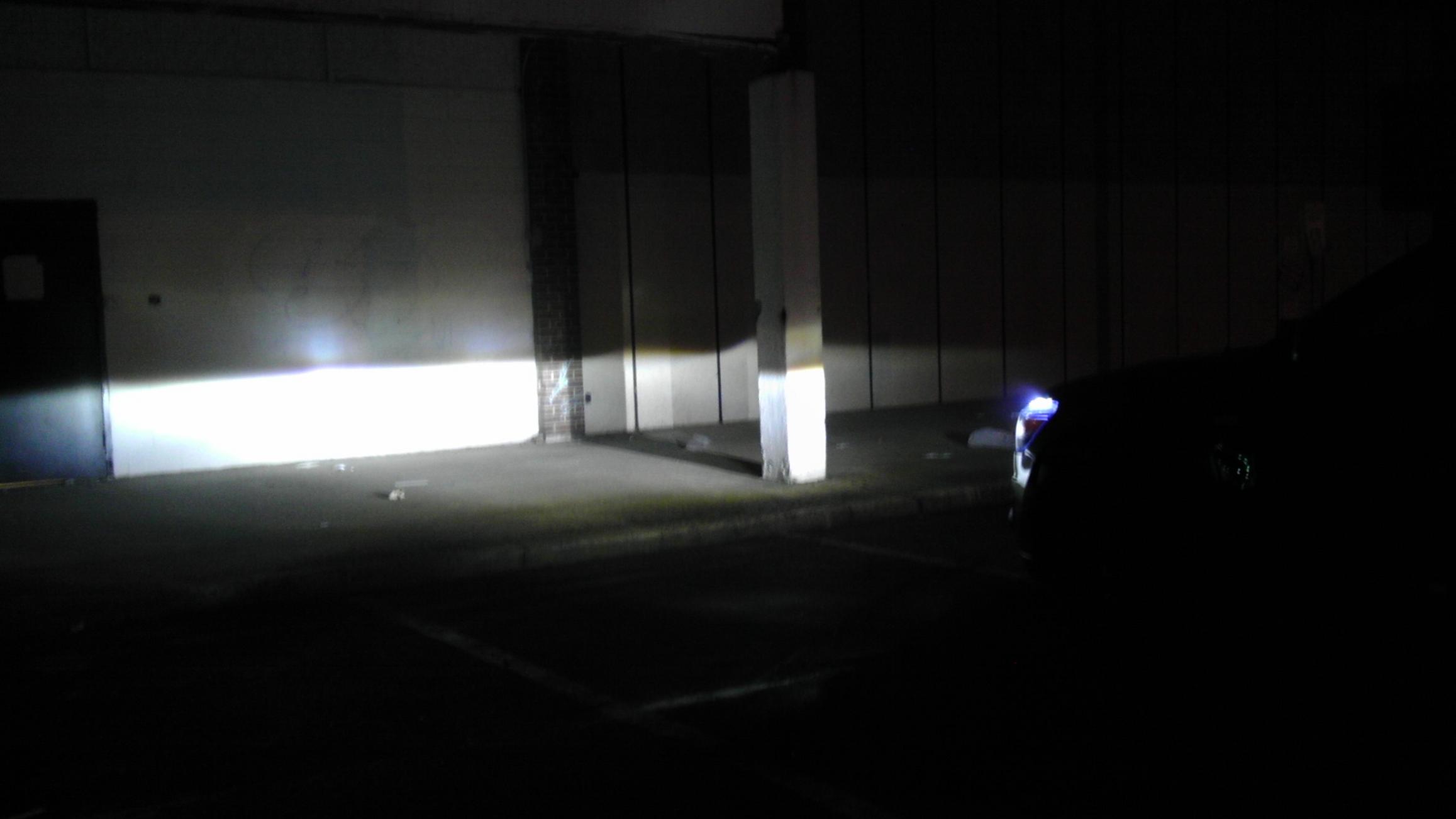

Okay, stopped by a dark wall on the way home, got a few shots and a video showing the DDM HIDs in the stock halo projector along with my A/V setup.
I'm not sure how it compares to the factory HIDs, but I am really stoked about having real HID cutoffs! This is my first car with stock projectors!

Halogen projectors aren't focused the same as HID projectors due to the way the bulbs output light. Halogen bulbs are 360 degree output, where as HID's by design are side firing/output. Because of this, the shape of the reflector and lens is different, as is bulb spacing from the glass. Some Halogen projectors will output OK with HID's, some will not. Generally (IMHO) HID's in halogen projectors are still better than halogen reflectors of any sort, which is why I have no problem helping out any of the ES guys with HID or other lighting/optics questions.
Now, this is the first I've seen the actual output of HID's in the Outlander Sport's Stanley projectors, and I must say that the cutoff is pretty sharp for a "plug 'n play". There is some noticeable glare above the cutoff, but it doesn't look to be too intense, so it shouldn't blind oncoming traffic. The cutoff shape is also a bit different. Yours seems to have a little curve with a point on the far right, where as the OEM has the standard "stepped" design with the little angles in the center.
Overall, yours looks really good. Now hopefully people will stick with HID's in the headlights and avoid the fog lights.
Does the ES have the leveling system?
Just for comparison, here is the OEM HID output:
And the OEM HID's on the SE model have the "Super wide" system, which is actually pretty awesome:

I'm not sure where the little light output above the cut off is coming from, maybe the super bright led bulbs I have in the parking markers, because I stood in front of the headlights, crouched down until the cutoff is just below my eye and I couldn't get any glare except for the led parking lights. If this is really good for aftermarket HIDs in factory projectors, then I can't imagine having factory HIDs!

Next time you're out there, try covering the LED's and see if that stops the glare. I'll laugh if that's the issue lol. They are pretty good for aftermarket HID's. The only major difference I see is that yours are a bit more of a hot-spot in the center than the OEM, but as long as you can see well at night and they're not blinding oncoming drivers you should be ok.
