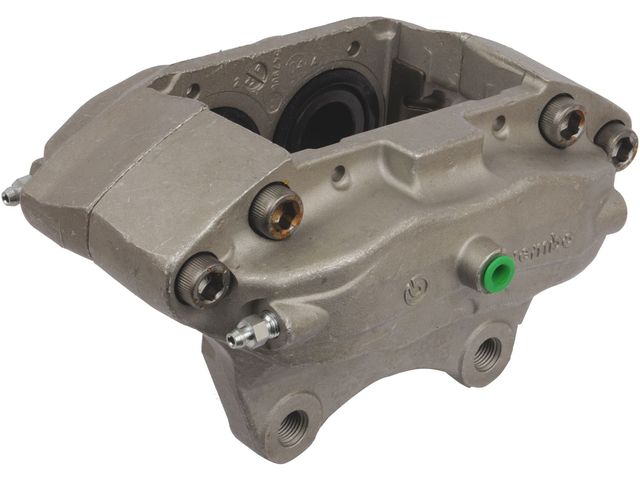

That's just freaky coincidence as to how exactly alike the Mitsu and the Hyundai caliper and bracket look.
When my new ones show up, (got confermation they shipped) I'll do some measuring of the bolt holes and bracket and post'm up. If someone can come up with the measurements for the OS bracket and caliper piston, we might just have something here for everyone.
I'll also measure the rotors when they get in. This could be a potential parts kit if we just did some elbow grease work.

I don't think anyone of us alone would have imagined a Hyundai vehicle might have similar brake components as our Mitsu's, let alone their performance parts...
Mitsubishi Outlander Sport 2011 / Brakes / Calipers
(Front Left)
OE Metal Piston;Supplied w/o Mounting Bracket
vs.
Hyundai XG350 2004 / Brakes / Calipers
(Front Left)
OE Metal Piston;Supplied w/Mounting Bracket
Please keep us posted on those XG brakes!

The Stock OS caliper looks VERY similar to the stock Sonata caliper. Sonata might just have a larger piston. Automotive makers use suppliers just like they've always done, so it would not surprise me to find that at least the Sonata Caliper and rotor would bolt up to the factory OS bracket.
There are plenty of aftermarket rotors and pads for the Sonata and Optima. BUT,,,,,, If the bracket mounting holes are the same distance, and the rotors are the same width, You'd have a VERY capable BBK setup using OEM parts (reman or not) and a choice of rotors.
The Kia Optima has a larger rotor than the Sonata turbo does. (why I don't know) Slotted aftermarket rotors run $105+ and the XG350 calipers w/ brackets are around $100+ including core. Even if youj can't return the stock OS calipers as a core, you're looking at $350-400 for a kit that's got better rotors, better calipers and what ever you chose for pads.
IF you can get You Pull It parts from a yard, you can save hundreds.

Now you got me thinking if any of those nissan 350z have brake components that would fit.
RF CALIPER - W/ BRACKET: $40
2003-2005 Front; w/o Brembo brakes
Calipers: 2004-2005 Hyundai XG350. Fronts should have twin piston calipers.
Or: 2010-2014 Hyundai Sonata. Fronts should be a larger piston and close to same rotor dia. as the OS.
If the rotor width is the same lining up with the caliper, then you should be able to use the Sonata rotors 2010-14, or use the Hyundai Vericruze or Kia Optima SX or EX turbo rotors. They are taller and will work with a taller Bracket like the one on the XG350.
After seeing the brackets from the Cardone website, I think it would be easy to adapt a "spacer" bracket just to able to use a larger rotor. They are essentially a flat piece from the knuckle up.
Most important,,,,,, If you look at the bracket, and how the pins connect the caliper, you'd see that there's a LOT of extra material that basically goes over the other side of the rotor. You only need the pins to give the caliper some room to shift to the rotor. A plate steel bracket like I use on my 1ton disk brake rear axle on the Jeep, has plenty of rigidity. (some guys even use spacers for the calipers they run) That being said, even a rotor that's slightly wider "hat height" could be make to work if you just shimmed the caliper to match and cut a bracket that would fit what ever caliper you chose. Still, we'll measure the bracket mounting holes when they come in and see if someone else can measure the bracket holes from the OS. that should give us an idea of what needs done next. I do know that based on others who've already done this mod to their Optimas, that the XG350 calipers are the bomb. Even if rotor thickness is the same on the OS, you could get the XG caliper mounted to the stock bracket and have twin pistons that grab well. Just change out the rotors for aftermarket slotted ones. (drilled are just a cosmetic look on a street car)

OK, the above link shows the pics and info of the XG350 calipers w/ brackets. Rather than load up this thread with the same pics, just click the link and scroll down.
I still have to get out the scale and get some weights, but here's a start.
The mounting holes on the XG350 bracket are 5.050 from center to center. If the holes on the OS are the same distance apart, then you've got a new setup to swap using OEM parts or some reman & aftermarket.
I've included measurements for the rotors I'm using also. They are the same bolt pattern the OS and other Mitsu models. 5x114.
