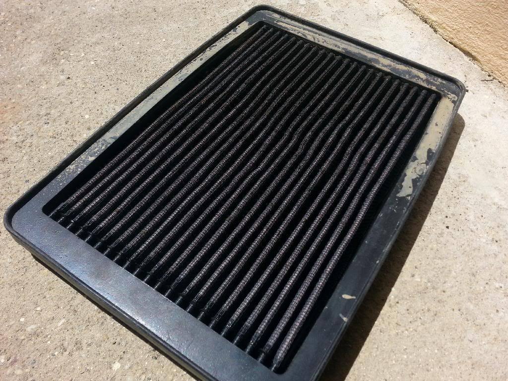

I dont know if someone already posted about this but I'm glad i found the right K&N for my '13 OS SE.....
Amazon.com: K&N 33-3015 Replacement Air Filter: Automotive Amazon.com: K&N 33-3015 Replacement Air Filter: Automotive
Attached Thumbnails K&n 33-3015-20150304_165435.jpg   K&n 33-3015-20150304_181649.jpg   K&n 33-3015-20150304_181125.jpg
