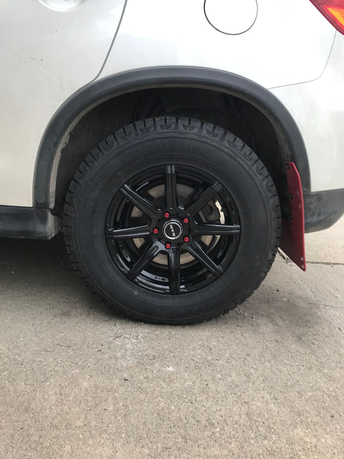

I purchased much lighter 16 inch aftermarket rims (Matched the factory camber and offset) and squeezed some 235/70R16 Sailun A/T tires on it. This seems to be the largest width I could fit without any rubbing.
It now has 1 foot of ground clearance compared to around 9 inches or so stock (New tires also gave it some height) and it’s much better for driving off road. Really makes Mitsubishi’s AWC system shine in the mud.

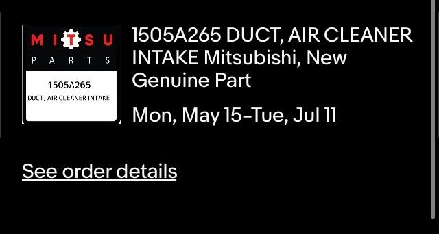

Lancer Ralliart OEM air inlet duct ($120) fit quite nicely after a little shaving and removing some plastic guarding that was blocking airflow. The 2.0 L screams like a banshee under full acceleration and you can hear it drawing the air. Definitely a power increase, better aspiration but possible slight loss of fuel economy. (I have a heavy foot)

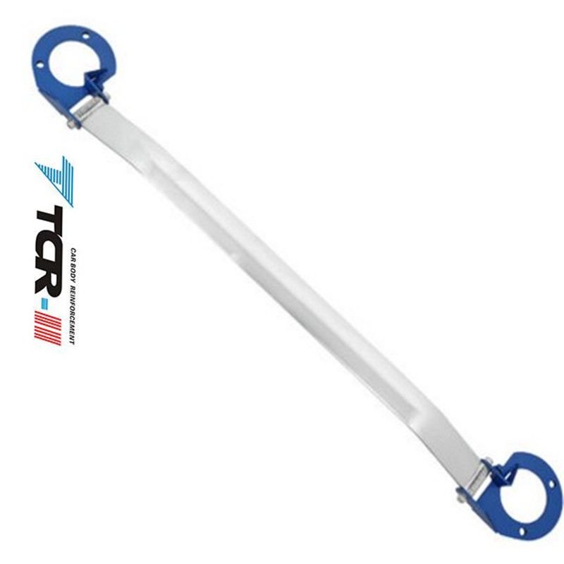

I purchased an aftermarket strut bar ($70) which tightened the cornering with less body roll.

Comparison to stock rim and tire
Rear height difference with Spring kit and tires. I don’t have a good picture of the front but it’s slightly higher than the rear.
Ralliart OEM Air inlet duct shipped from Japan

Aluminum strut bar, flat design doesn’t interfere with any fluid caps under the hood
