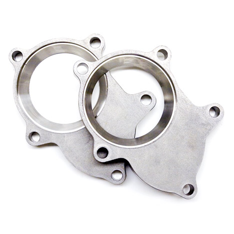

i dont know how far you are with the 02 housing but i found these at atpturbo.com
http://www.atpturbo.com/Merchant2/me..._Code=ATP-FLS1
or
http://www.atpturbo.com/Merchant2/me..._Code=ATP-FLS2

I don't see the point of welding a vband clamp to the flange if he can just weld the pipe to it.
why not? it would make removal of the 02 housing easier if need be and it is 3"
its just something i saw that i thought he might want to know about

I totally would have used that transitioned 5 bolt flange. I actually plan to do the same thing with a die grinder - it would have been easier to just buy that. I just discovered ATP turbo for fab parts yesterday, I actually have coolant banjo fittings and a silicone coupler coming that I ordered from them yesterday. They also have tight radius 3 inch mandrel bends, which would be ideal for the O2 housing. I got a larger radius bend and I think I'm going to have to do a JDM Ti style bend and cut a few tight sections and put them together.
I used ExtremePSI for most of my fab parts and random stuff, but I think ATP is a little better for the turbo specific stuff.

- I'm definitely taking notes on the 02 housing. If I'm happy with it and you like we can figure out something for you fo_sho.
I spent some time wiping off dirt in the engine bay. I decided to remove all the insulation on the firewall as well. That's always fun. I did it to the interior a few years ago. I just unbolted a few things and then started cutting it out section by section.
Before.
After.
I started grinding the O2 flange. This is as far as I got on a single compressor tank worth of air. The baby was asleep in her room above the garage - so I couldn't let the compressor fire-up.
