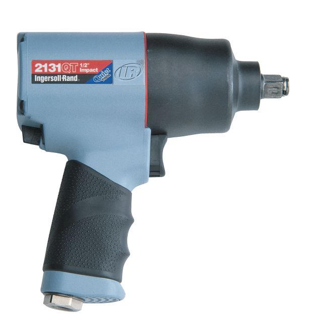

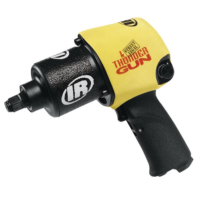

I'm now at two tools I've had to build. Yesterday I welded up a little something-something to get my new #1 SOB bolt loose. Previously the cam gears bolts were first on the list for PIA. Anyone who has done cams knows how tight those cam gear bolts are. I had to go buy a serious impact gun with a special socket to break them loose on my first cam install. Here's the one I have 600 ft-lbs
Well the impact gun had nothing on the crank bolt.
I'm not sure if NASCAR power would have broken it loose.
I had to build a 4 ft bar that I could bolt to the crank, since the engine was already on the stand with no flywheel. Then on the crank bolt I used a breaker bar with a 3 ft pipe extension. That finally broke it loose. I have pictures of that I'll load later.

A high torque impact gun with a stubby 17mm impact socket with built in universal will break the cam gear bolts loose. But it took me trying a bunch of stuff to figure that out. I've used that setup on a bunch of different cam installs, always have got them loose.
The crank bolt though - that thing is solid. I banged at it with the impact gun, even after I built the 4 foot bar screwed into the crank. It didn't budge. I had my Dad at the end of the 4 foot bar, and me basically jumping to load the 3 foot pipe I had on the crank bolt.

My crappy craftsman gun took off the crank bolt, i had to turn the compressor up as high as the regulator would let me but it came off.
