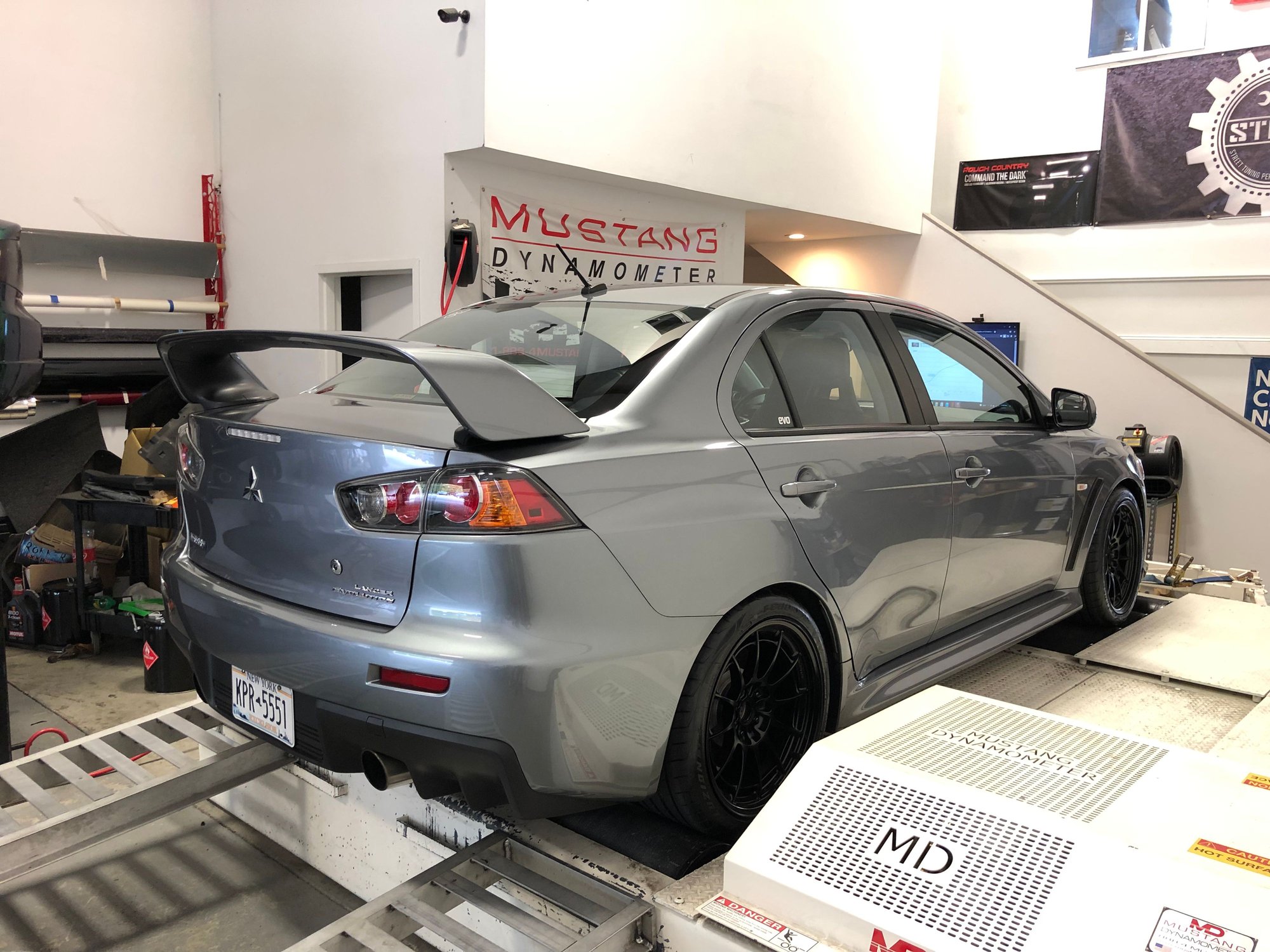

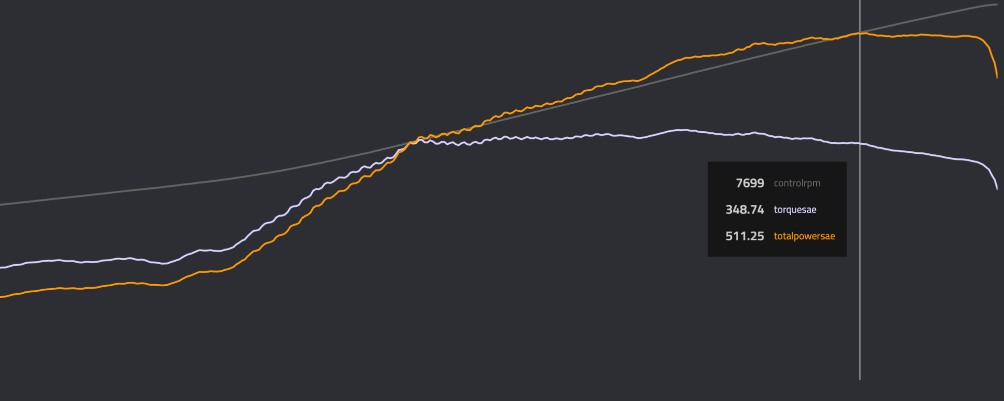

I put the Evo on a Mustang dyno today.
My hunch was right, the car is really down on power with the different parts compared to before. It's not flowing as much through the top for sure. I have the WGDC maxed and boost is dropping down to 27psi up top.
It's down about 80whp. I know this is a totally different dyno on the other side of the country compared to before, but the car does feel softer than before for sure. I think it's time to take the cat out and go back to a test pipe. I also wonder if this turbo (5558 Gen 2) is too small with the CNC ported head and cams. I'll probably leave it as is because I am honestly sick of messing with the car.
I think this Mustang isn't calibrated 100% for Evos as the turbo didn't spool as fast as it does on the street.
Mustang dyno data: https://datazap.me/u/razorlab/stpns-...g=0&data=1-2-3
Data log on the dyno: https://datazap.me/u/razorlab/evo-10...28&zoom=98-165

What Dyno was this done at ? Are the fuel AND air numbers lower ? While boost may be lower, remember that boost only exists due to a restriction. So with your head being upgraded boost could be lower but power increased (which I realize you didn't see both of those). So the Dyno is different , fuel, turbo, head, and exhaust now has a cat. Lot of changes.
Old Oct 9, 2021 | 03:20 PM
  #1740
RazorLab's Avatar
Posts: 14,094
Likes: 1,093
From: Mid-Hudson, NY
Mustang dyno right by the Hudson airport. Shop is called Street Tuning Performance -N- Sound.
Yup, that is what I am saying, I don't think the smaller compressor and the cat are working well with the CNC ported head and larger cams. If I had any more interest or energy left in modding this car, I would put a 5858 back on or a Gen 2 5862.
I might swap back in a test pipe and see if it changes anything. Especially since I no longer live in California.
