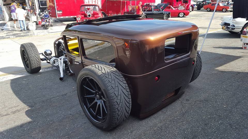

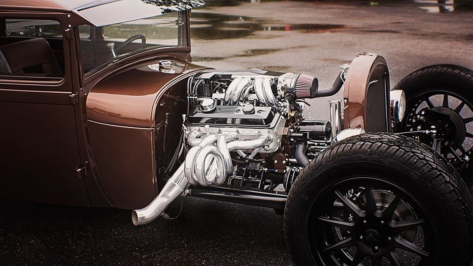

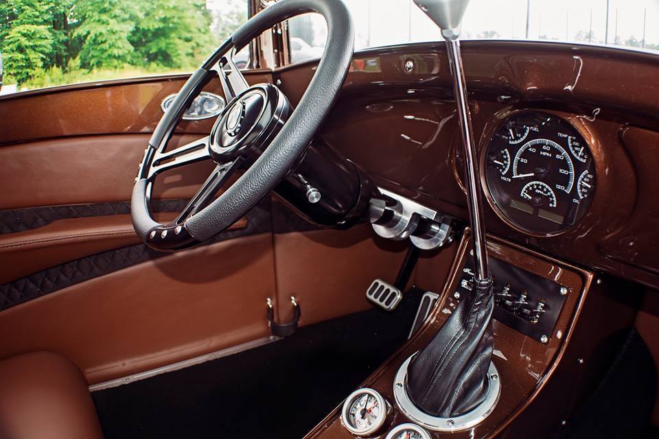

Here are some more pics of the "rat rod"... just for viewing pleasure

This one actually drives really nicely... it is a tad cramped inside, but it has saddle leather/suede seats and leather/suede interior...
The biggest issue with putting a 4G63 it is was cost... we had the rear end, trans and engine at the shop for free... so it was kind of a no brainer... we basically built the car for around 10k... we would have almost had that in the engine, trans, tcase, driveshaft, and rear end... the other thing is room, there would not have been any room to do the rear as we wanted to with the way the axles are set up... it is on air bags...

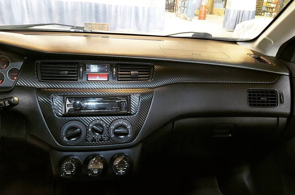

A new update for today...
The interior panels were beyond bringing back as they were stained badly with little black specs... would not come off with anything... so I ordered some CF vinyl and wrapped it yesterday... Came out pretty good... I didn't wanna really wrap the Radio bezel but it looked crappy not wrapped... so I went ahead and did it...
Next, I found a set of used GSC S1s local for a steal, and the guy delivered them to the shop for me and those were installed yesterday as well... While I was doing the install, I noticed that the motor side of the timing belt had been rubbing on something.
Fast forward to today, and I did a timing belt on it today... I had a slightly used belt off my black car that had around 7000 miles on it, so that went in. There was a bit of oil in the front case and it seems that no one put thread sealer on any of the tensioner bolts during the last timing belt service, and it had to come out to get compressed anyway, so they have sealant now as well...
Cliffs: Wrapped dash in CF vinyl, installed GSC S1s and Installed Timing Belt
