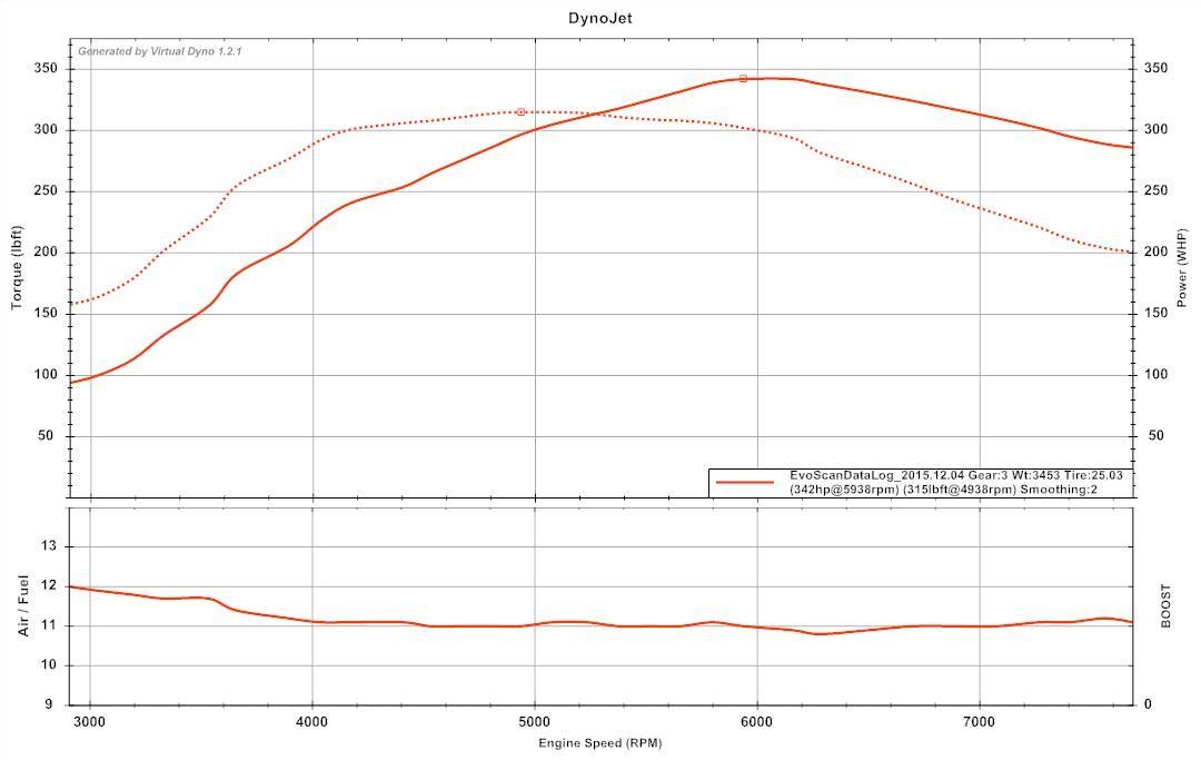

Finally had a chance to take it out an get a proper road tune on the heap today... timing was very conservative, and the way the boost comes in, I think I have a boost leak or the wastegate needs to be tightened... but stock injectors are maxed out anyway at 101% IDC... anyway here is what it spit out in Virtual Dyno...

Shouldn't the stock injectors flow slightly more? Seems like they maxed out a bit early

Hence why I think it has a boost leak... stock injectors are old as well, usually static is at 115% in Evoscan... fueling wasn't uncontrollable but also a little much for my liking...
