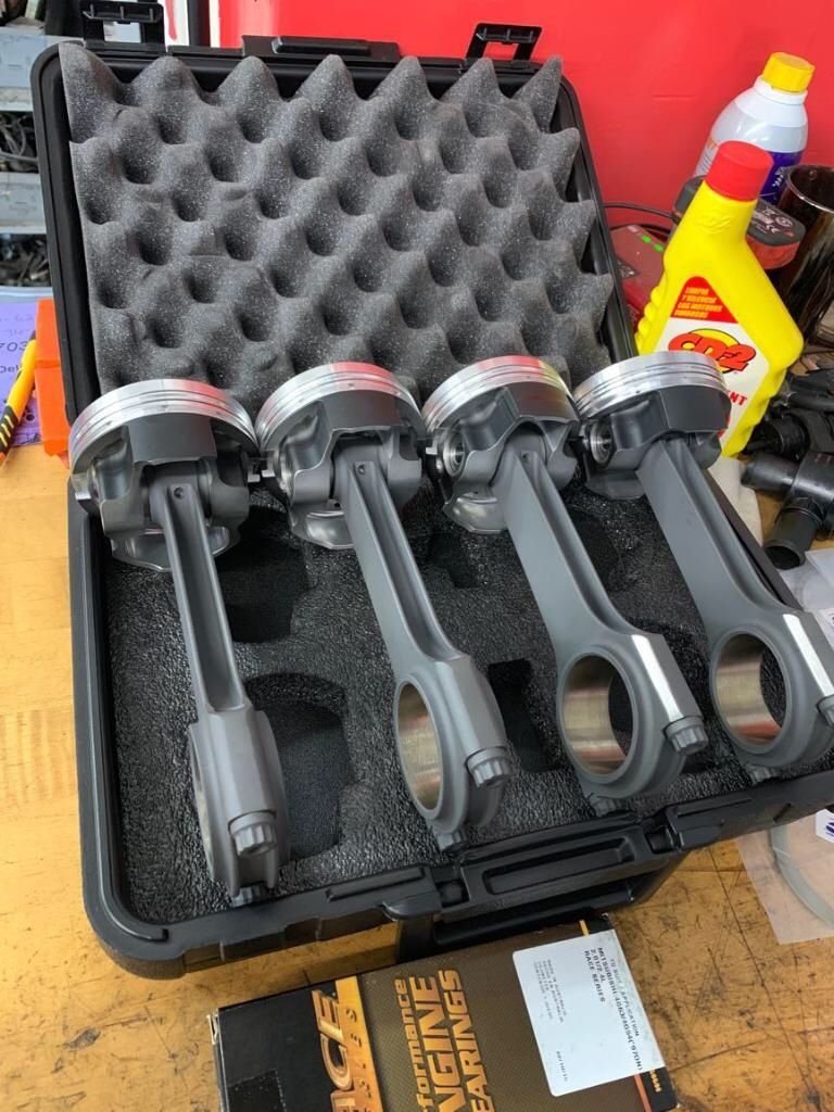

Stupid pics aren't uploading right. Here's another. Notice the oil shedding coating on the rods
One note: My engine builder thinks that the ACL balance shaft bearings are made in China. Not sure if that's true, but I certainly trust his opinion that they weren't round.
He did say the WPC treated balance shafts spun like a top when he slid them in the existing bearings in my block. But I'm gonna get some OEM ones and have them WPC treated

Well, it shouldn't add any additional time since I had to buy new main bearings since one of the shells was f-ed. Both will be at WPC at the same time and Izumi-san is great with the turnaround
My OCD won't allow me not to treat a bearing surface...especially the much-maligned balance shafts lol

I would lean towards deleting the shafts since you have an aftermarket rotating assembly. The harmonics are going to be different then a stock engine. Adding an ATI dampner would be a good idea with the big crank as well.
I'm all for Balance shafts in a stock bottom end with a rev limit close to 8000. They were intended for that type of life with those parts.
You could WPC treat the bearings before you turn them

I have a Fluidampr...one of the lighter weight aluminum ones
I have gone back and forth on the balance shafts like 5 times. I think I've settled on keeping them in. Don't plan on revving much beyond 8000 with a 2.3 and an FP Red.
Don't mess with with my head Abacus
BTW, I value your input so thanks for sharing.

Just got the OEM BS bearings and ACL race main bearings back from WPC (one of the ones I had was messed up and ACL BS bearings weren't truly round). Engine builder should have received them yesterday.
I go in to see him for a radiator replacement (BMW's are fun when things start going bad) next week, so I hope to report more progress.

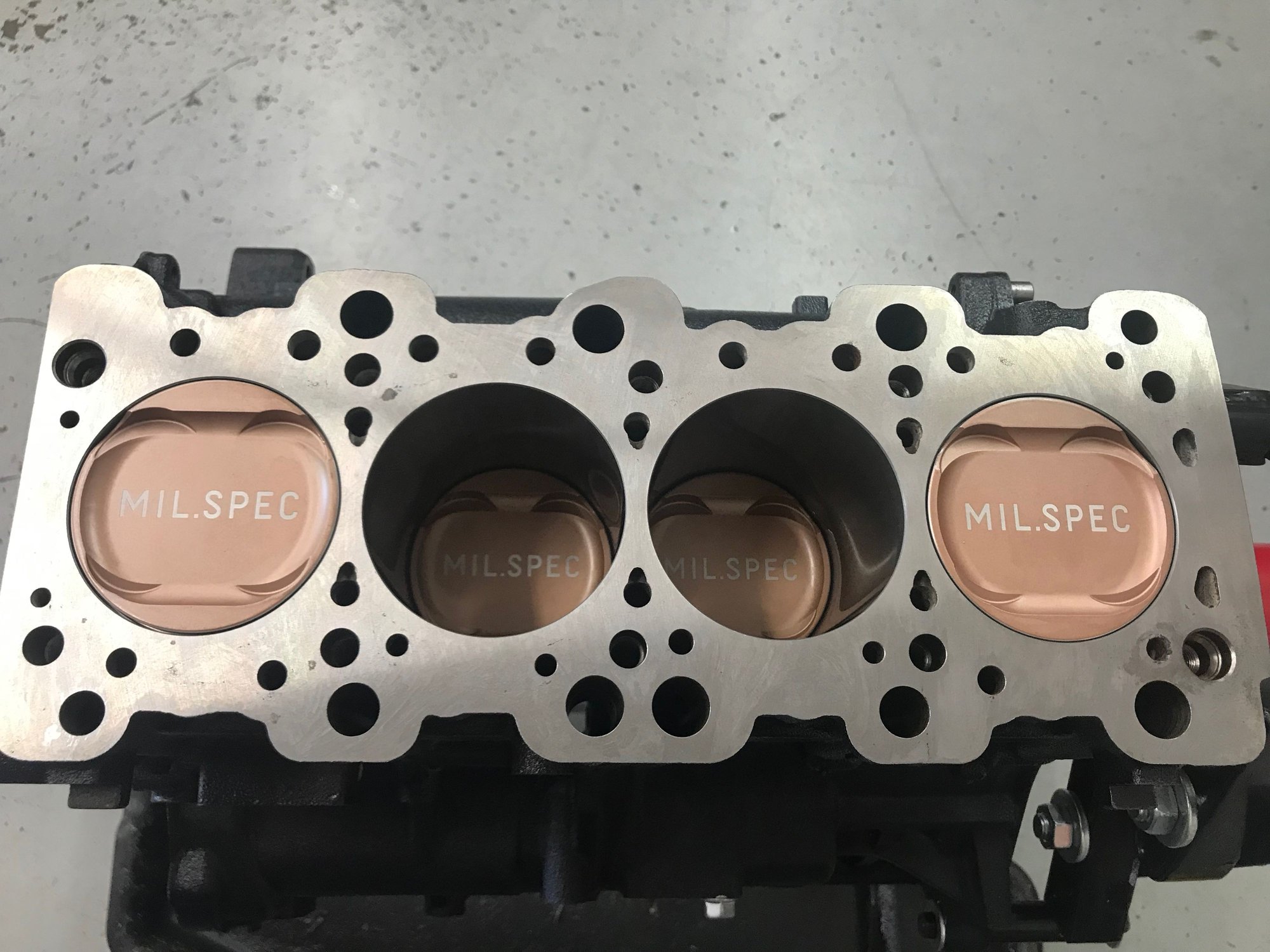

Old Aug 11, 2019 | 07:36 PM
  #270
MIL.SPEC Erik's Avatar
Joined: Jan 2019
Posts: 33
From: Santa Monica, CA
I think you need to skip the WPC and put it together...lol
Like this?
Is THAT a shortblock?
