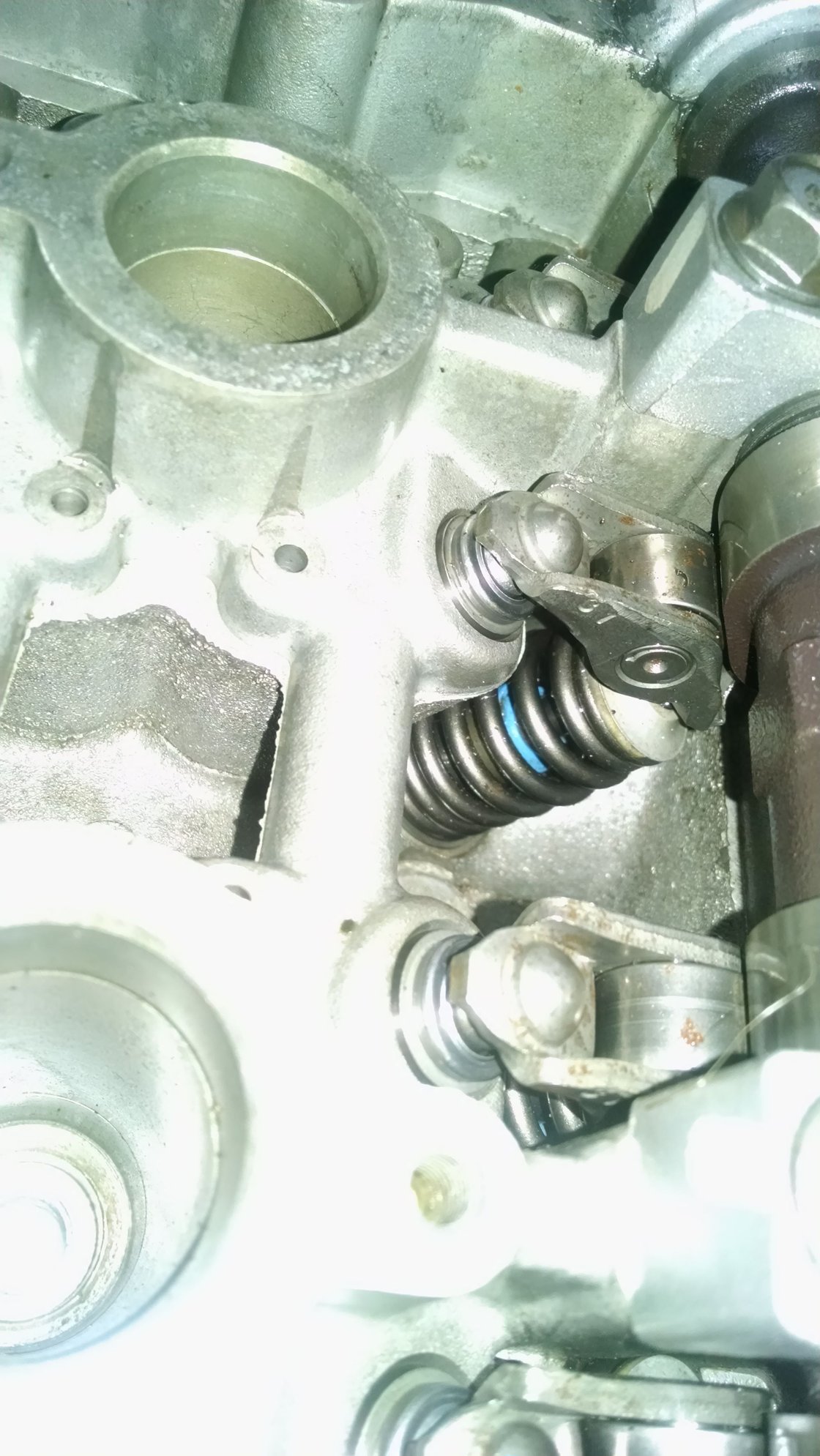

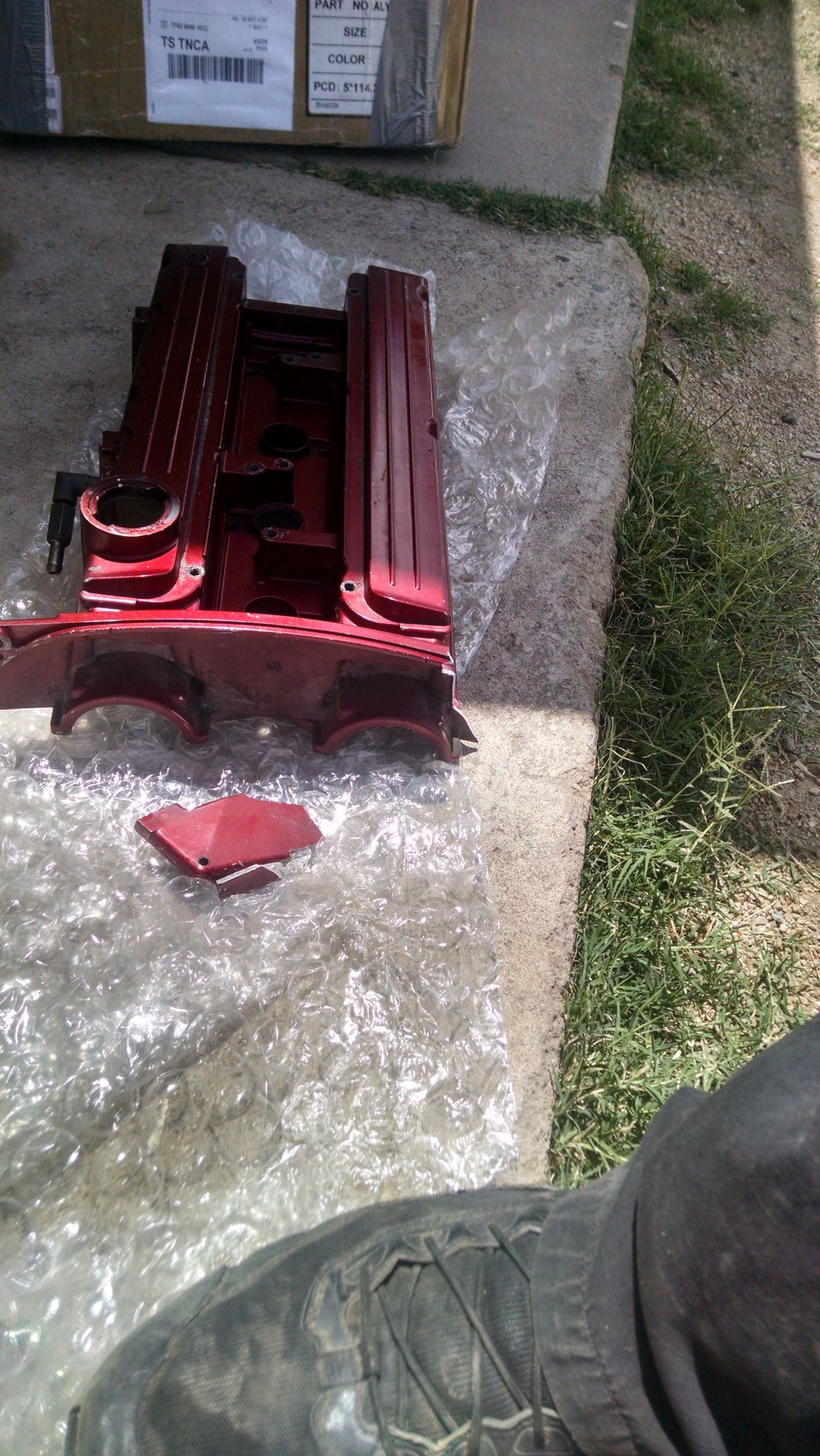

Ok so today the cylinder head came in they included a valve cover for no extra cost but it didn't survive the trip. Fed ex broke it lol At least I already have one lol. For the head I investigated it it has the hks amo3 and am 04 Stamped on it. So it's 272s now I have just get my valves I want and not these stock ones and bronze valve guides installed. Also change my cam gears. Man what a deal. I can polish this other thermostat n housing n end up either selling it or holding on to it or trade it. Overall a terric deal. Ohh I gotta swith my springs and retainers this one is stock ones glad I have the titanium ones from the other one. Just saved a great deal of extra dough due to this.
Stock springs on this one

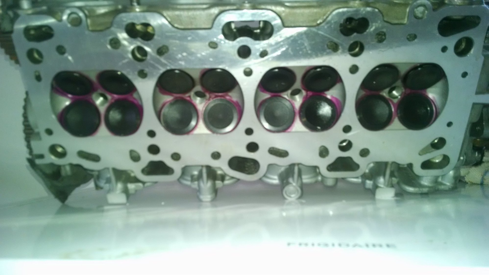

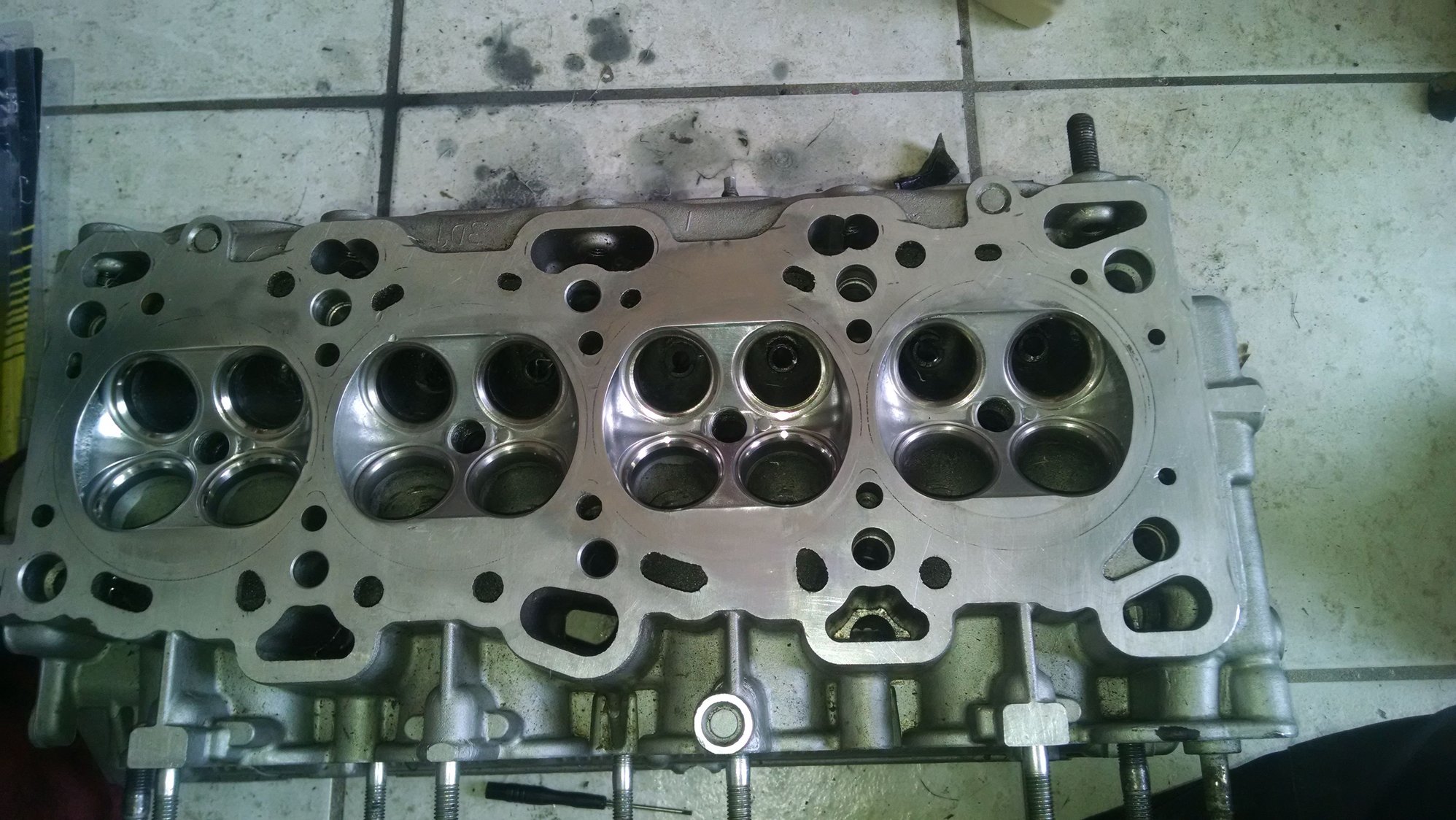

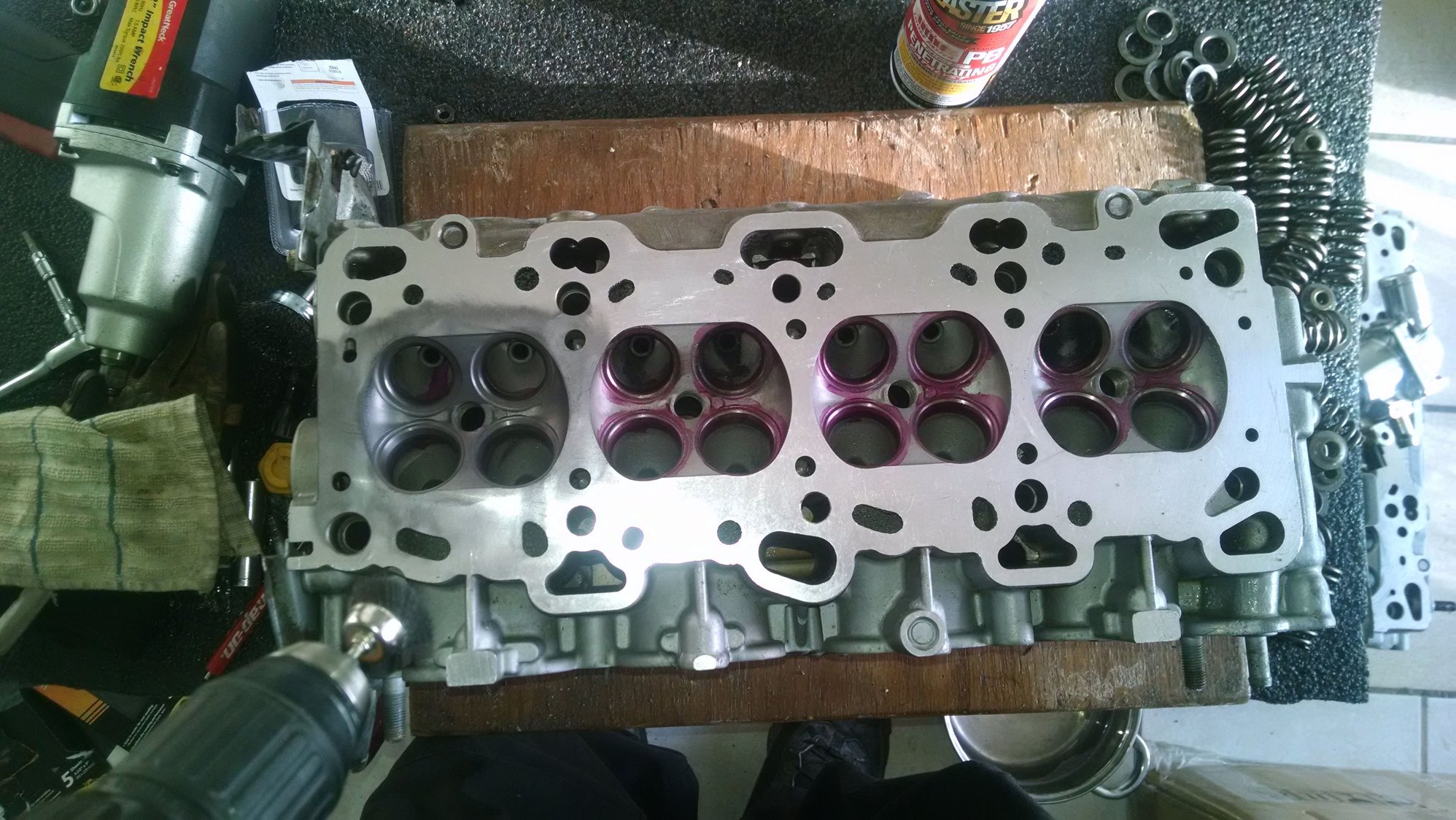

Okay so today after practicing earlier wit the old head on polishing two chamber ports I decided to tear this fresh head down. Lord n behold I find faults.they rebuild this very ****ty lol.oh well... So I have to buy the bronze valve guides standard ones and have the installed. I came across 4 stress crack valve guides in the exhaust area and the valves were regrinded.So typical issues to fix. So next month or so I'll order the ferrera 6000 STD valves n bronze valves. Then get the gsc zero tick lifters. What a process lol.
They sprayed n did nothing lol. So i decide to play n clean it.
Cleaned wait tobe polished
The trash head with two chambers practiced on.

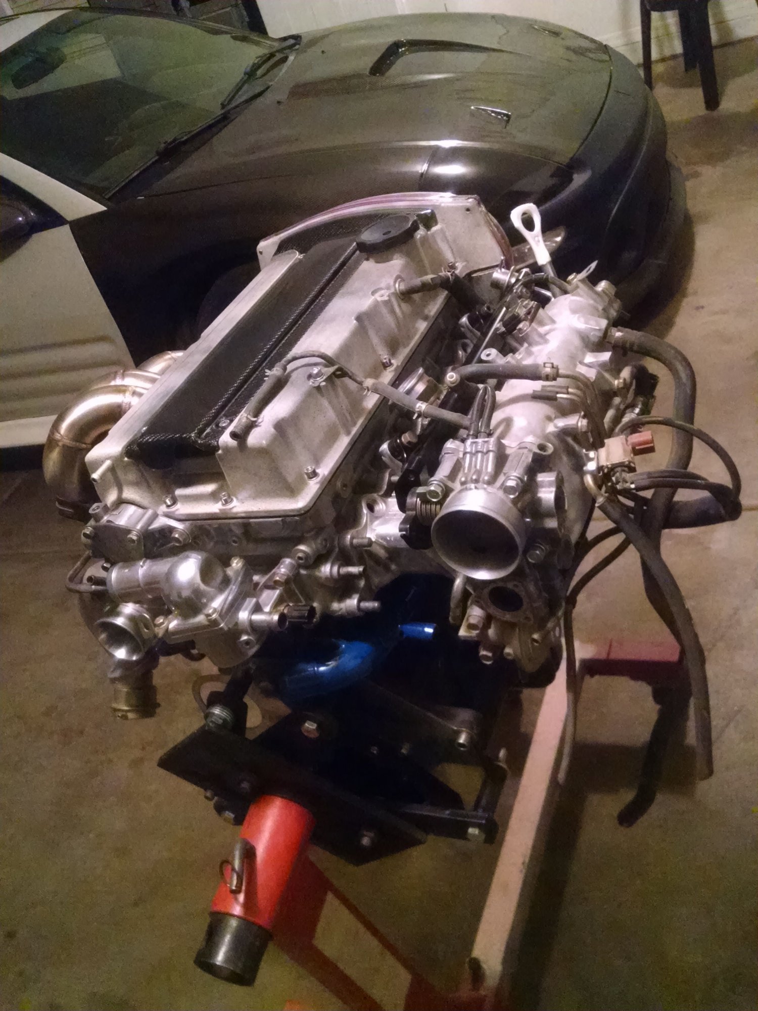

Hey what's good everyone. Sorry I been on lately. Busy with life. I can be reached Instagram as oneoff3g. Alot has been going on for me. I'm in the process of moving to abigger home with a garage to do my project n try to actually set shop for composite fabrication. Here is a picture of my turbo manifold OEM style for the evo8 setup for my eclipse with a 3" clearance from exhaust flange to the turbo flange to prevent using spacers. It's still in progress to be polished and welded.
A peek shot for now.

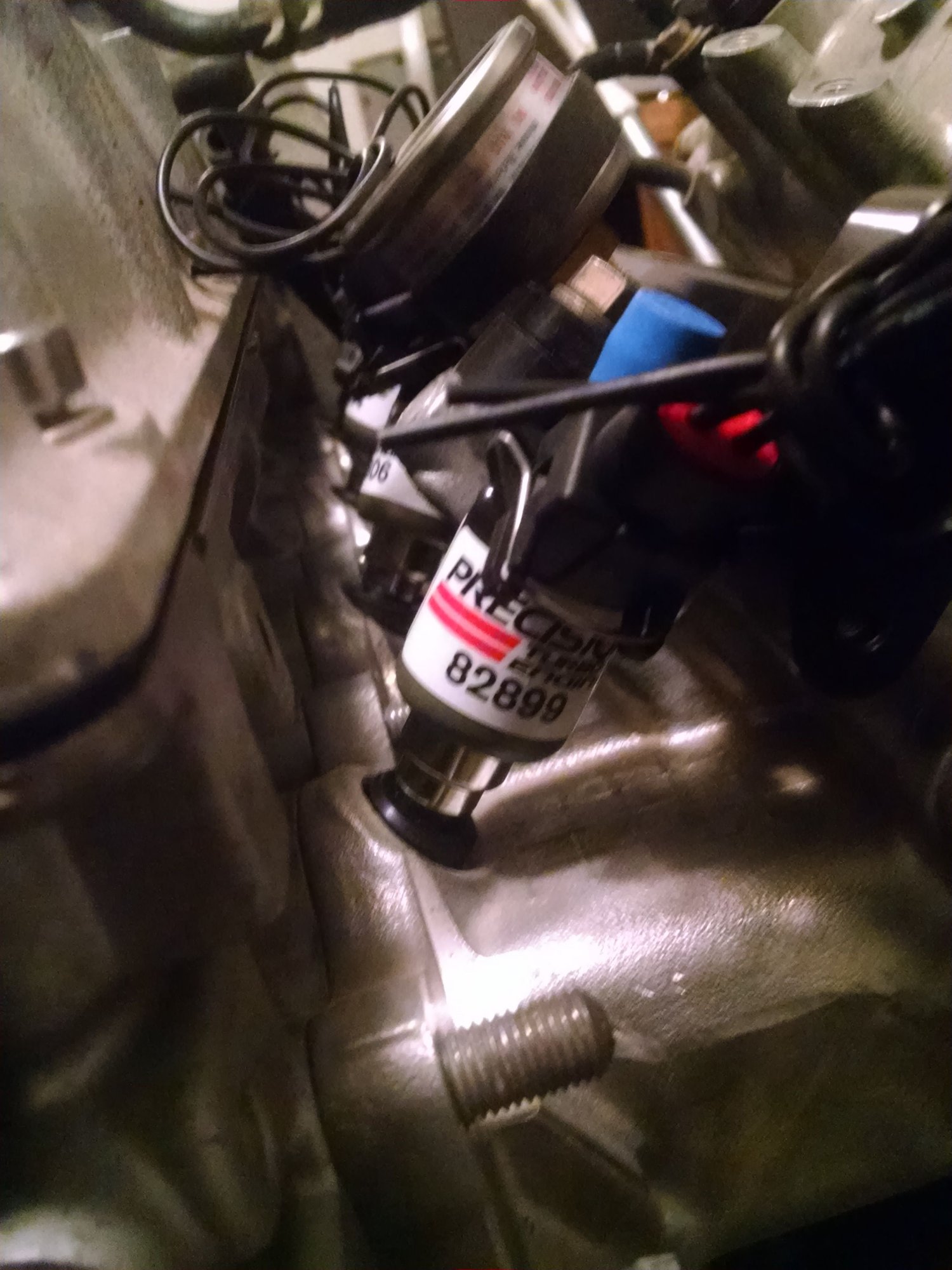

Here's the final product of my custom evo8 manifold specifically for my 4g64. The progress of tis build is slow but yet it's getting done. Tmajor custom parts left which has to wait till I get the mock-up motor set in place in the car to have my down pipe made and then get my intercooler piping. Guess I will sale my original evo8 turbo manifold cause I can't use unless I use up to 4 spacers...nooonoono. smh lol.
Half way there mock-up bottom end.
Custom manifold and turbo side.
Fuel injectors are 750cc by precision they are only on top like this for the pic only.
