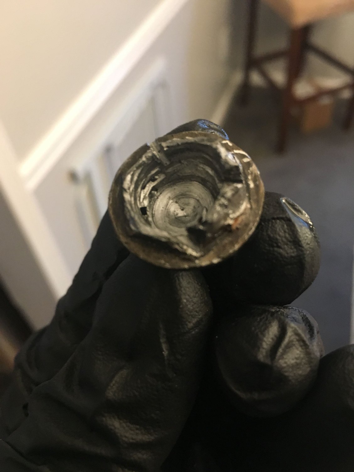

This is where I am now lol got a rounded flywheel bolt out that was a real pita to get out. The engine bay stuff is about complete now I have to Just prep block to send to Curt brown here soon for either a 2.0 built shortblock or just an Oem rebuild with arp hardware etc. not sure if I want to go down that path but I have time to figure it out.

Success!! Got the pita flywheel bolt out.. Ran out of drill bits so I used my dremel and cut into the sides and used a flat head screwdriver and a hammer, it came right out.
