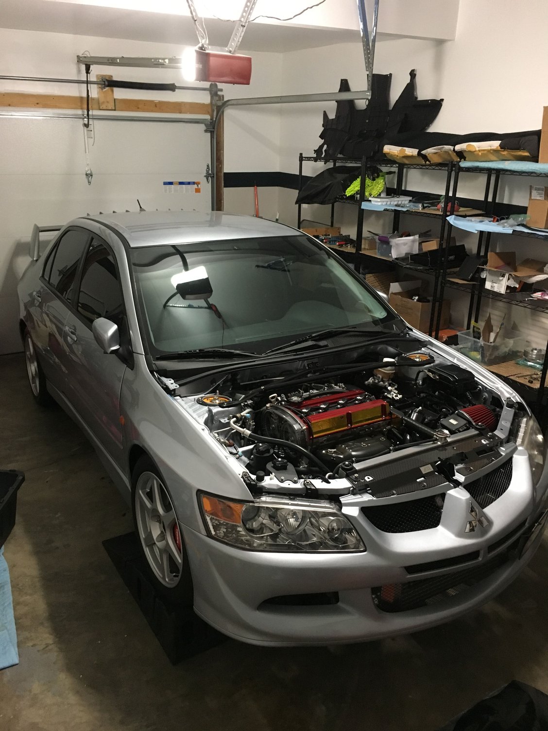

I cant even really burp the coolant or bleed it whatever because I’m not gonna let it idle for any amount of time, so sorta stuck at the moment again lol oh well, I have work and other crap going on anyways.
wheels are on and she moves on her own , so crazy..
im glad it works and turned right on but I’m sorta bummed I wanted to drive it already...
