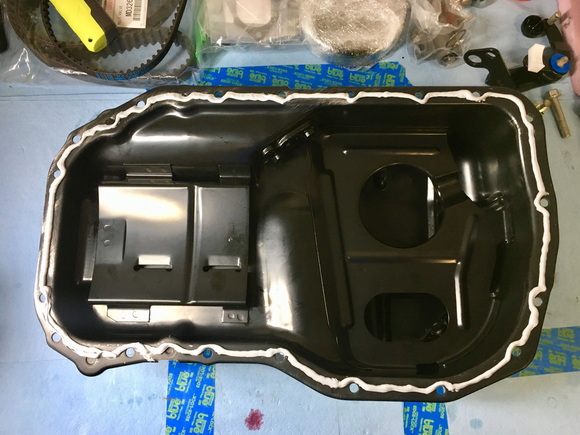

sealed up the pan with mitsu bond and got a few parts back from powder coating, couldn’t resist the install..

Well I wasn’t happy with the oil pan seal I did so I re-did it and feel much about this time.

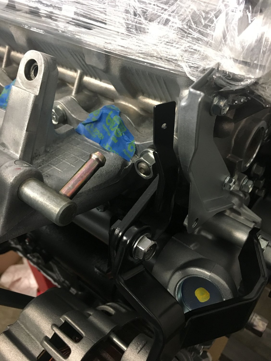

More progress
STM pulley, new alternator, powder coated goodness
More powder coated stuff
Mil spec 65 mm TB Curt Brown 65mm ported IM Nice to have these parts out of storage and back where they belong

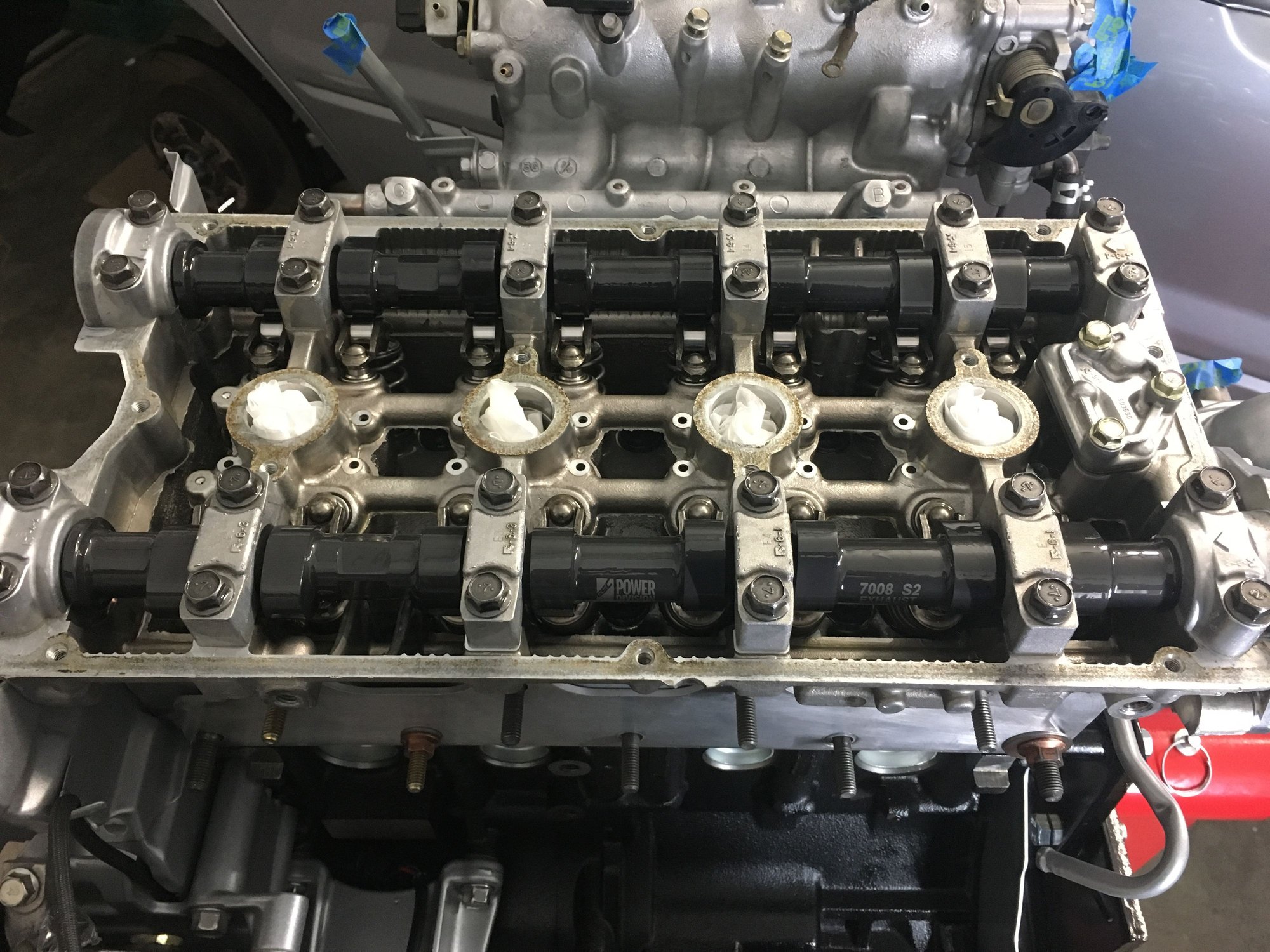

Gsc zero tick lifters installed and bled.
I soaked them in diesel for a week then bled them and let them soak in a new container for another week. Then pulled them out bled them and soaked them in oil for 3 weeks lol , bled them again and installed squishy.

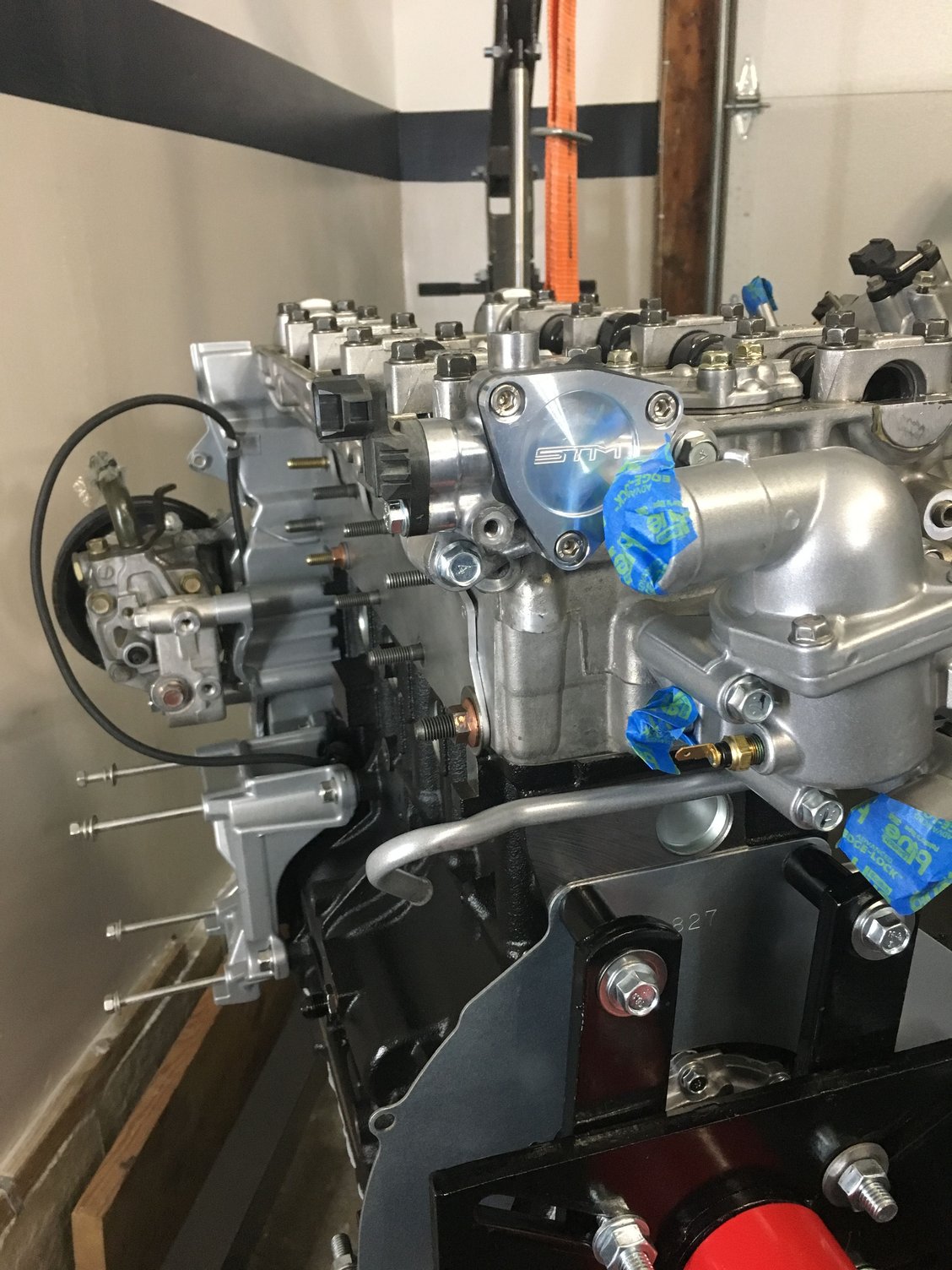

Removed the OFH plug so I can install my oil pressure gauge. Here’s some pics and before I install the stm remote kit for this, is there a torque spec for the plugs on the OFH where the kit bolts to? Thanks in advanced..
Heated this sucker to around 200 degrees and it came right out

Likes: 26
From: Bel Air Maryland
I used the 3m silicone that is recommended and torqued back of block fitting to the 19 +- 3nm and torqued the OFH housing to 10nm. Seemed to go it the same amount the plug was in. I saw that number on a dsm OFH after all day of searching.

Little update.. motor is assembled and timed, pin moves freely and I turned it over a bunch of times it’s good as far as I can tell and everything lines up, this was a major accomplishment for me ,Here’s some pics!
