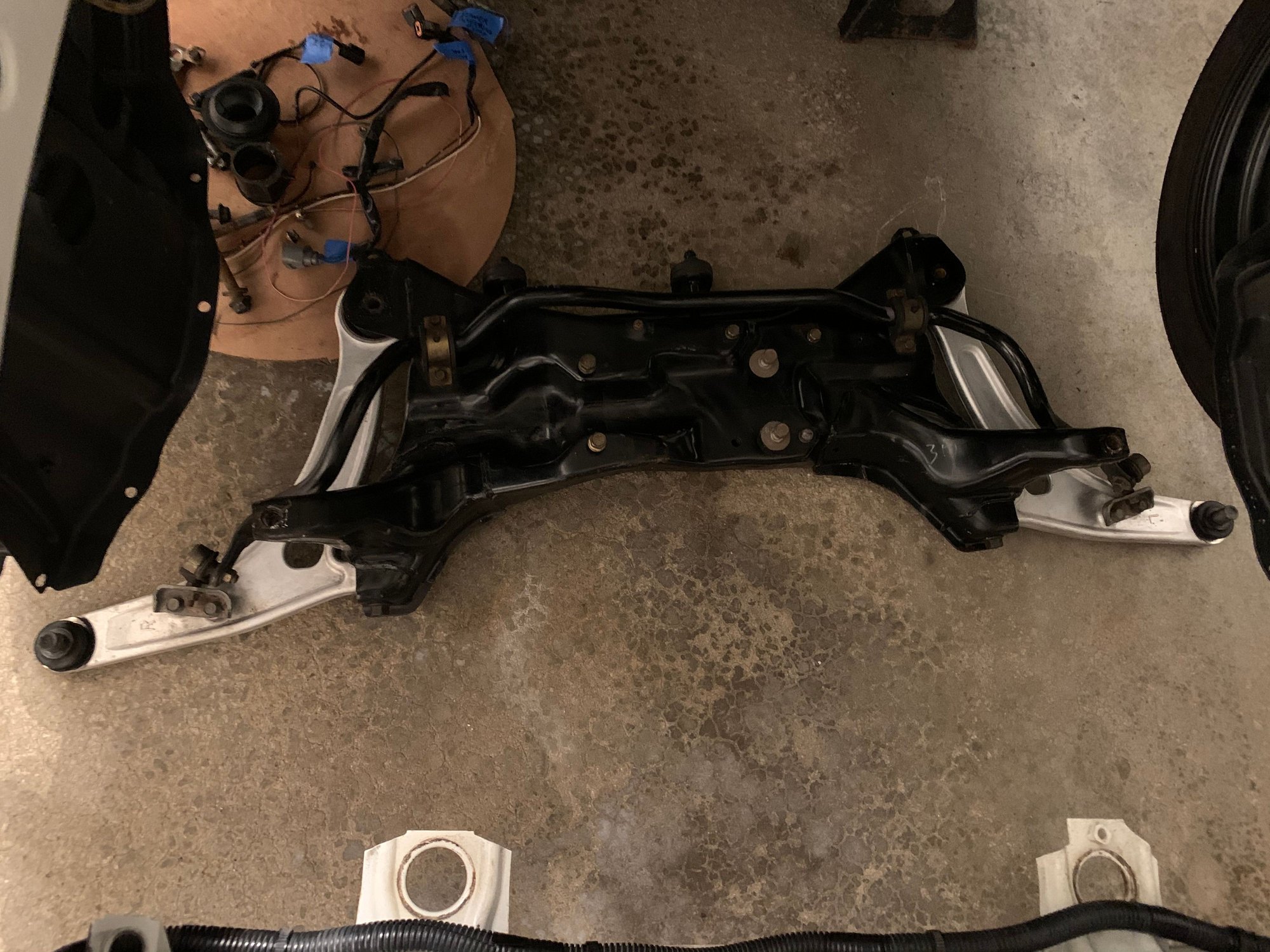

In the mean time, I decided to drop the subframe . The ball joints seem ok , but do you guys feel it’s worth upgrading to whiteline ?

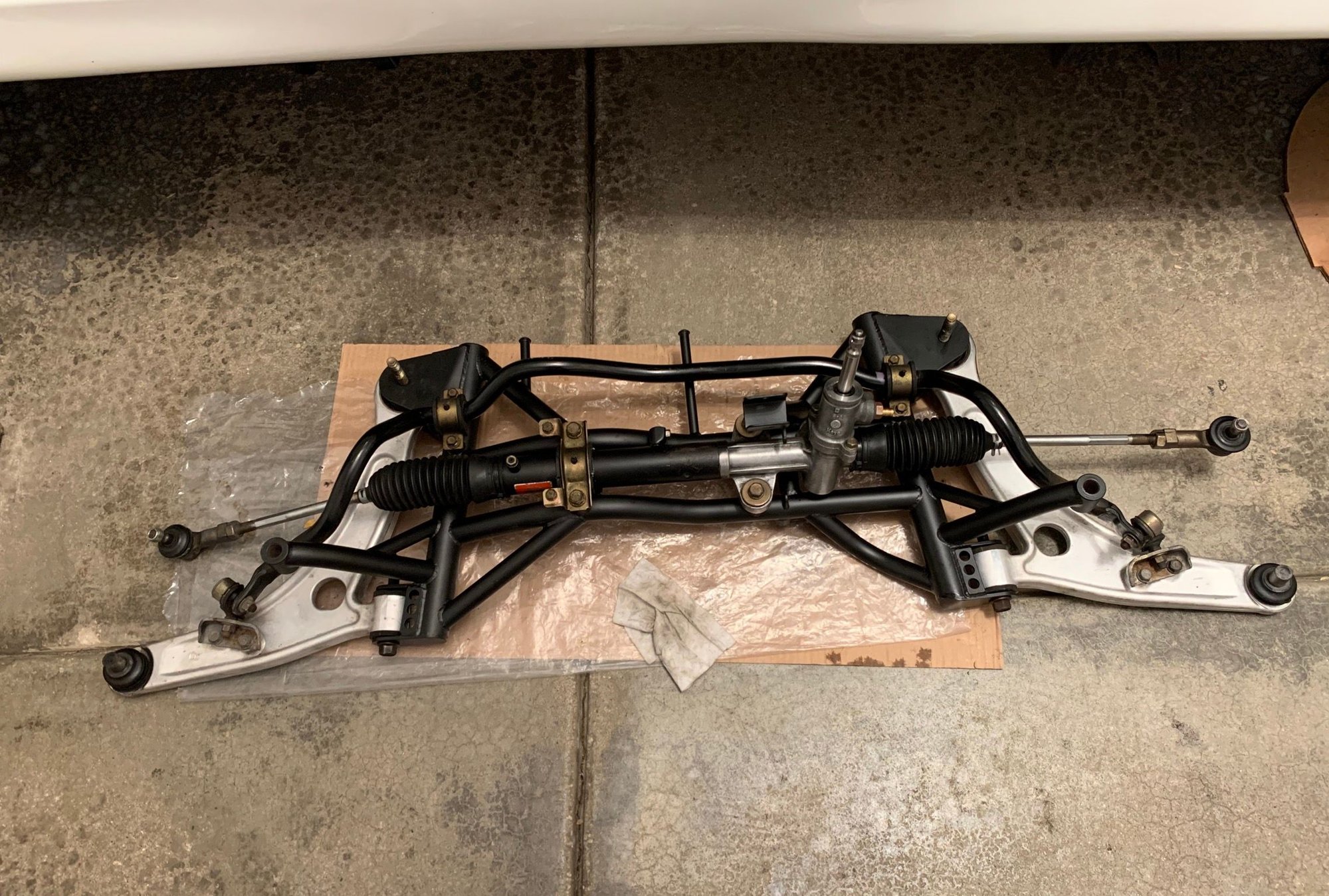

Today the DRC subframe came in. I asked to keep everything as factory except the exhaust hangers are not needed.
Well, the one I received has factory hangers and also it seems like the transmission mount bracket is integrated. I’m not sure if this is a design revision of some sort but most other pics I’ve seen do not have this. So now I have a subframe that has two pieces that I absolutely do not need (exhaust hangers and integrated trans mount bracket). Also, why no brand sticker ?

Alrighty , I spoke with Dan and he said that the subframes were revised a little while back and come with the “integrated” bracket for the transmission mount. I was not aware of that and just assumed it would come as factory setup is. So anyone looking for subframe , keep that in mind.
As for the exhaust hangers it was an error on their part for including it . It’s not the end of the world, but it would have been better without those pieces , especially the trans mount bracket. So I’ll just use it as is and post some pics as soon as I have some time to install it.

Had a little time time to transfer over the goodies (control arm, sway bar and steering shaft ).

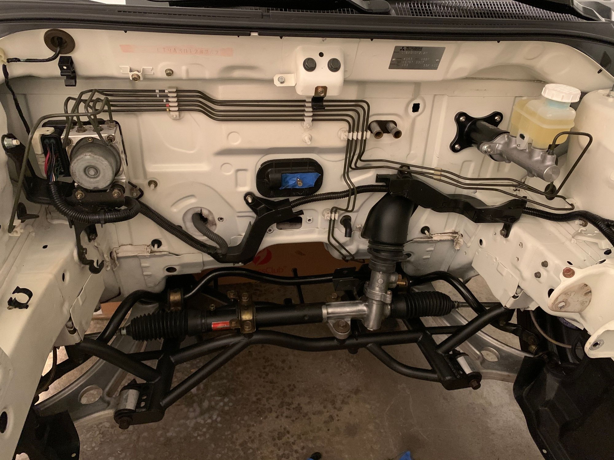

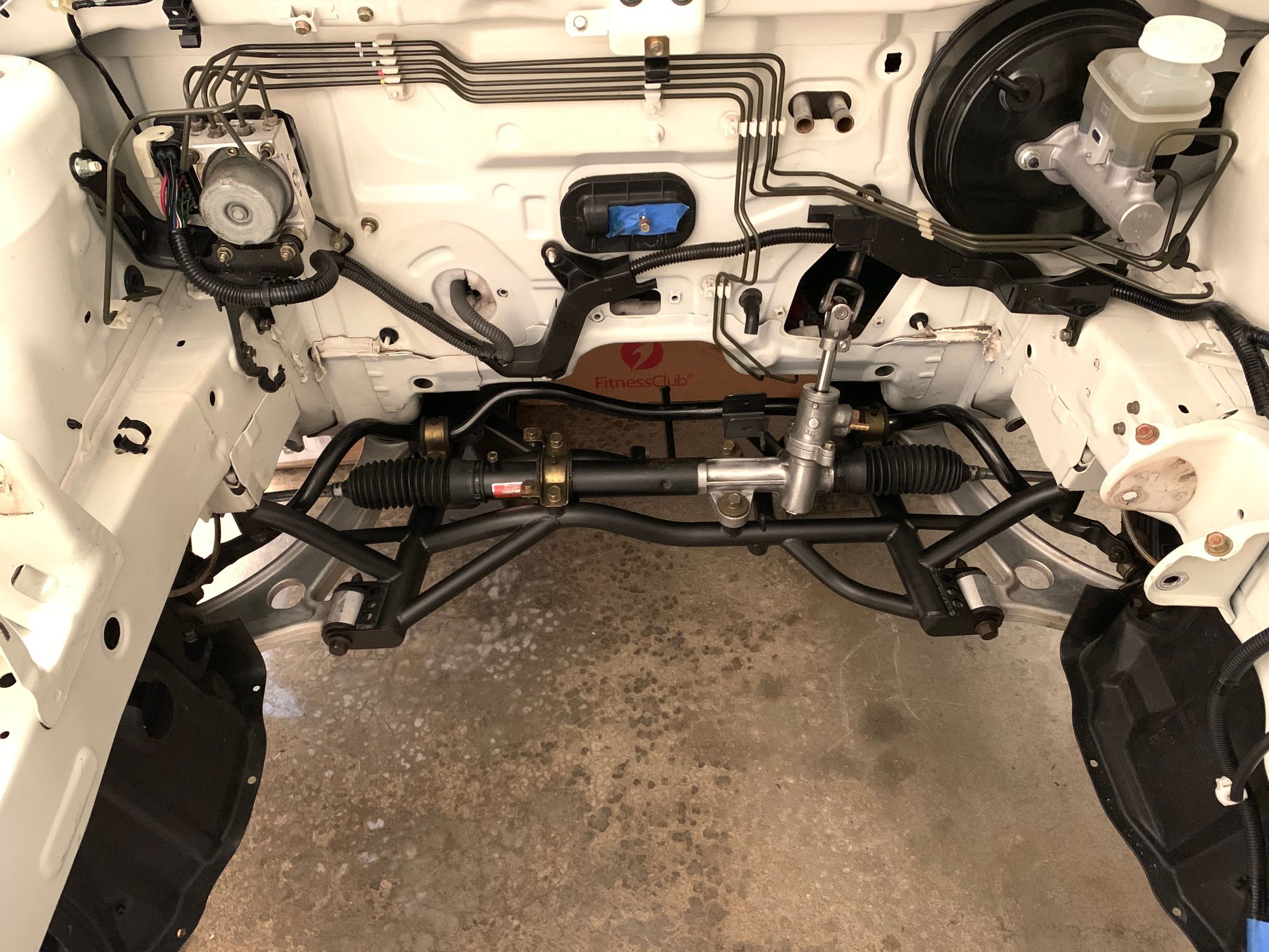

Subframe is on the car. When I was disassembling the steering rack , I used brakeklean to degrease and clean things up . Well I also cleaned off the sharpie marks I put to help align the steering. So the install process took a little longer as I tried to eye ball both tires and center the steering wheel and repeat till I think it’s all straight now.
Comparing my manual steering to power steering (both with car on jack stands) the steering is super light ! With the power rack you still felt a good amount of resistance as there was a internal piston ring trying to push fluid through small chambers... of course I won’t know the full capacity until it’s back in the ground or when driving .

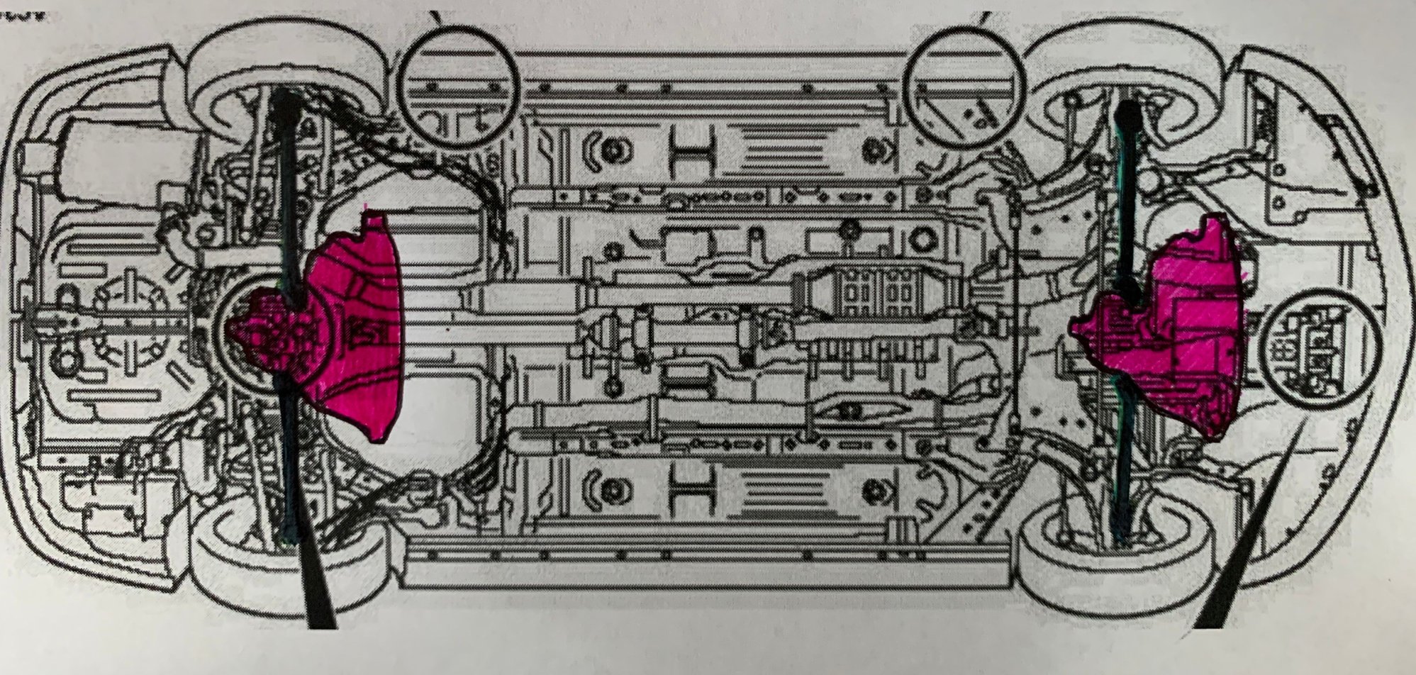

As I slowly inch forward in this build I’ve redirected my choice of power unit once again. The model s rear drive unit can be bought with power output ranges of 450 - 630 hp (335-475 kw) . But the downside is they are oriented in such that the inverted and motor are at the rear with the transmission axles towards the front of the car. I need the motor to be installed in the opposite configuration to clear the rear subframe .
I’ve decided to use the Model 3 Drive Units instead of the model s . The model 3 rear drive unit is rated at 283 hp but weights 100 lbs less (300lbs model s vs a little less than 200 lbs model 3) . I will be installing a “rear drive unit” in the rear and another “rear drive unit” in the front independent of each other. This should put me at 560 awhp , which is way different than what a 560 awhp internal combustion engine dyno power band looks like. The all wheel drive version of the model 3 has less powerful motor at the front and puts out about 483 awhp. Weighing in at 4,072 lbs the Tesla Model 3 awd performance package sprints 0-60 in 3.2 seconds. With all said and done , my Evo should weight 3200 lbs if not less. So I think I will still be happy with the acceleration.
I tried to scale the sizes as best as I could calculate but here is what the motors should look like installed .

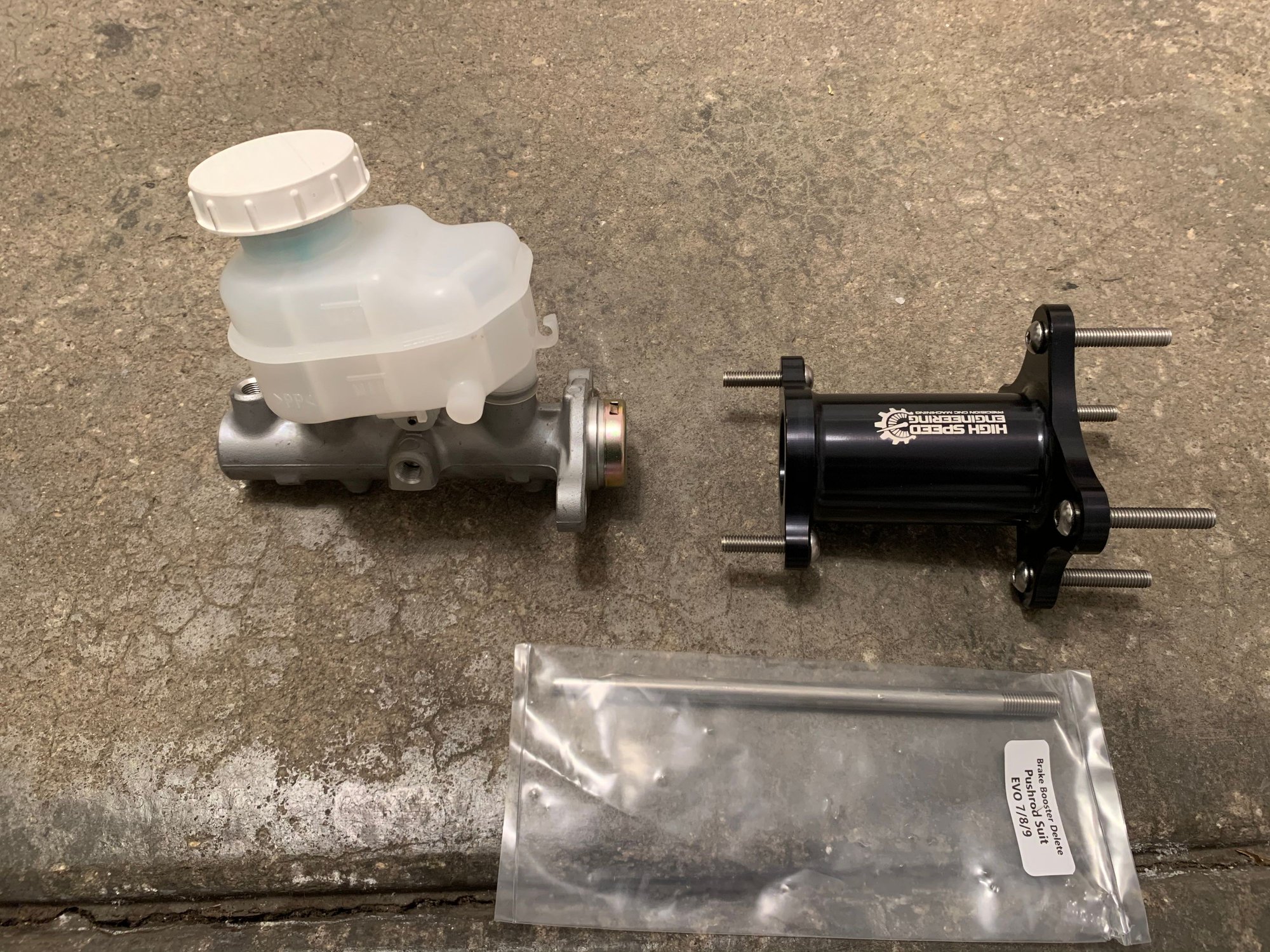

I want to keep the ABS and simplify everything. So my options were to either add a vacuum pump or delete the brake booster. So big thanks to this thread I was able to find what I needed to make a working manual boosterless brake MC https://www.evolutionm.net/forums/we...l#post11892490
Today the last piece of my birthday present arrived. Its a 7/8” Master Cylinder made by “Centric” part number 130.46522 .This will help reduce heavy pedal feel when removing the brake booster. I also got the High Speed Engineering Brake Booster Delete to help delete the Brake Booster while keeping the MC in the standard position. The Ebay add description stated it was anodized red but I was actually pleasantly surprised it was anodized black.
Its kind of cold now and finding the time to work on the car is not making it easy. So I’ll install it when I get the chance and take some pics installed.

I was able to squeeze in some time to install the brake booster delete and 7/8” master cylinder . I didn’t have a chance to bleed the system yet so I can’t comment quite yet on how it feels depressing the pedal while stationary .
I had to re-use the oem u- joint that screws on to the push rod to attach to the brake pedal. Something was off on the push rod thread. The pitch seemed fine but the u-joint piece would not bolt on. So I used my cheap tap and die kit to chase the push rod threads. It’s supposed to be m10x1.25 but I think it was slightly thicker that was causing the issue .
