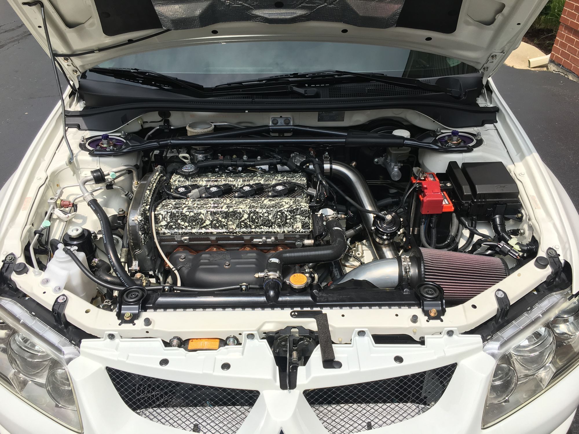

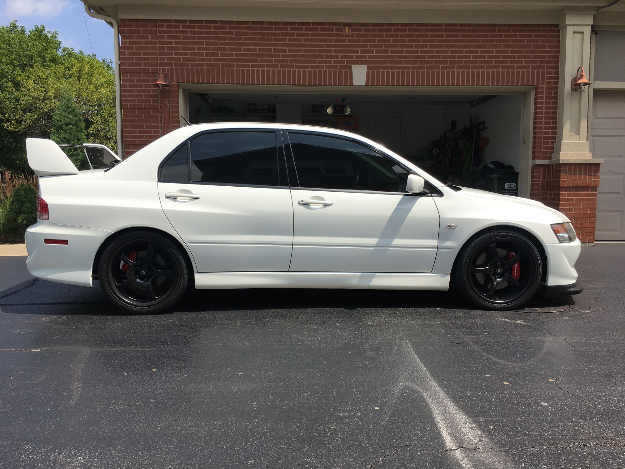

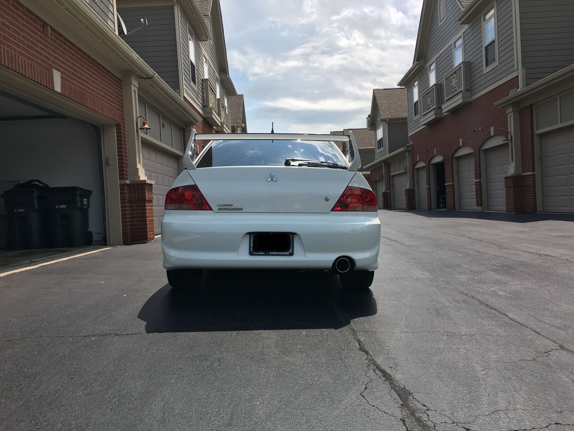

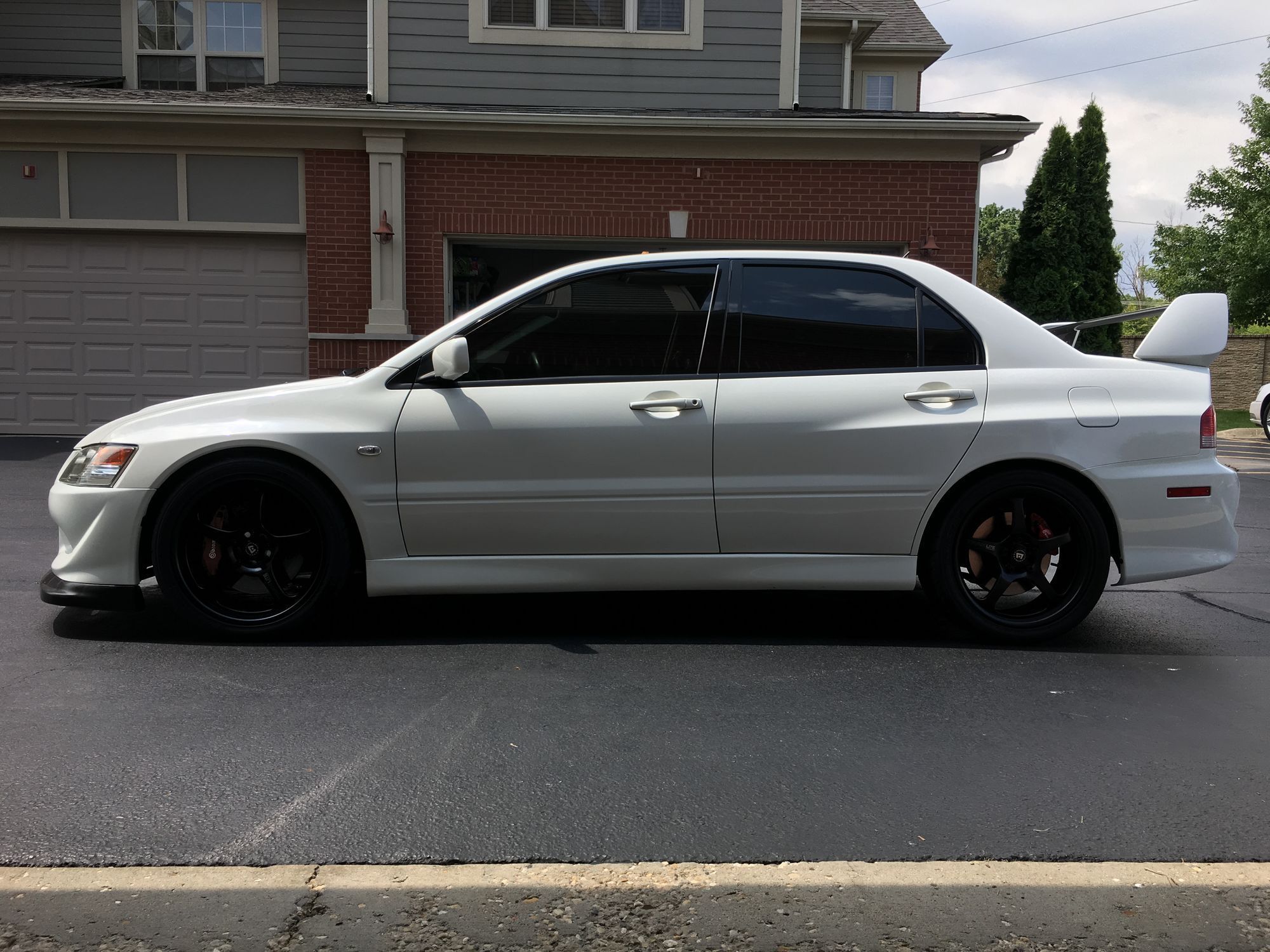

Here is my car (2003 Evo) when it was all together. I was making 560 whp on stock block with FP Black, cams and supporting mods. Does it show that the body had 96k miles?

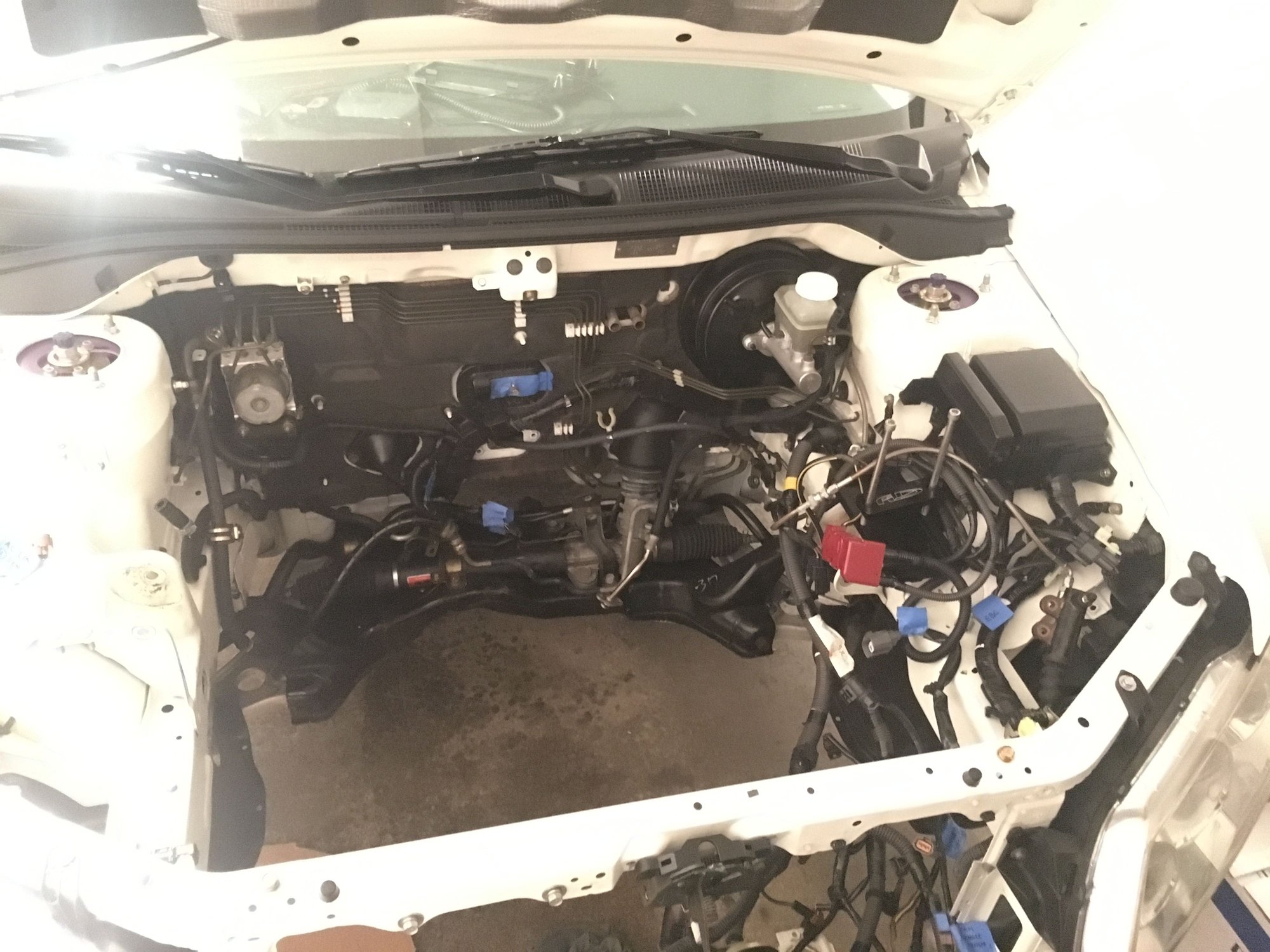

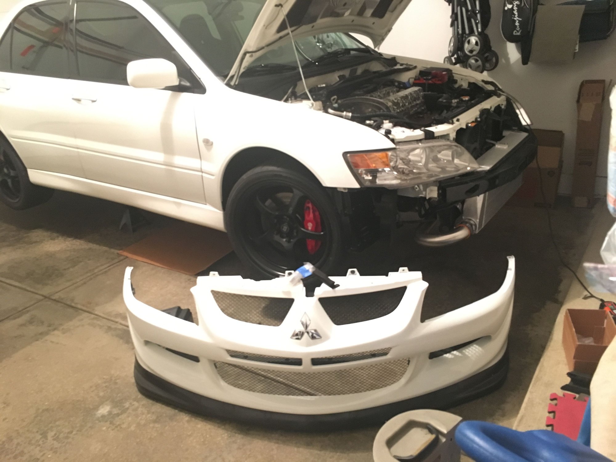

Well, with what I’m doing I won’t be needing a lot of the Evo parts. The Powertrain, drivetrain and most all supporting parts have been removed and sold.

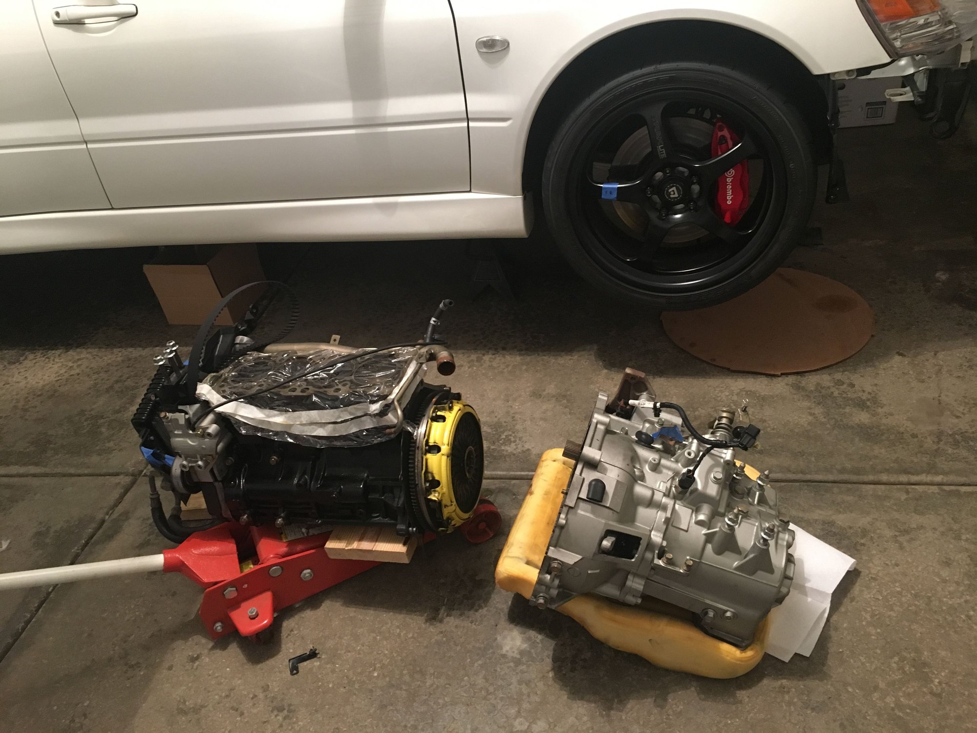

I dropped the motor and transmission together from the bottom. I dont don’t have an engine hoist, so I removed the oil pan, oil pick up tube and oil scraper to use my floor jack with a flat wood piece as support. My car is pretty high off the ground so it was not as hard as I thought . I did remove the passenger wheel to allow a little more room.

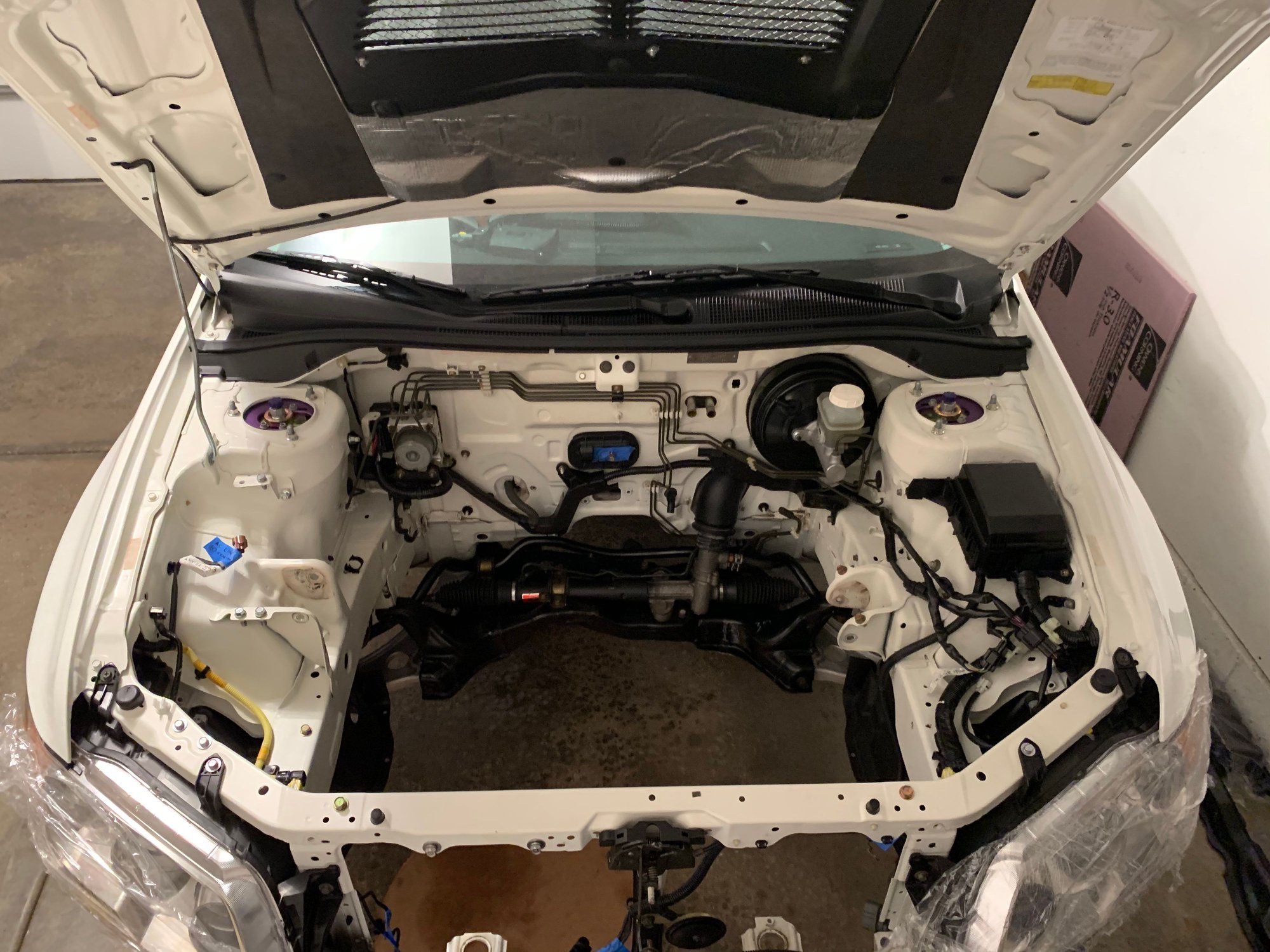

The empty engine bay. I’ll have to do some cleanup and remove engine harness wiring I won’t need and some additional things.

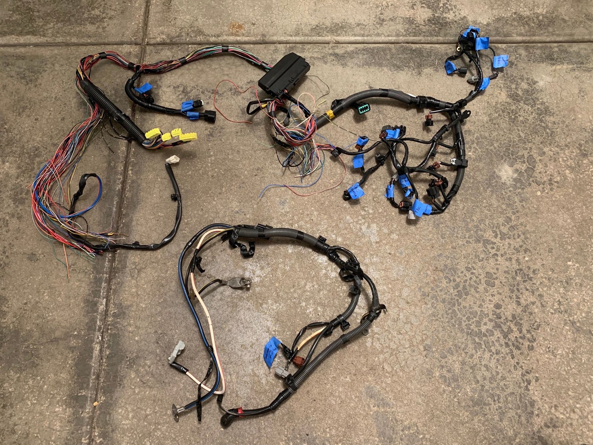

I’ve been watching some of the builds people do here, the show and shine section, wire tucks , tv shows like JDM Legends etc.. all the more I want a cleaner engine bay look. So I removed the firewall matt. The firewall behind it was a little dirtier than expected and some of it looked like mold. Perhaps the moisture of the years? But baby wipes did a pretty good job. The secret is out, I clean my engine bay with baby wipes
I plan to keep my ABS, however I will no longer will be needing the engine ECU. So with the help from you guys here and a little online searching of how the ABS works in general , I found that the ABS doesn’t communicate with the ECU. Unfortunately the wiring for the ABS computer is part of the ECU harness. So I separated and cut away what was not needed and kept the ABS lines portion. If anyone cares the below wires removed weighed about 8 lbs.

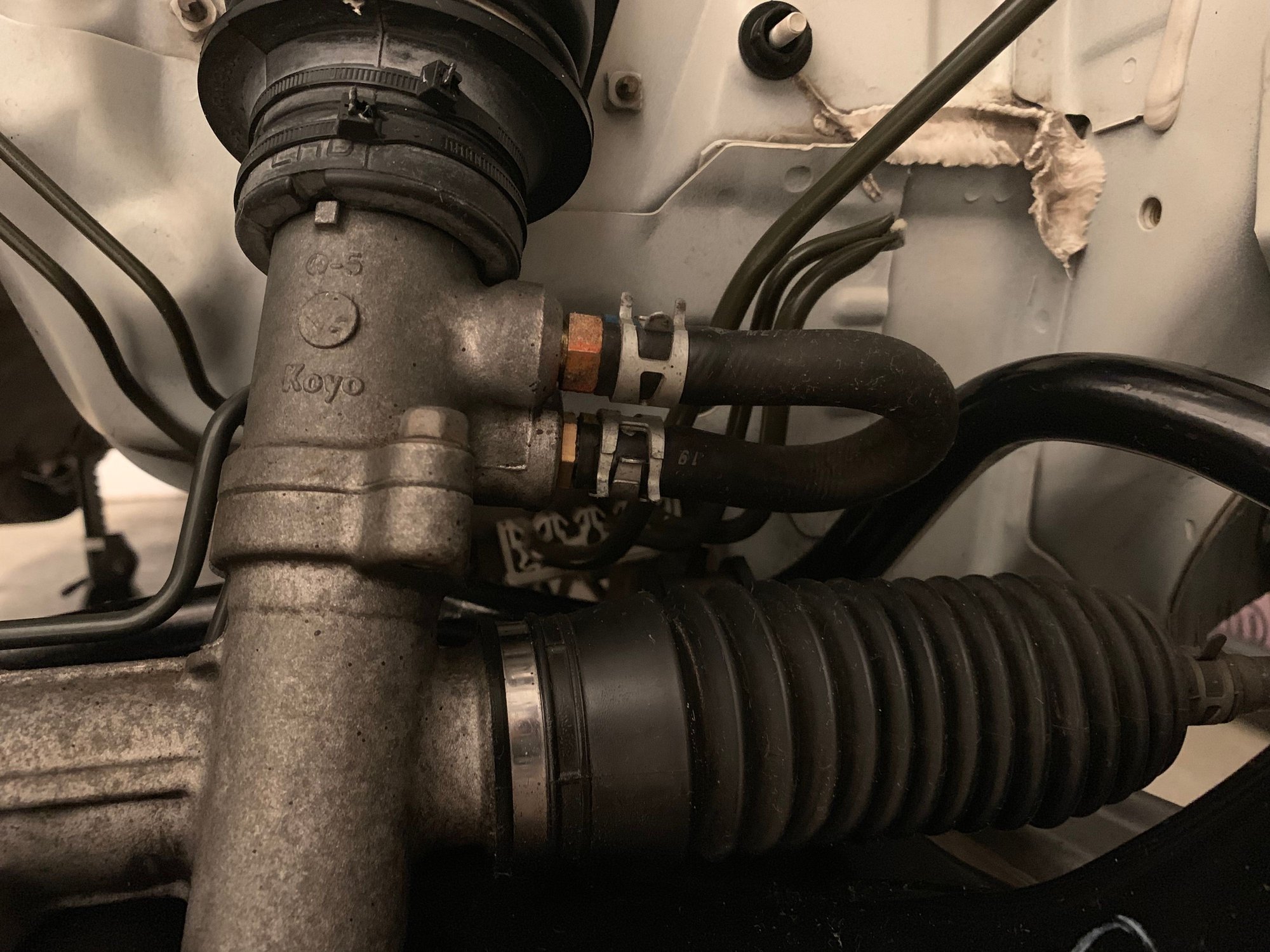

As for the steering rack lines. I removed the oem lines and installed a barb fitting so I can just use a ~ 3/8 hose and loop the feed and return portions on the rack. I’m not sure what I’ll do about power steering , go electric or no ps... That will be after its drive-able. I remember with my old blue evo 9 (hence my user name) I deleted the ps and it was a big mistake. I quickly put it back on as it was literally not drive-able, unless you just want to go straight. I know the Evo’s fast rack makes the steering heavier but even when in motion it was equally bad.
Now I wonder if the ps delete I used also made it worse? The delete (I think was AMS) had a fitting to bolt on to the existing lines to loop the feed/return . But the oem feed line portion connecting to the ps pump has a pretty small aperture for the fluid to pass. Maybe this was enough for high pressure fluid operation but restrictive for low or no pressure ? Therefore I think without ps when turning the wheel and having the ps fluid try to squeeze through created additional resistance when. I’ll find out after this build is done if my assumption is correct and the 3/8 fitting did the trick.
There are still a few more things to tidy up under the hood like removing fuel/emissions hard lines and some additional wires to remove. But its looking much better now .
Fwiw, when we used to depower Miata racks we ran into the same issue. It felt like absolute dog**** because the fluid was still damping the steering, but without any power assist. We ended up just welding the rack to make it solid. Not sure how this applies to Evos, but I think your theory is a valid one.
Thanks for the info. Perhaps I’ll drain out the ps fluid as I think I hear it moving about and possibly creating a little resistance ? Maybe leave just a tad to keep things lubricated internally ...
I started to do a little searching and found a Miata forum/thread discussing a little about ps deletions they do.
1. Loop the lines and leave the fluid in the rack - heavier feel, keeps insides lubricated, but you're pushing around the fluid. Works fine and has worked for many people on track and off.
2. Empty the fluid and leave the lines open, insides unchanged. - Works fine, but no internal lubrication method means it might get sticky and more frictiony over time. I did this by accident after doing #1 and having the loop line line come loose.
3. Open up the whole thing and cut the hydraulic collar off the shaft - Works freakin' awesome. So little resistance that when the car's on jack stands the front wheels will pivot with a bump or light touch. I used heavy grease on the insides to keep everything lubricated. This also gives you a nice opportunity to clean and lubricate EVERYTHING since it will all be apart anyway. Now that I've done it this way, I wouldn't do it any other way as a permanent solution.
