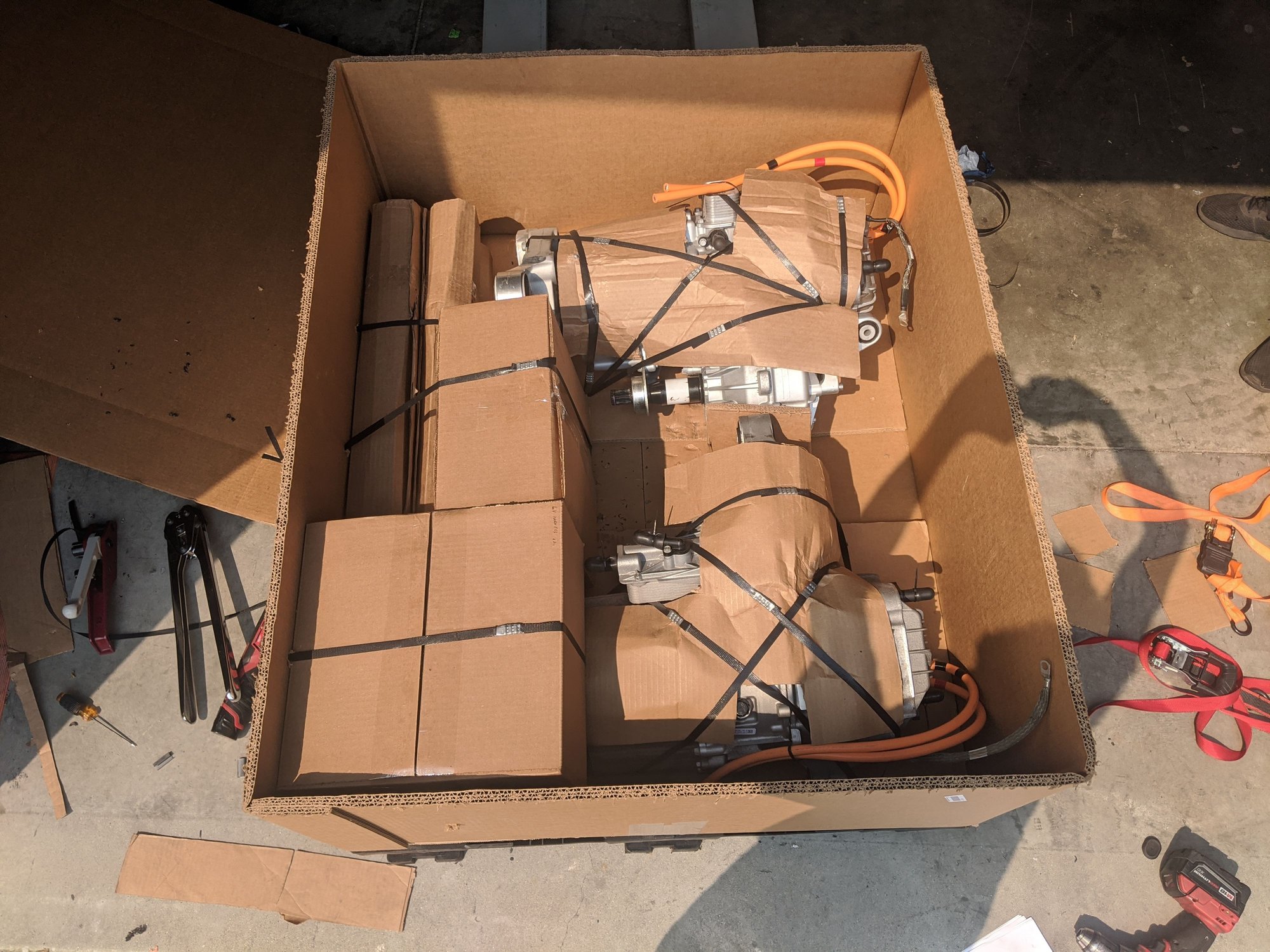

Very excited to share the drive units are on there way .
Here is a pic of it all packaged up before the freight pick up from StealthEV. More to come.

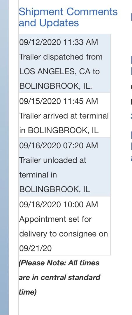

Sh*t!!!!!
think they might have lost a 500+ lbs shipment !!! I just spoke with the freight company and they are contacting the dock/terminal to double check. I’ll update you guys if it gets found or lost claim needs to be filed .

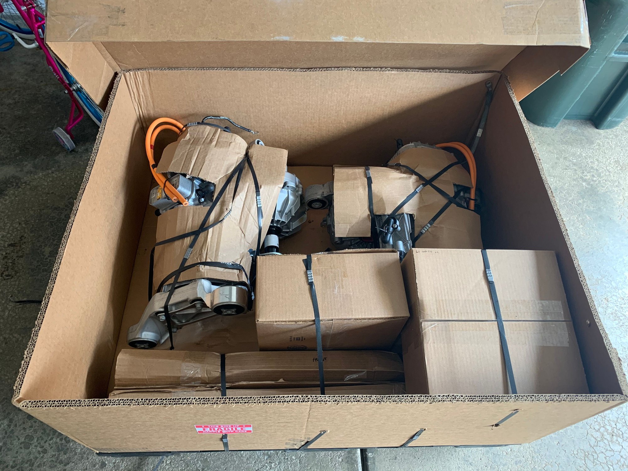

After close to 2 weeks the freight company found the package and delivered it today.
I haven’t had the chance to go through it as I’m currently working . But at brief glance it seems good and undamaged .
Motors Arrived

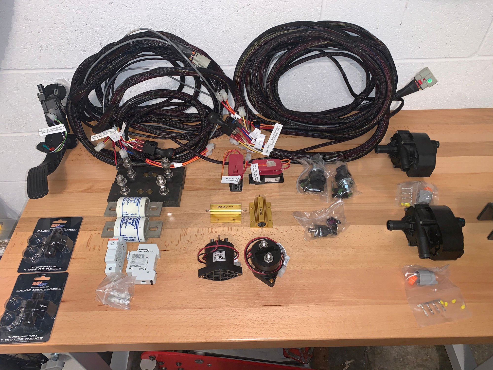

I also got hooked up with Tesla axles , still boxed up . Later on I’ll have to figure out how to get them cut and splined on one end to slip in the Evo’s cv . Strange Engineering company is only a few blocks away from my house . I’ll have to visit them later to see if they can modify my axles .
All laid out on the table. Wire harness, fuses, contactors, resistors, water pumps etc.. They all came labeled to help me/buyers with installation. These will have to wait. I’m going to concentrate on the motors/drive units first then work on the electrical stuff.

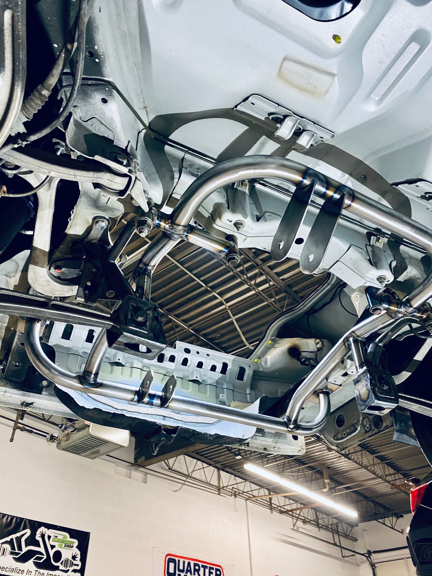

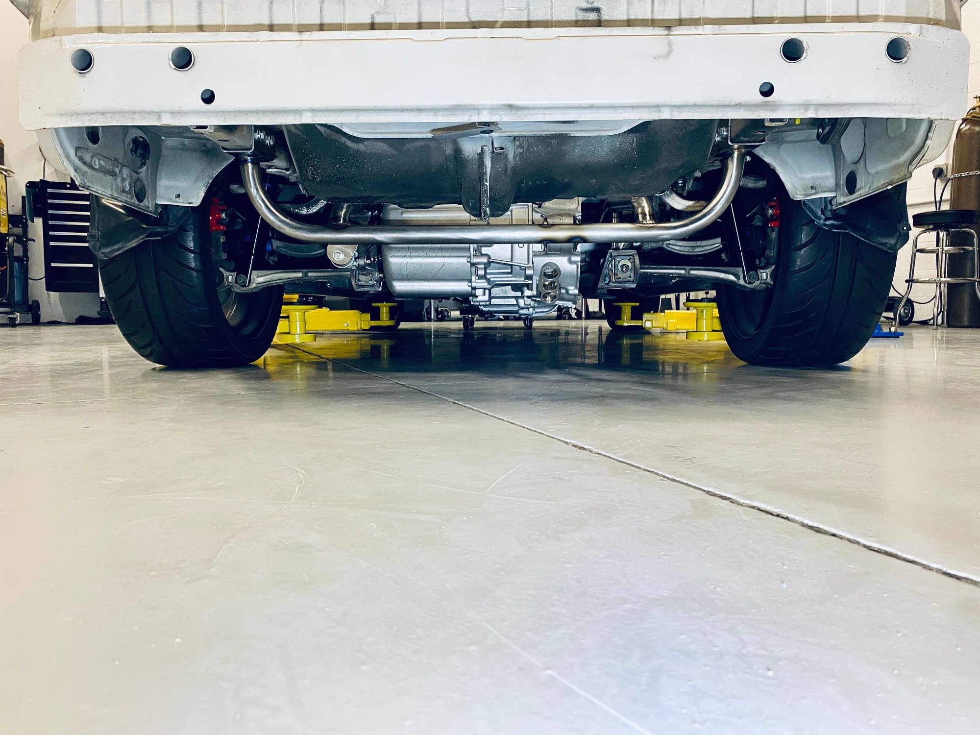

Rear drive unit mounting is nearing completion just needs some reinforcement around the brackets.
My car is lowered from stock height. And as it sits, the lowest part is about the same clearance from the ground if not more as if i had an exhaust.

Video of how the rear subframe was coming together .
Ben is making this subframe so that it can be offered as a “bolt on” solution for anyone interested in converting. Obviously you will need to cutout the trunk spare tire floor.
