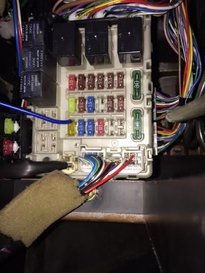

if you could snap a pic of each connector on the drivers side, that would be wicked (L)
Originally Posted by Kevin.
I'll go check my car. I had removed an alarm and sound system before I got a tune and now I get intermittent lean condition that comes and goes. It has to be something with the fuel pump relay. I'll get relay clicking at startup or in the middle of driving, right from that interior fuse box area. I'm convinced it's something electrical.
Here's a pic from an interior fuse box thread:
