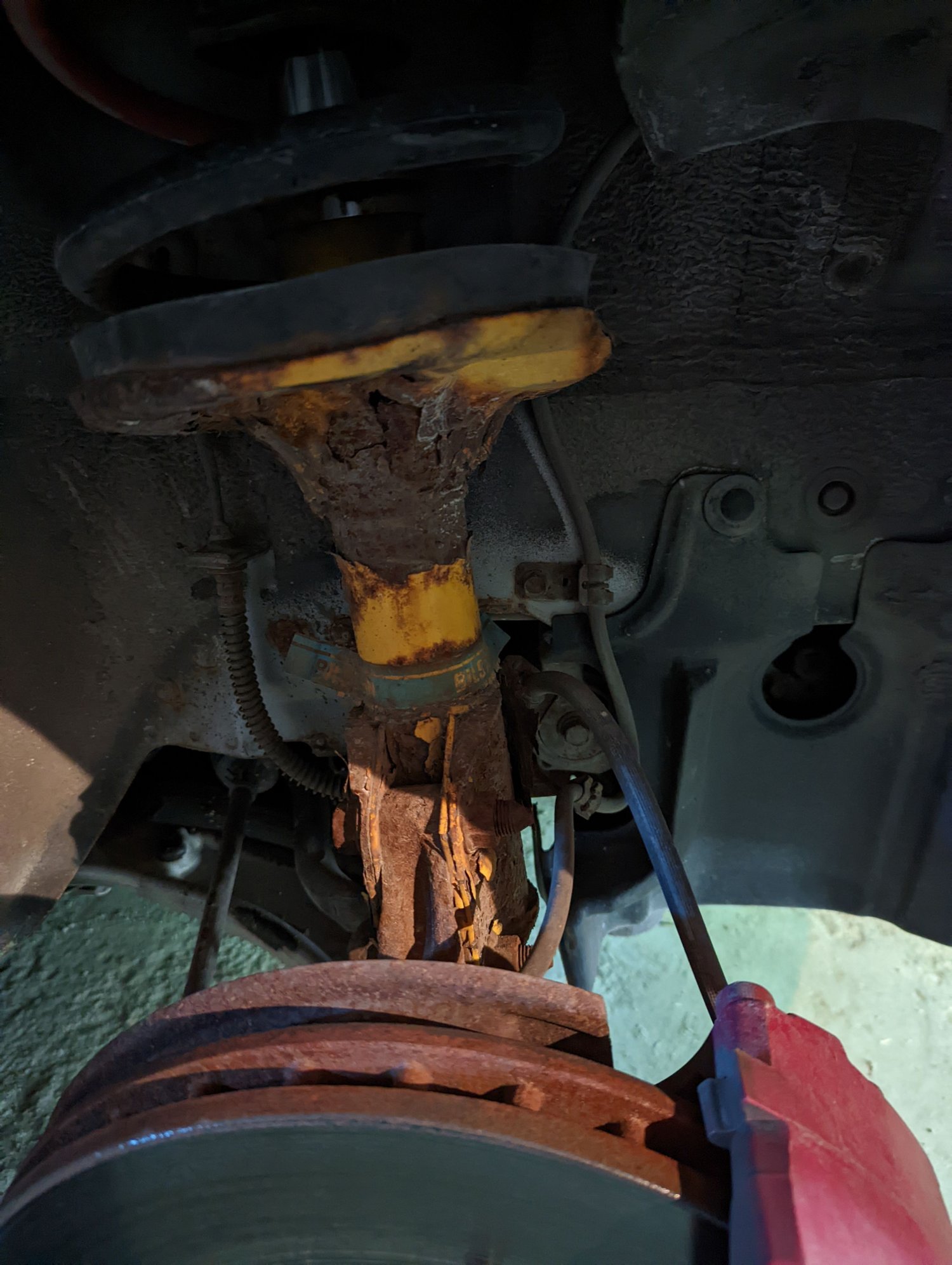

So I've been goofing around with gauges and what not, but today I finally got the car up and took a look at what I'm working with...and I need coilovers asap. The passenger side Bilstein is rusted out and leaving only about a literal millimeter of clearance between it and the tire. I'm really considering the FA 510's unless someone can tell me a reason not to....

dang that rust!!

Originally Posted by RobbieOh
dang that rust!!
16 years worth!
I'm working on getting the FAs installed now. The bolts holding the Bilsteins in place are being a tad difficult. Currently soaking them in liquid wrench. With that, a breaker bar, five years worth of push ups, and Thor's hammer...I should be able to get these sonsab**ches.

Oh my on that corrosion. No more driving the EvO in wet weather. Congrats on the FA's. Looking fwd to seeing them installed & the spring spec & rate please

Driver's side installed, but the rusty one pictured above wouldn't go down without a fight. It wound up tearing a gnarly gash in the outer axle boot.
Sucks, but I've got a repair kit coming from STM and if nothing else, the car is in the perfect spot for that repair...just going to delay me a few days.
Nothing ever goes as planned, does it?

Been there and done that for tearing the boot. I tore the inner boot. Good news is that you don't have to pull the axle out of the tranny to change the boot. I found some videos online that showed how to replace the boots with the stub axle still plugged into the tranny.
Man, that rust is nasty. You might want to start looking at the lower radiator support and rear unibody frame for rust as well. Joys of owning a 17ish year old car.
