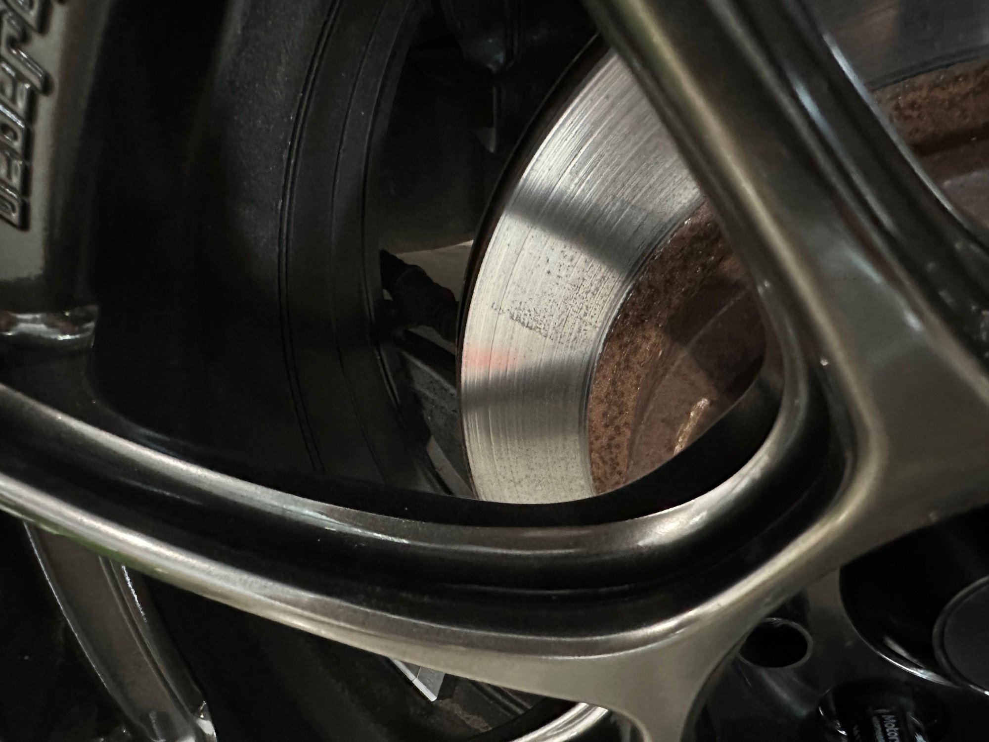

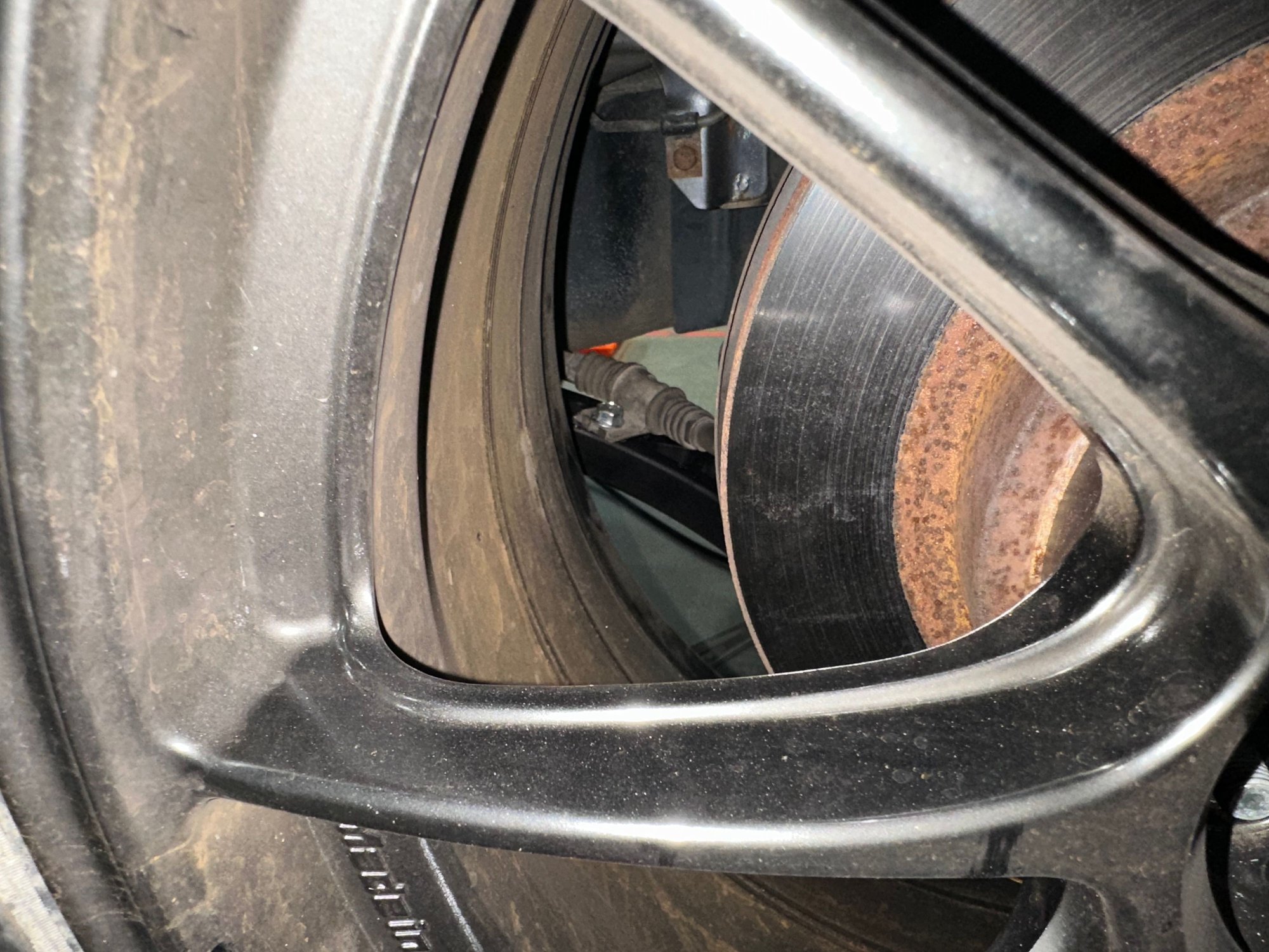

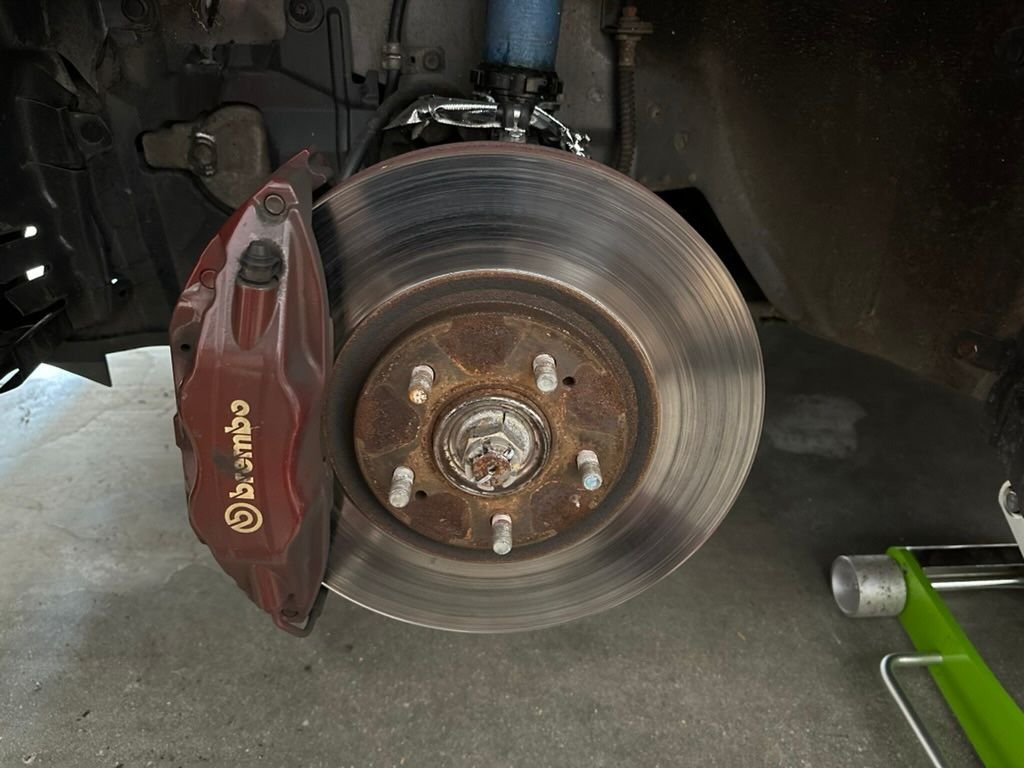

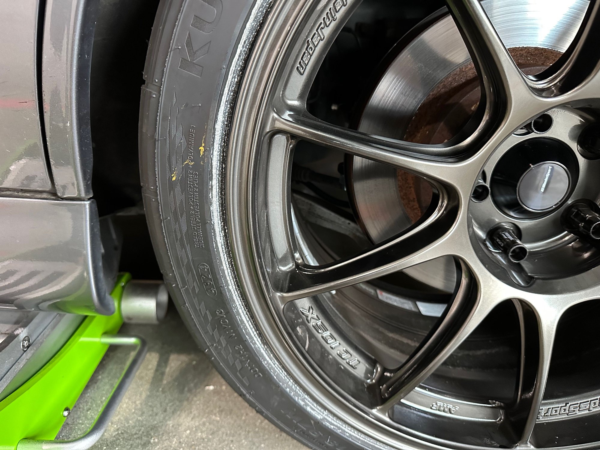

TRAILING ARM RUBBING
Even after getting aligned I was still having trouble with the rear wheels rubbing the trailing arms when the suspension compressed enough.
Where the wheel contacts the arm
Damage to rear wheel(s)
This was with 5mm spacers. Without the spacers, the wheels would contact the trailing arms at ride height. With the spacers, the wheels would just barely clear at ride height. With the spacers the tires came very close to the fenders but never made contact. As the rear suspension compresses it arcs inwards, helping the tires clear the fenders.
18x10+35 wheels may clear the trailing arms with stock rear knuckles (I never tried), but they do not clear with SSB knuckles.

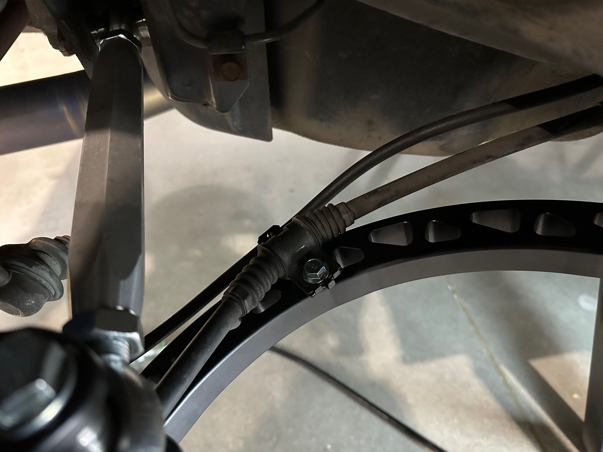

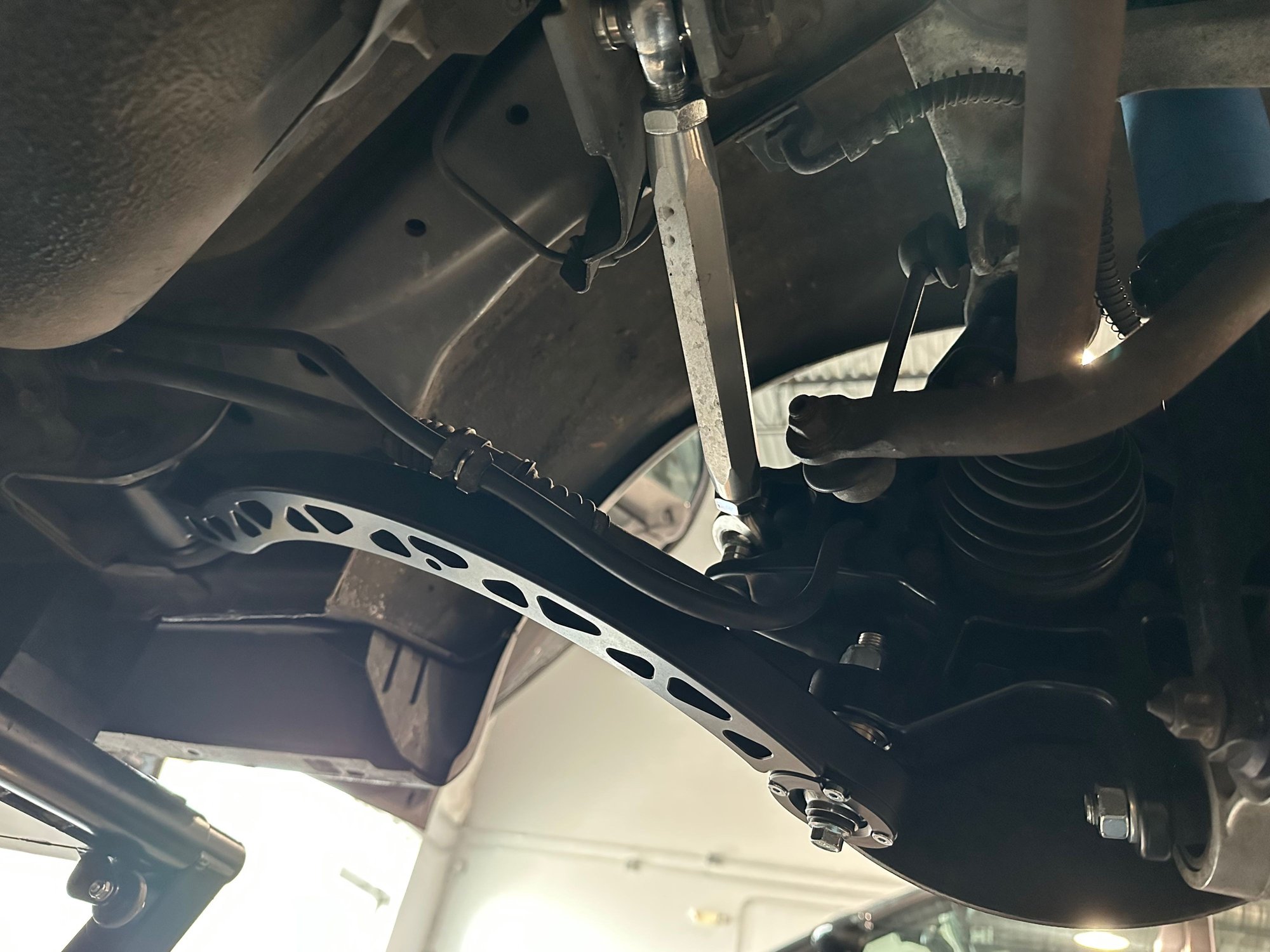

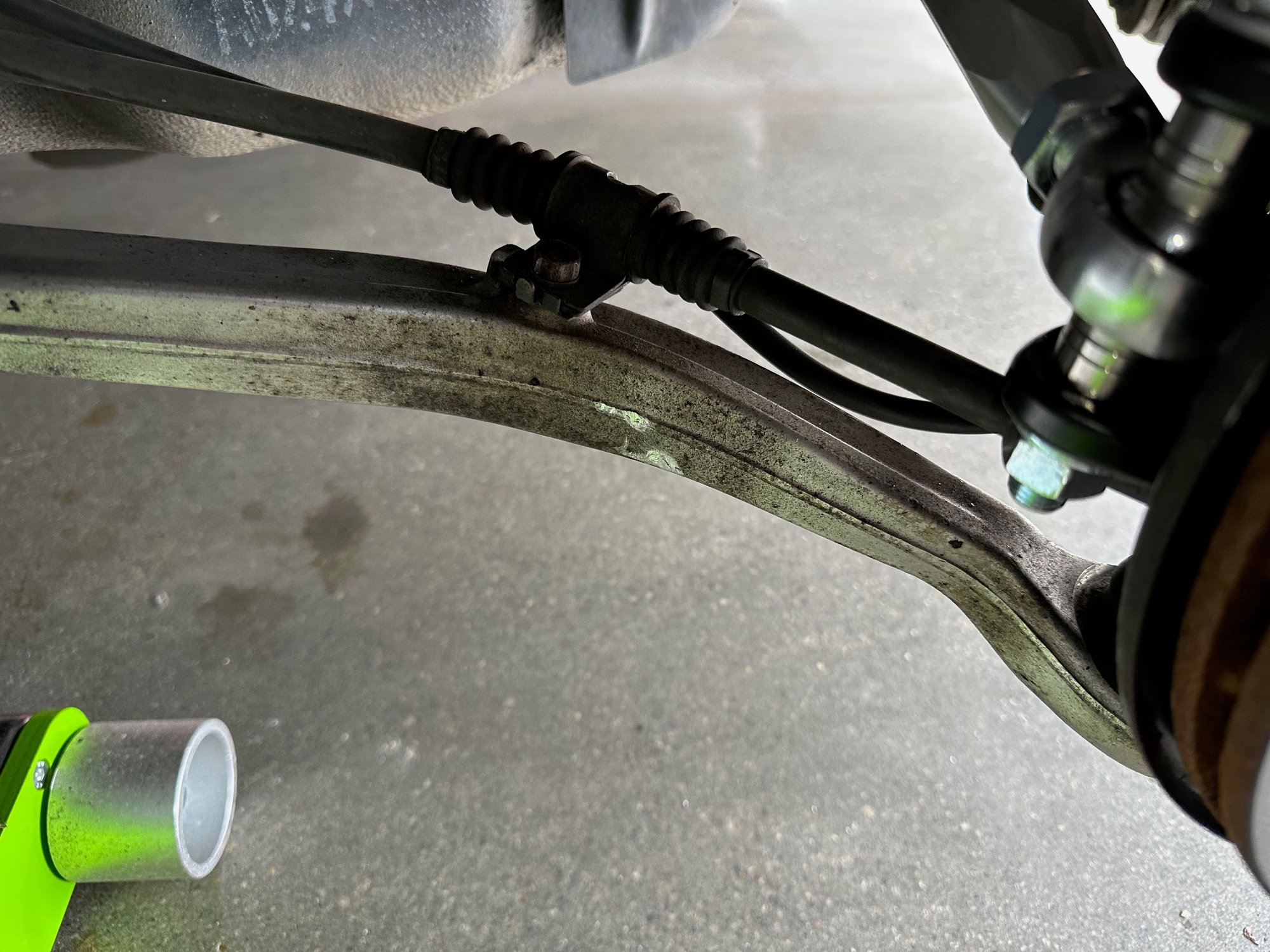

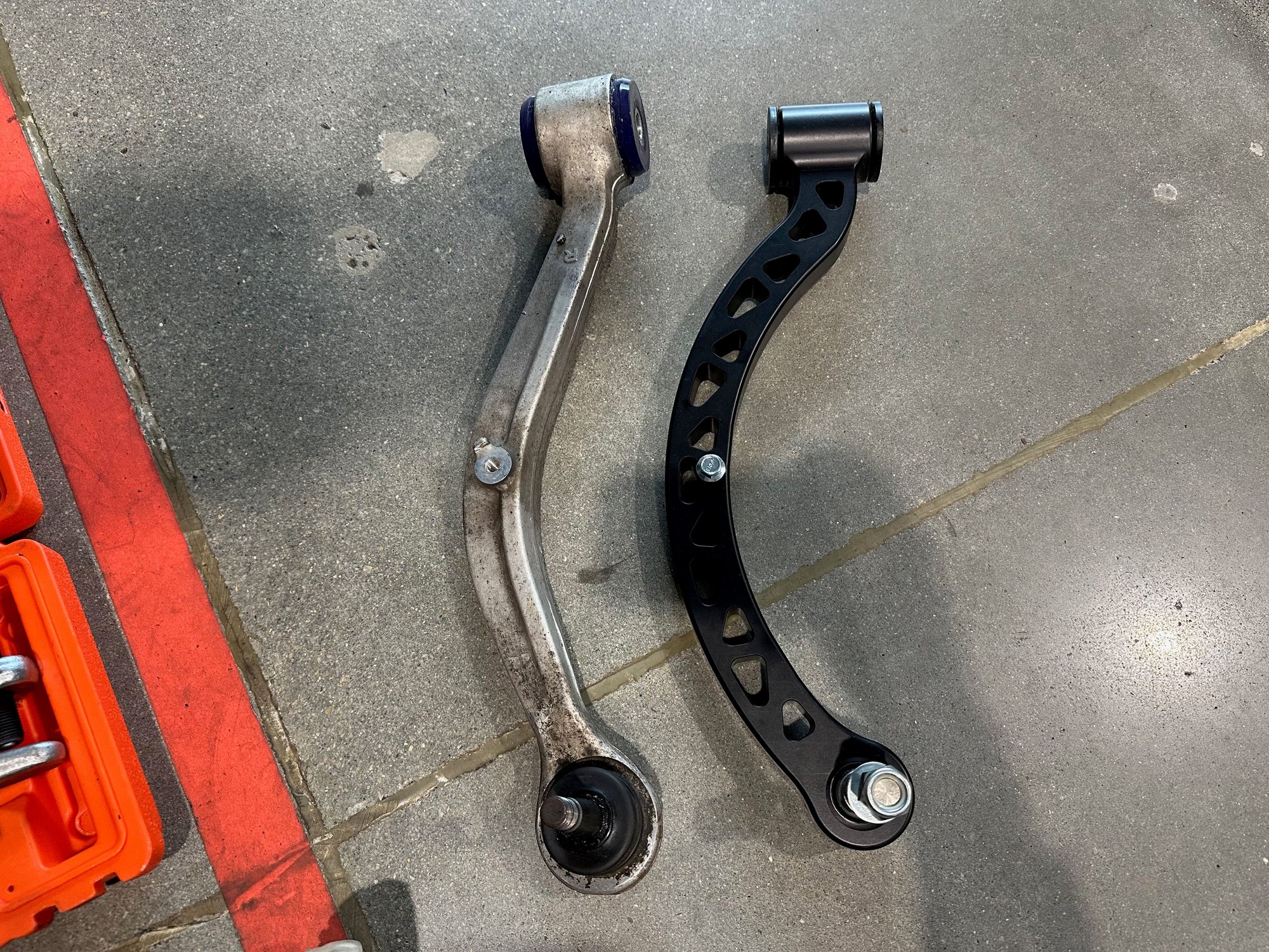

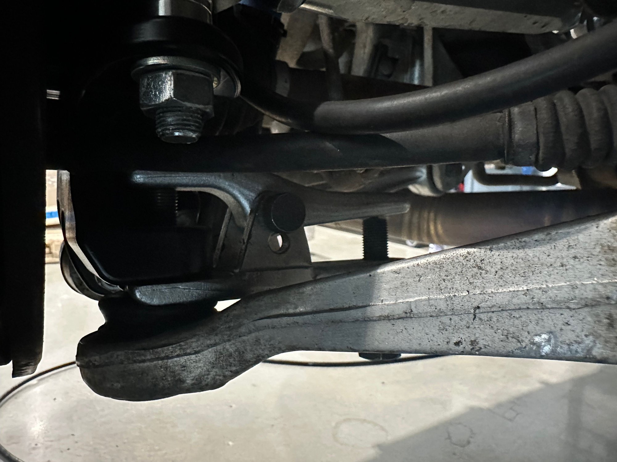

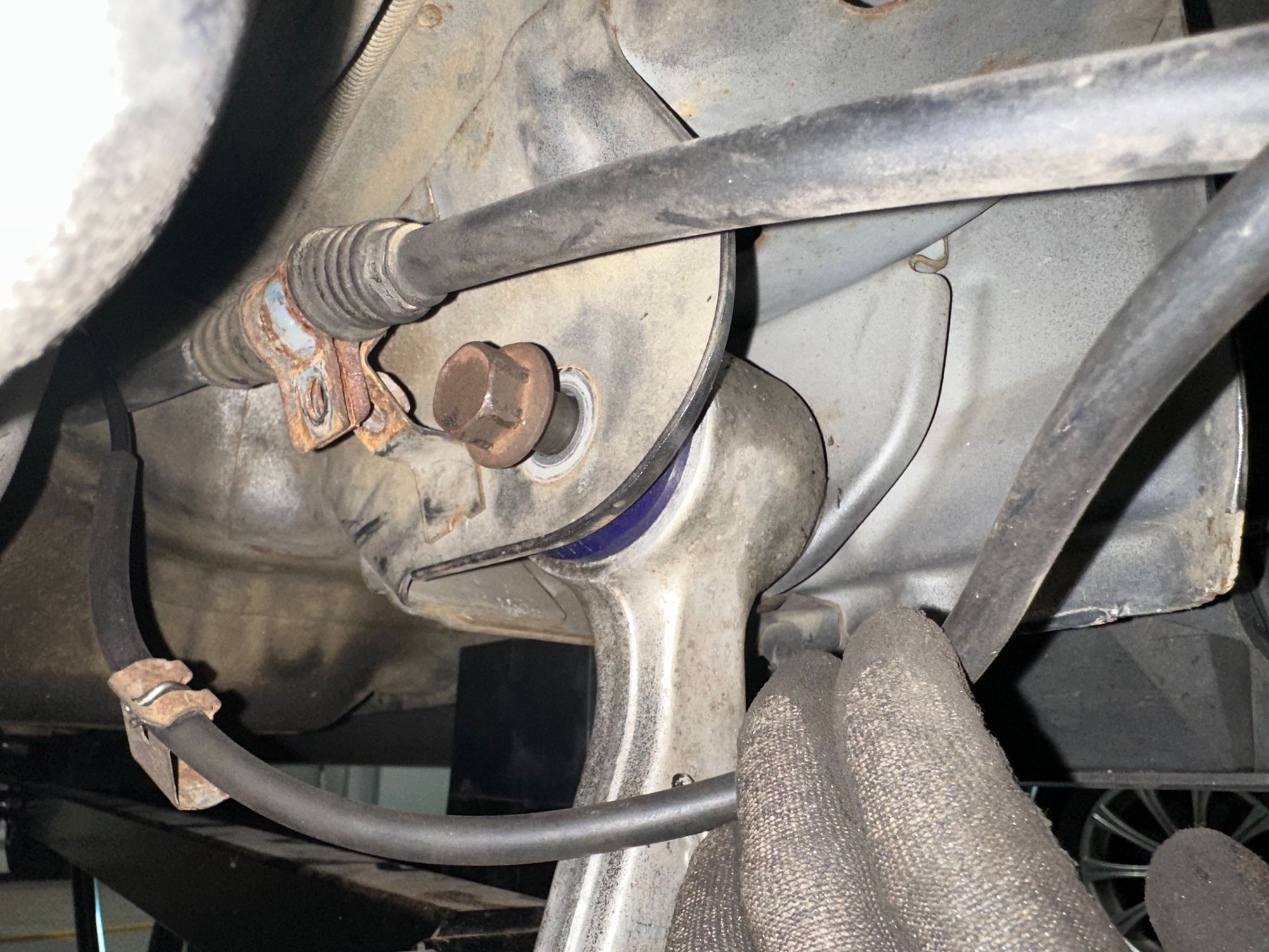

SSB TRAILING ARMS
I can't run a bigger spacer in the rear, so instead I opted to swap out my factory trailing arms for SSB trailing arms.
Today I installed them onto my car. Fortunately the trailing arms are easy to access and remove, which made this a quick install.
I used a ball joint removal tool I rented from Autozone to pop the factory trailing arm ball joints out of the knuckles. They came out with minimal force.
I noticed that the trailing arm bolts are very easy to remove and reinstall. I am able to hand tighten them up until they are flush with the subframe.
Here are some photos comparing the factory trailing arms to the SSB trailing arms. The SSB arms provide lots of inner clearance and are also a little shorter than the factory arms.
The install was straightforward. One feature I liked about the new ball joints is that they have a hex head on the bottom which allowed me to hold them in place while I tightened them down.
With these new arms my wheels now have plenty of inboard clearance.

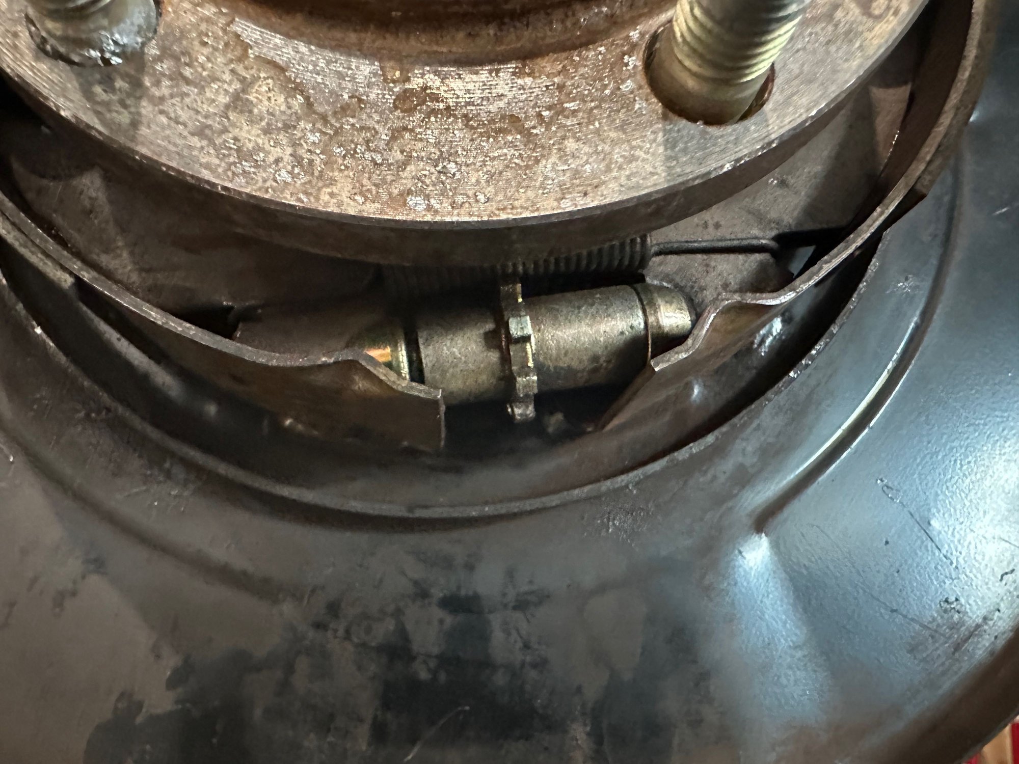

PARKING BRAKE ADJUSTMENT
Since I got the car my parking brake has required that I crank the handle as far as it can go to get the parking brake to hold the car in place. I finally got around to adjusting the brakes.
There are two ways to adjust the parking brake. First, the cable can be tightened or loosened by spinning a nut located under the brake handle in the cabin. I tightened my cable as much as I could using this nut, but that didn't help. The second way to adjust the parking brakes is to spin a cog located at the bottom of the parking brake assemblies behind each rear rotor. Turning this cog pushes the parking brake shoes outwards. Over time the brake shoes wear down, so this cog needs to be turned to bring the shoes closer to the rotor. I found that my left side needed to be turned two revolutions and my right side needed to be turned one and a half revolutions. I turned each cog until the rotor on that side could fully slip onto the studs without any resistance. If I felt resistance, I knew it was because the rotor was rubbing on the brake shoes. Now, my parking brake only needs to be pulled a moderate amount to fully engage. When I pull the parking brake I hear 7 clicks, compared to 13 before.

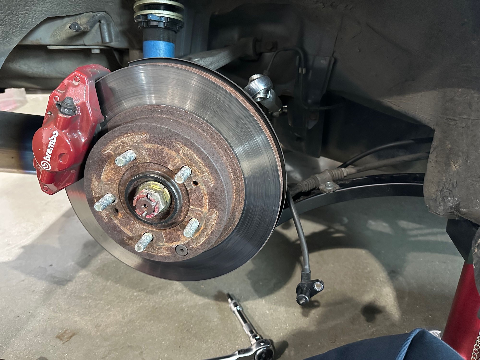

ANTI LOCK LIGHT
The ABS light can be made to flash in different patterns, each pattern representing a different ABS-related trouble code. I referred to section 35B of the service manual to find this info. To make the ABS light flash, pin one of the OBD port needs to be grounded. Pin one is for diagnostics. Pin four is a chassis ground. I used a paperclip to bridge the two pins. After connecting the pins together I turned the car key to ignition on and the ABS light flashed the number 13 trouble code. the number 13 code meant that my right rear ABS sensor has an issue.
I disconnected the sensor from the chassis harness and tested the sensor's resistance using a multimeter. The multimeter did not detect any resistance, meaning the sensor is broken. I tested the left rear sensor as well to make sure the multimeter was functioning properly and it was.
Fortunately the Holstein brand rear ABS sensors I purchased came with 3 years of warranty, so I only have to pay $6 in shipping for a replacement sensor. I did not think to test the new sensors I purchased before installing them in the car. I will be sure to test this new sensor before installing it. Rock Auto said the new sensor should arrive on Thursday. I have an HPDE this coming weekend and would like to have functioning ABS and center diff for the event. Fingers crossed it arrives in time and functions properly. The ABS light didn't flash any more codes so I think replacing the faulty sensor is all I'll have to do to get my ABS working again.

ANTI LOCK LIGHT FIXED
My replacement ABS sensor showed up in the mail, so I installed it and my ABS light went away.

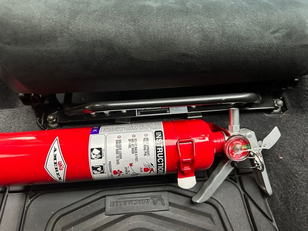

FIRE EXTINGUISHER
Over the summer I mounted a fire extinguisher in the passenger footwell. I made a separate post about it the day I installed it. Shortly before I purchased the fire extinguisher a video went viral on social media of a GR Corolla crashing and shortly after catching on fire, which spurred me into buying one.

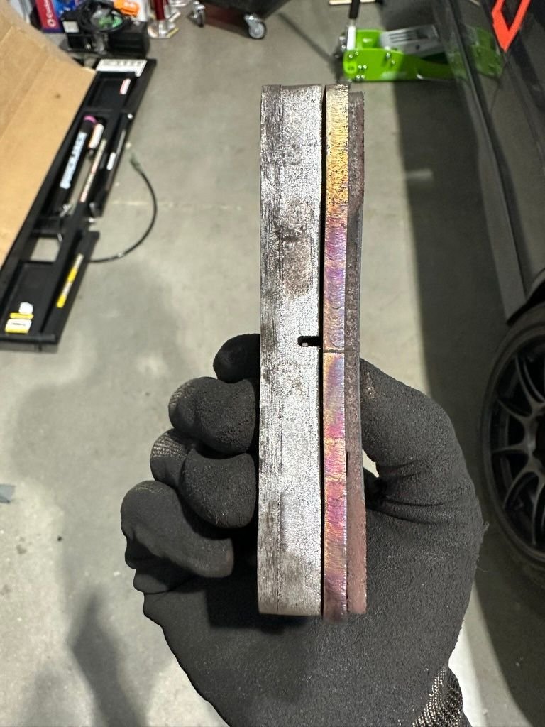

I thought my brake pads would last the weekend but I was wrong. After the first day I wanted to replace them. I may have been able to squeeze one last day out of them but didn't feel comfortable doing so. I had ordered new pads earlier that week but their delivery was delayed so I didn't have any spare pads to swap in. I looked on Facebook marketplace when I got home that evening for any local deals and lucked out. Fortunately our cars share pads with a good number of other popular performance cars. I found someone selling a cheap set of Carbotech XP8 front pads that, according to him, had only been used for one track day. They came off his Subaru BRZ. I bought them that night, swapped them in, and had no problems for the rest of the event.
Carbotech XP8 vs EBC RP-X.
I liked the RP-X pads I had been using up until then. They had strong initial bite and were easy to modulate. They were also silent. My favorite thing about them was the price. I bought them from Summit Racing for $155.

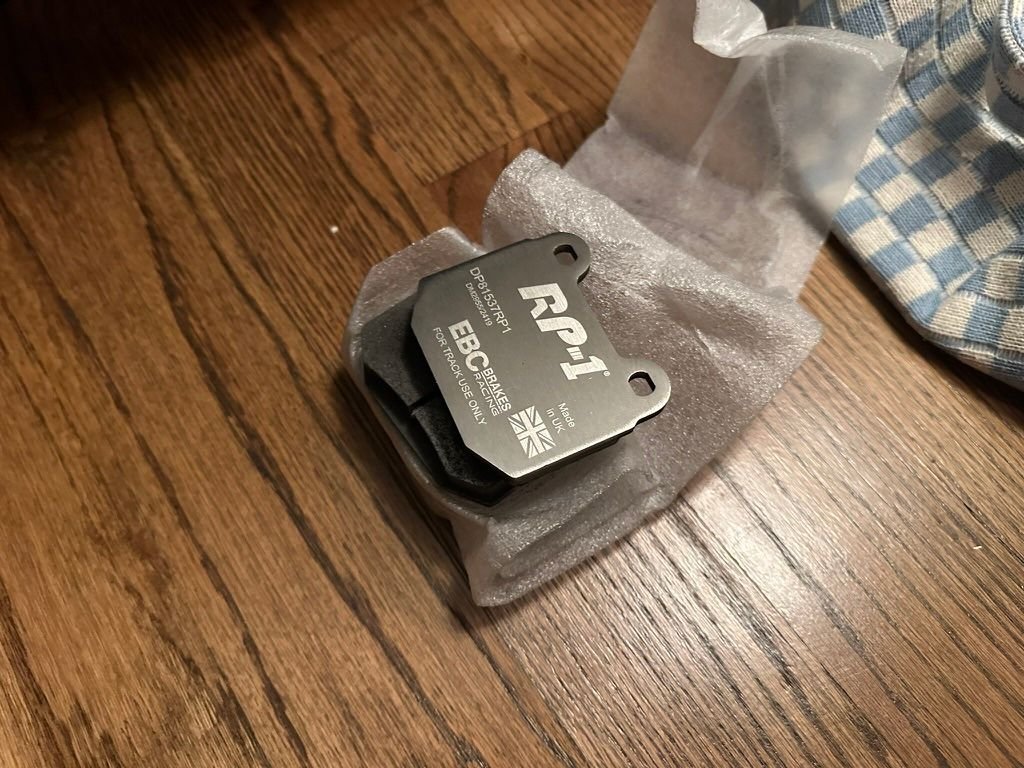

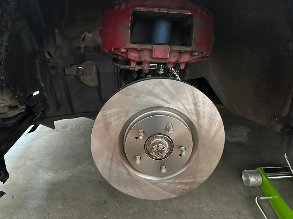

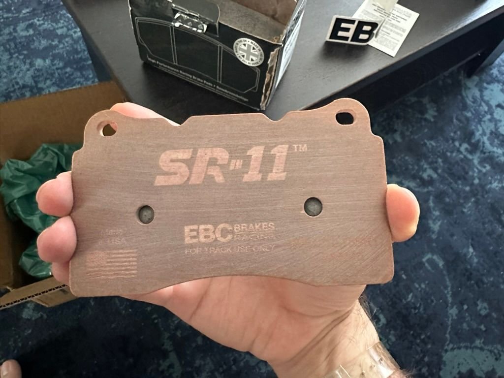

NEW BRAKE PADS
After that weekend the pads I originally ordered arrived in the mail. I ordered a set of EBC SR-11 front pads and EBC RP-1 rear pads. These are EBCs lower friction pads. They advertise them as being easier to modulate due to their less aggressive bite. I primarily bought them because I found the SR11s for sale online for $230. EBC advertises their SR series pads as long lasting endurance pads. Endurance pads from other brands cost a lot more so I was interested in trying these out.
Unlike the RP-X and XP8 pads I had just had on, which were both silent, the SR pads shriek at even the lightest application of the brake pedal. The sound is so ear-piercingly loud that I am certain I will damage my hearing if I have to regularly listen to my brakes. The rubberized coating that was once on my pad shims had melted off, so I wondered if the bare metal shims were vibrating against the backing plates of the pads, causing the sound. Girodisc sells front and rear rubberized shim sets for $15 per set, so I bought all new rubberized shims hoping that would quiet the brake squeal down. I also applied a generous amount of brake grease everywhere I could. Neither helped at all. I bought a cheap set of Bosch pads from RockAuto to keep on the car when I'm driving around town.

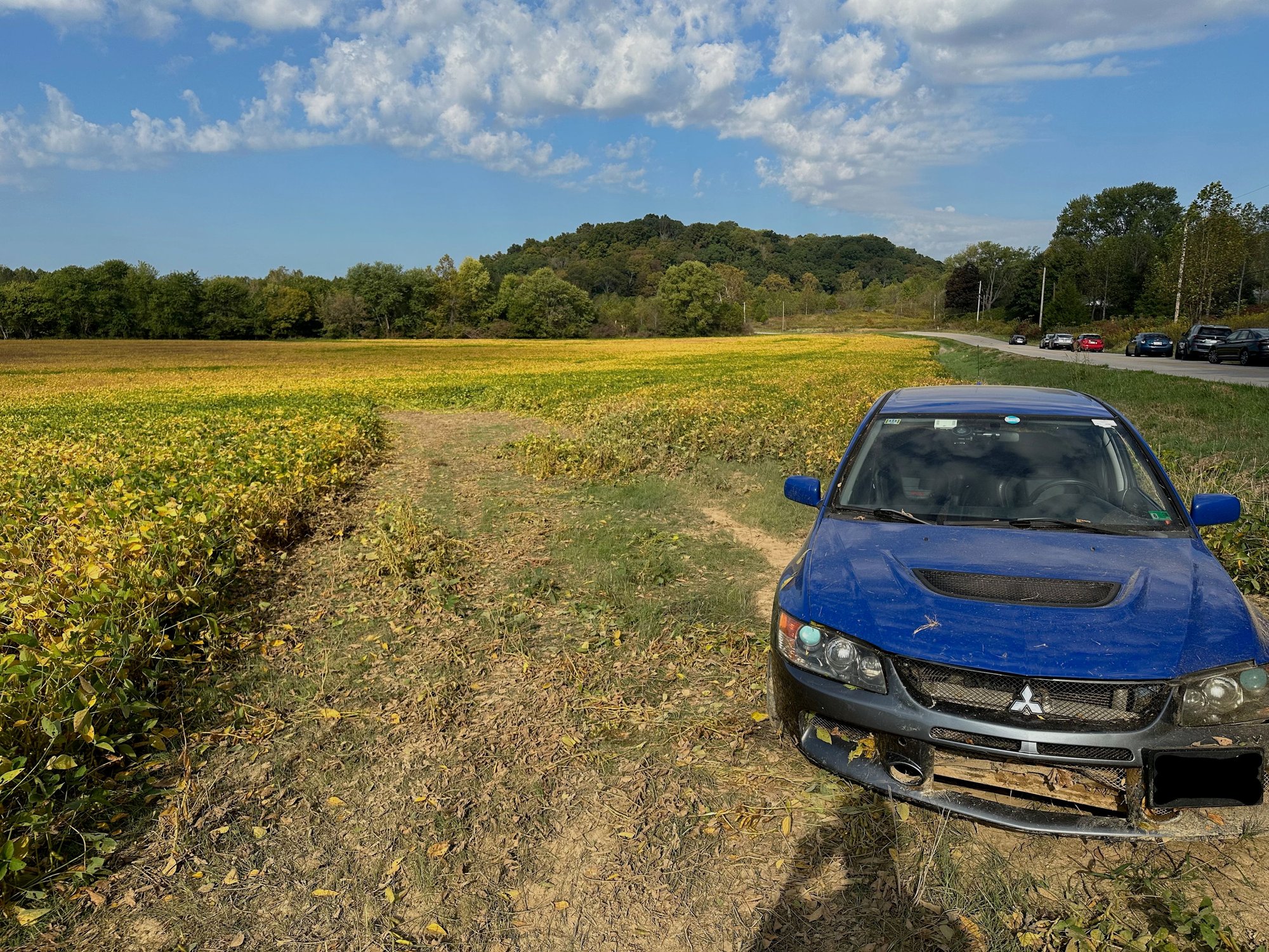

CRASH
I was out for a drive early in the morning when I crested a hill while turning and lost control. I was able to at least avoid flying into the woods and instead pointed the car into a field of soybean stalks. They were slick with morning dew and the car slid sideways through the field. Unfortunately the field was a few feet lower in elevation compared to the road so the front right corner of the impacted the ground pretty hard. Luckily the airbags didn't deploy.

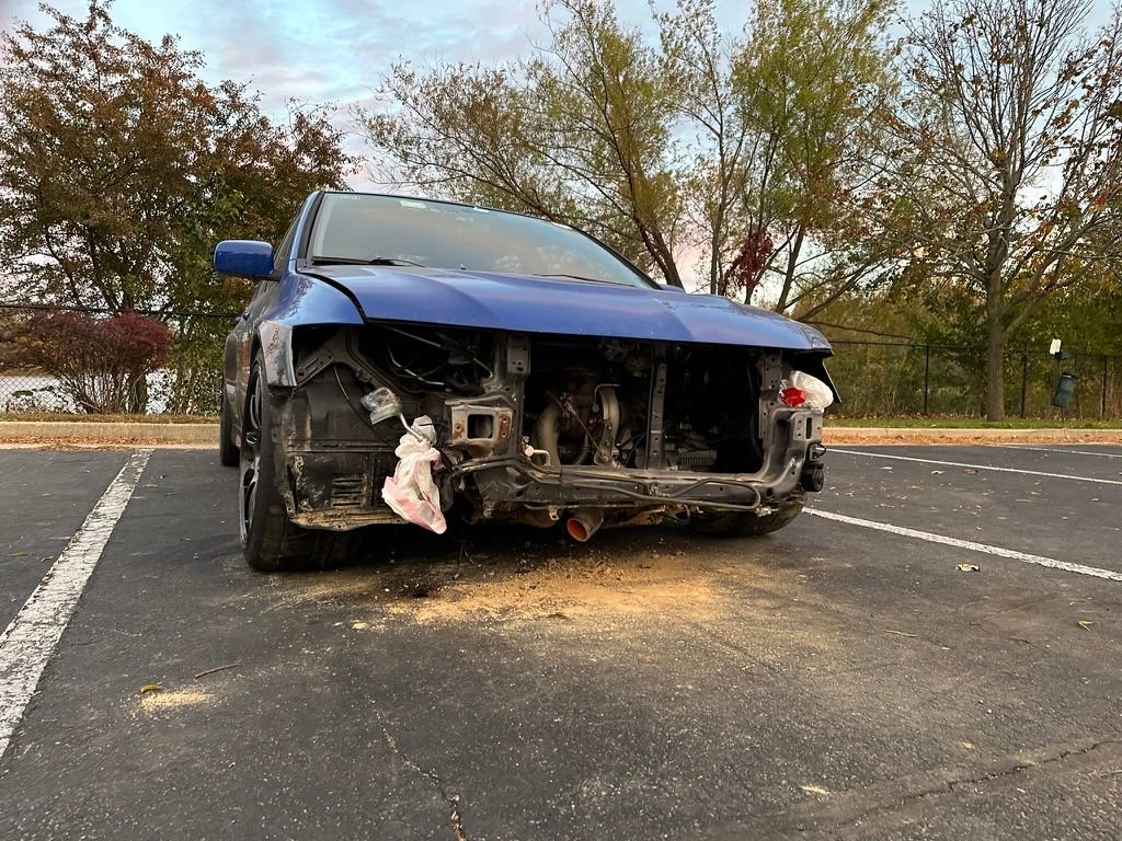

I had the car towed home and got to work stripping the front end so I could assess the damage. The lip, undertray, and fender liners were destroyed, the front right corner of the core support got bashed in, the two parts of the body that the lower core support is spot welded to both got bent at the front, every heat exchanger (except the intercooler) needs to be replaced, the front center member (north south bar) got bent, and one of the upper tabs of the front right headlight broke off. The bumper skin, to my surprise, is still in one piece with minimal scratches, but some of the brackets inside need to be replaced. The crash beam is fine. The hood and fenders are fine. Neither of the lights are cracked. The car still runs, but one of the lower intercooler pipe couplers ripped, so the car can't rev. Parts of the exhaust got flattened a bit. My rear right wheel is tucking into the wheel well, but all the suspension components look okay so I'm not sure what's going on there.
I stripped the front end to the best of my ability and had the car towed to a local body shop for an estimate. I am paying for the repairs out of pocket. I asked the shop to only repair the metal bodywork. The cost to straighten the body, repair the core support, and repaint where needed is $946. The bodyshop has had the car for one week now and I am hoping to hear back from them soon.
In the meantime, I purchased a new radiator, radiator cap, and AC condenser.
I wanted an Evo 6 radiator so I could relocate the upper coolant hose. The three options I was considering were CSF, Koyo, and PWR. As I was shopping I saw a listing on Amazon for the Evo 6 Koyo radiator, shipped and sold by Amazon, for $305. They only had one in stock so I took that as a sign and purchased it. The stock radiator cap doesn't fit onto the new radiator so I had to buy a new cap too. I purchased a Circuit Hero radiator cap. Finally, I purchased a Nissens AC condenser from RockAuto. I could've gotten a Denso condenser for the same price, but the Nissens came with the little tank, lines, and new o-rings.

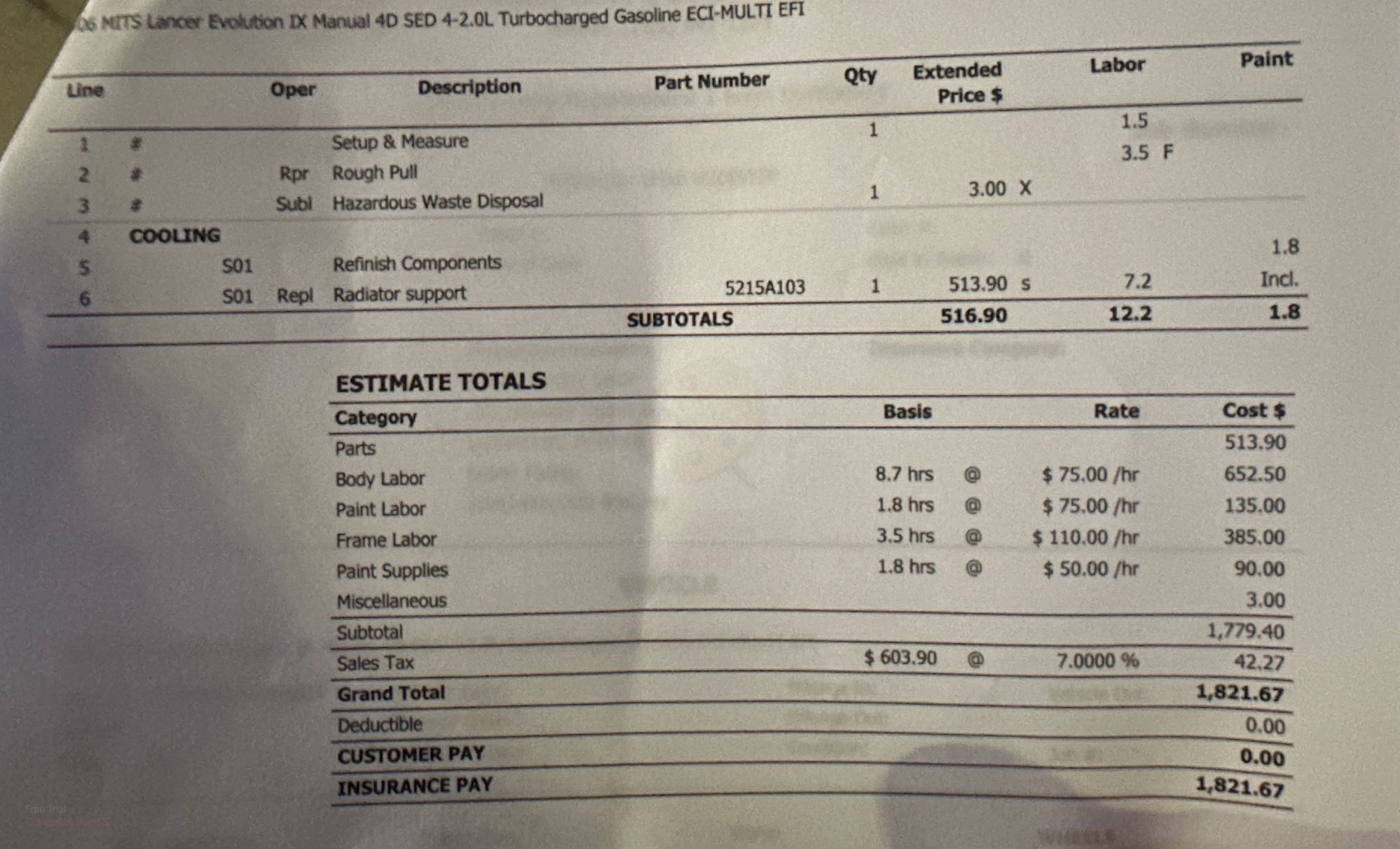

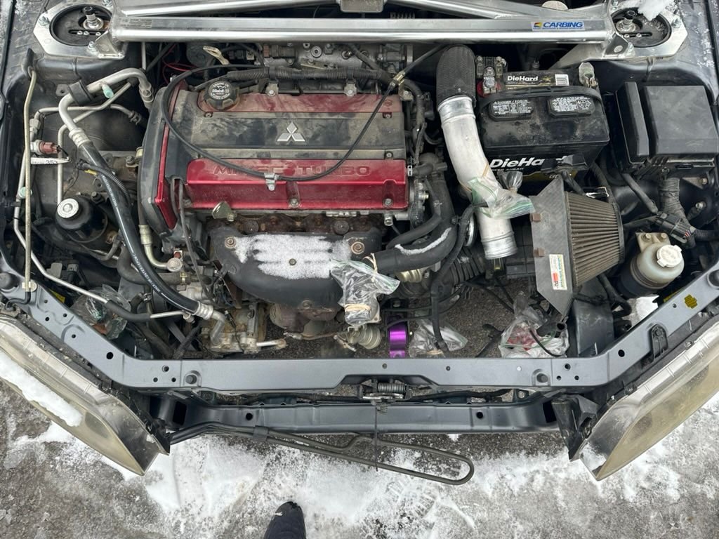

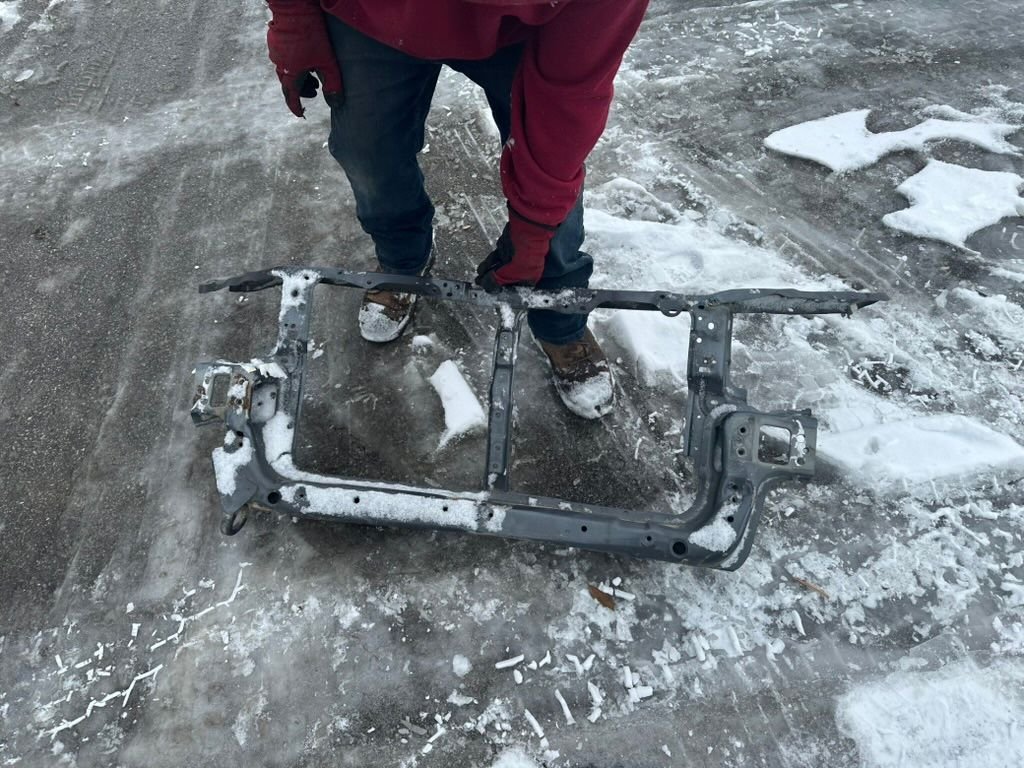

CRASH REPAIR UPDATE

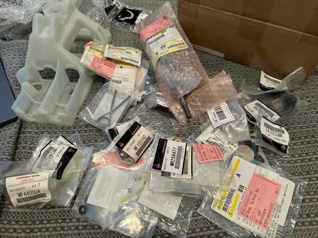

The body shop initially told me they would be able to reshape the core support. After a while they called me to let me know they were unable to do so, and that fixing the car would require cutting out the old core support and welding a new one in. This is what I initially thought was going to happen, but I figured the body shop knew what they were talking about, which is why I originally accepted their quote to bend the front end back into shape. The body shop sent me a new quote and I accepted. Part of me wanted to argue with them to remove some of the hours billed for the time they spent trying to reshape the original core support since all of their work ended up needing to be cut out anyways, but my car was in their hands and I didn't want to risk upsetting them over a few hundred dollars.
Luckily, the full radiator support is still available from the dealership.
The body shop had the car from late October until early December.
Old core support
Old core support
Between then and now, life has been busy, so the car is still in this state. I did try to work on the car once, which is when I discovered more parts I need to replace. The AC condenser I purchased to replace the old OEM unit didn't fit so I ordered a new one. The north south bar was twisted in the crash so I ordered a new one from a dealership. The power steering cooling line (at the bottom of the photo) was bent badly enough that I decided to purchase a new one rather than try to fix the old one. I also ordered a few various clips, grommets, etc. that broke or went missing during the crash.

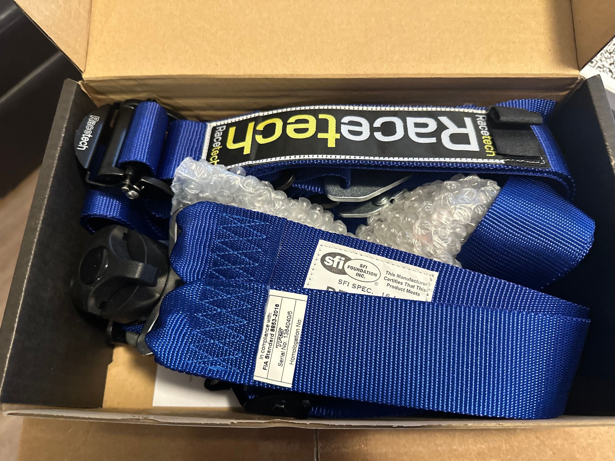

At the same time, Racetech was offering harnesses expiring soon for 40% off, so I purchased a pair of their GT harnesses.
