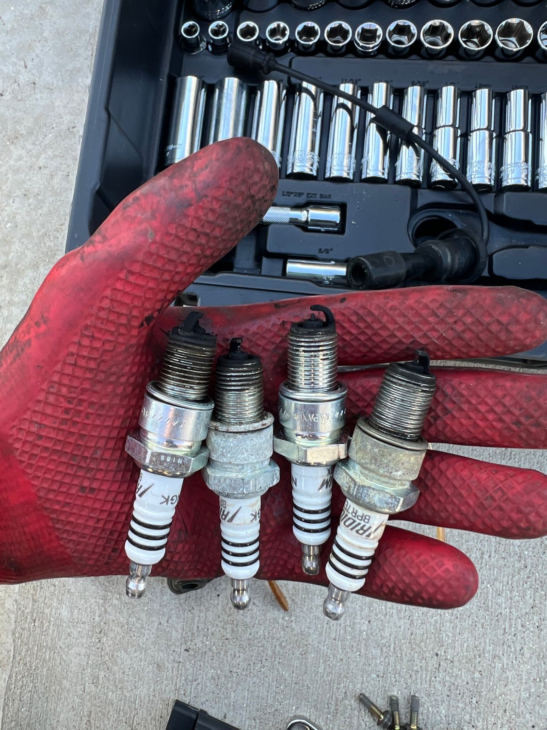

Old Mar 1, 2024 | 02:56 PM
New Era's Avatar
Joined: Mar 2024
Posts: 7
From: ohio
Originally Posted by harry wilson
looking forward to see some pics
this is the sprarks before ill take a picture of the compression test after too
