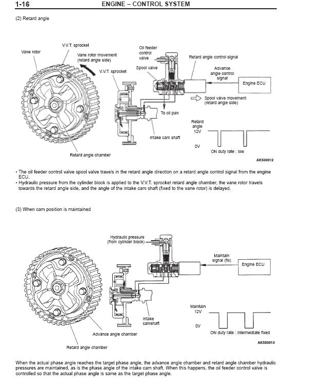

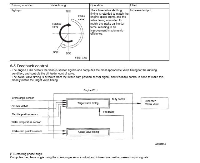

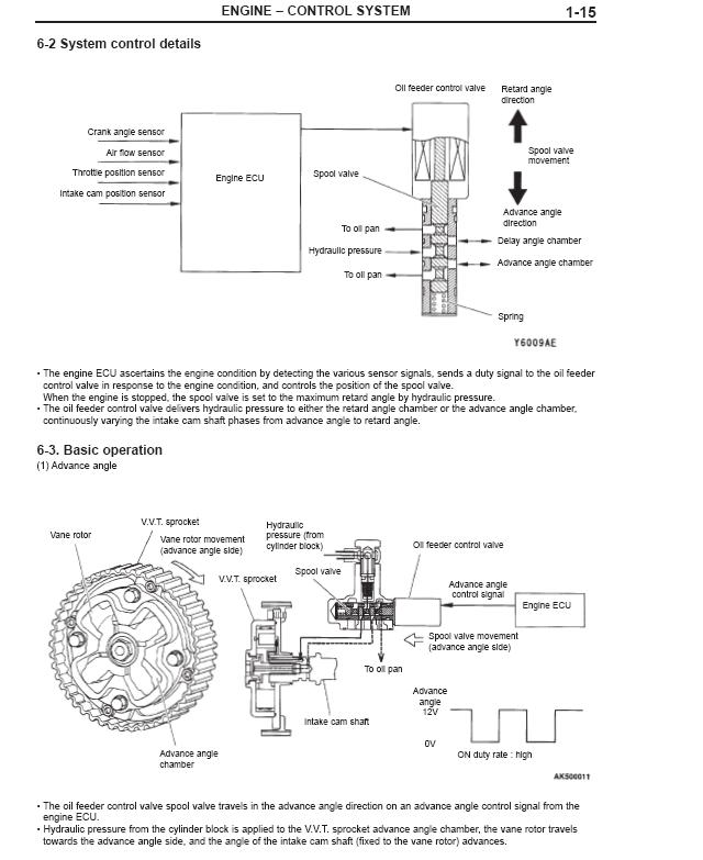

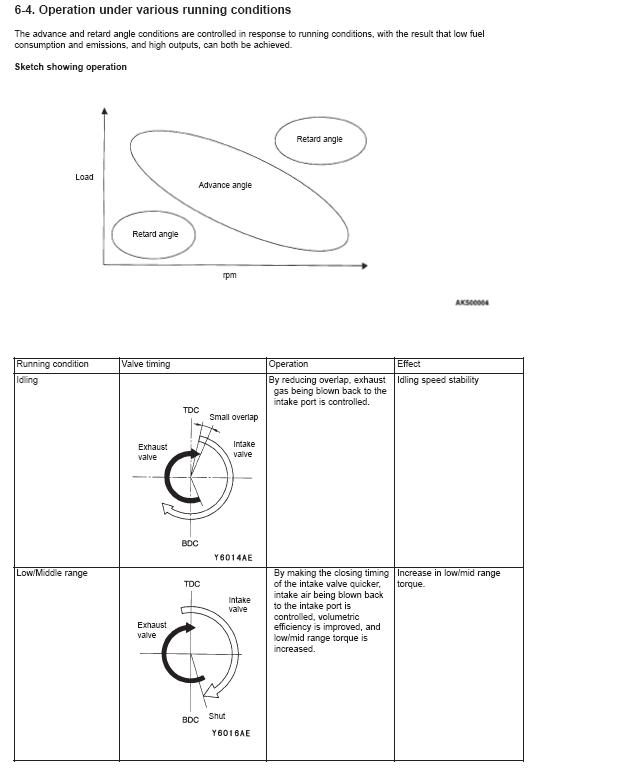

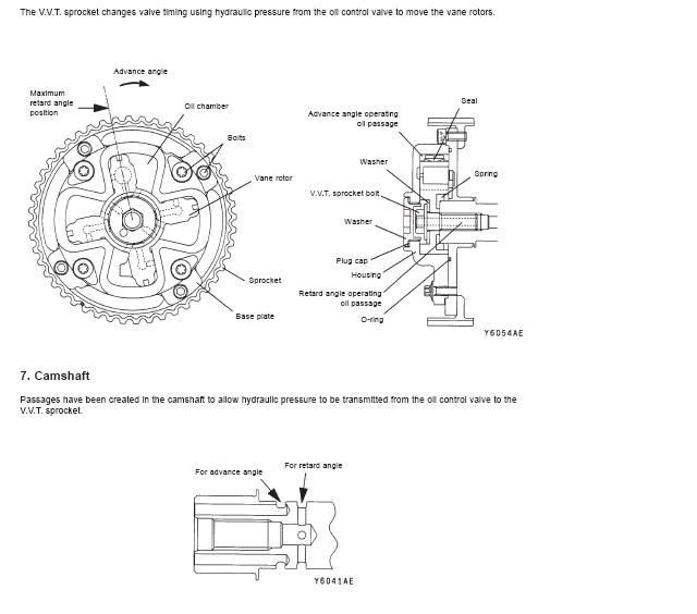

The MIVEC system on the Evo is strictly the continuously adjustable cam gear feature of the MIVEC system. And even then, it's only on the intake cam.
There is no cam profile switch. At all. It just retards the timing at low RPM's and advances in the middle to high RPM range. (until the load gets real high then it retards again in the high RPM's.. see attached picture)
Attached to this are several pictures further outlining the MIVEC in the Evo IX:
Hope this helps.

*EDIT* Those pictures were originally posted up by Andenbre. Sorry I didn't give you credit when I first posted these, I was kinda in a hurry at that moment. Those pics are awesome, thanks for posting them up

Very cool information. I was wondering about how MIVEC worked -- Thanks
I wonder if there is a market for an electronically controlled version in the aftermarket.
Were those the pages I posted terry? if so no prob I am glad to see them being used, just curious
