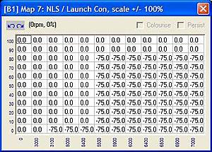

Attached is a screen shot of a NLS/LC map supporting vehicle speed dependent no lift shift / launch control. The map's configuration (load/y-axis, input, output) are identical to the standard Vishnu configuration. The difference is that PWM0 is now a function of vehicle speed over a y-axis range of 0% to 95%. When the clutch is engaged, PWM0 is equal to 100%. Note that I set the launch RPM at a low number for casual testing.
I also attached the maps that I had running on the car tonight. I ran out of time so no pictures.

In that case the region above the lowest row would be set to zero. In simple terms rows represent the vehicle speed, thus 0 is stopped and 90 is really moving.
See attached for an example...

If you read above, when the clutch is not pushed the module forces a 100% (y-axis) condition, where the 100% row is equal by definition to 0 or no fuel removed.
And to answer your other question, if only two people want this stuff then it most likely will never be made available.
