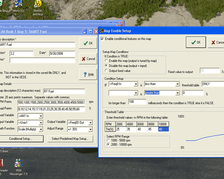

I downloaded all the new Firmware/Xmap per Dustin's instructions. I then began setting up my Conditional S.M.A.R.T. map and ran into a little problem. I was unable to change the Output Variable to Freq0 Out. All I could choose from is Feq0O Out. On the Conditional Setup in the Map Enable Setup, the "RPM" was not showing in it's box. I could not get it to appear, everything else was working out as directed. I'm concerned about this because I know from the past that if all these parameters are not set up properly, the car will not run right. Please help. Thanks.

Don't worry about the RPM in the Box, the second condition line is disabled after the word ONLY. (AND , OR will activate second condition statement).
"Freq0O Out" may just be a SW typo. The best way to test if all is OK is to watch the cursor track the smart fuel table while you drive around with Xede connected to the laptop.

Just checked mine and it has the variable for output as "Freq0 Out".
Are you using Xmap v3.2.0.17 (the one I'm using showing the correctly "named" output variable) or are you using Xmap v3.2.0.16?

Yes, I'm using the v3.2.0.17 Xmap. It's weird that your showing Freq0 Out on your Xmap and I'm not.

Freq0o out is fine. There is only one freq based output on evo xedes, so as long as you have it set to a freq out, you will be fine.
