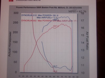

How do you like this Big Al dyno sheet from today - its his new Stage Zero Plus - very lumpy and lean eh?

Looks great About 30HP low but like you said rich to slolom round the knock sensor
The marketing of richer than needed AFRs is rubbish its cause he has to toe the knock sensor but servs it up on a silver platter so as not to cause heartburn of the SAFE power left in the kitchen

MP5; that extra hp left in the kitchen is ONLY crumbs !!! Prob about 5 - 10 whp less than could be made at 12.0 / 1 a/f ratio. Do you think it is wise to send out a customer with no wideband 02; no knock meter and no egt with a tune close to the edge that may lead to detonation and or high egts in conditions of extreme temp changes or varying fuel? Its one thing when we are talking about people who mointor these things and adjust them on a daily basis. But, it seems the typical reflash client wants a buy it and forget it type solution. Mp5 what kind of a/f would you like to see run on a car like this on pump gas?? OH and do you really belive that this kit - a EBC, downpipe and 2.5 muffler can make 310 whp ? I belive if I am not mistaken that your champion Shiv made only like 293 whp on Eric's car with a FULL 3" turbo back ON THE SAME DYNO and at much leaner a/f's ? Where is the missing whp?

Not bad but I will let someone tune my car that has over 8 years not 3 months and has a business not works out of his car with a laptop. It's your money and your car not mine.

Actually, Eric's car only had a cat-back and an XEDE. Not even a straight thru one at that. I suspect a proper 3" straight-thru muffler would have been worth another 5-6hp. But who's counting. As for the running it lean, have you even seen the a/f ratio graph? It's not lean by any means.

Would you mind posting the dyno sheet up so we can all see the a/f's ? Do you personally agree with MP5 that the a/f 's should be run much leaner than the 10/7 ratio in the above dyno sheet? Thanks

No Im not saying much leaner Im saying he must dance around knock sensor activity which BTW is different under different RPM range so like a butchur he slices the fat off the meat but he has to waste some meat instead of leaving the fat. I am sorry I knocked your setup I was thinking full 3" TB.https://www.evolutionm.net/forums/sh...threadid=44124 there you go same model dyno Texas heat
