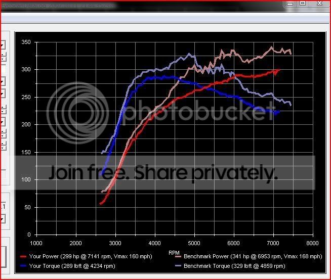

This is why we all need a better FMIC , and for the $109 "EBay" intercooler the results are more than note worthy...
The lower reading plot is with the following mods on a IX tuned by me:
megan tbe/forge mbc/nisei licp/walbro FP
The higher plot is the same car with the addition of the following (its a bit notchy since it is untuned for the new intake so she was knocking a tad...more air flow means the need for more fuel...better gains will be attained with a tune thats already setup in a few days from now):
hks super mega flow/3.5" "EBay" Intercooler
Let me allow the graph to speak for me...

Thanks for posting that up, Alan
Ebay or not, the numbers speak for themselves, and I'm VERY happy with the results thus far.
I look forward to the tune in the very near future so my numbers can be even HIGHER

Those are some crazy gains!
Wait a minute...did you have the specs for an Evo IX selected for the first plot and the specs for an Evo VIII on the second plot? Just playing.

No i fixed that...lol....i re-ran his datalog from the initial tune with the new gear ratios/correct weight for an Evo IX SE....
