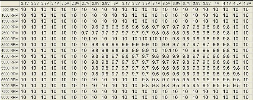

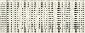

Old Apr 1, 2007 | 06:11 PM
  #70
DangerousDan's Avatar
Posts: 4,015
From: Charlotte, NC
try this map as your map b and you can track exactly what cell you are in. makes fine tuning your map easier.
this is my latest map. the mods are: sri, rrm DP with high flow cat, custom catback exhaust, and rrm udp. temp 70*F.
EDIT: removed information, update tomorrow
