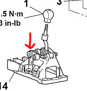

I'm having a hard time picturing what broke. Was it where the red arrow is pointing?

It's almost exactly where the red arrow is pointing. There is a spring that is held to the shift lever by a bolt. the bolt shot apart the spring came off and the bering assembly came undone. big mess, but it's fixed for now.

Wow that is a big bolt to have break, since it's not like there is any force there really.

I think he meant the nut spun off, not that the bolt broke. Throw some locktite on it so it doesn't happen again

yea the nut just unscrewed. It'd be pretty screwed up if the thing broke.
