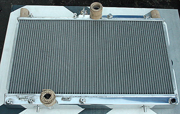

just looked at some pictures of evo 8 radiators (i heard that they are the same as our ralliart) appears it's on the lower passenger side of the radiator on the motor-side of the radiator
http://www.boombopracing.com/ebay/pi...676-EVO8-1.jpg
http://www.agencypower.co.uk/images/apevoradiator1a.jpg

Our radiator has a petcock instead of a drain plug, that might be where you're confused. If you're standing at the front of the car, the petcock is on the bottom of the radiator on the left side.
