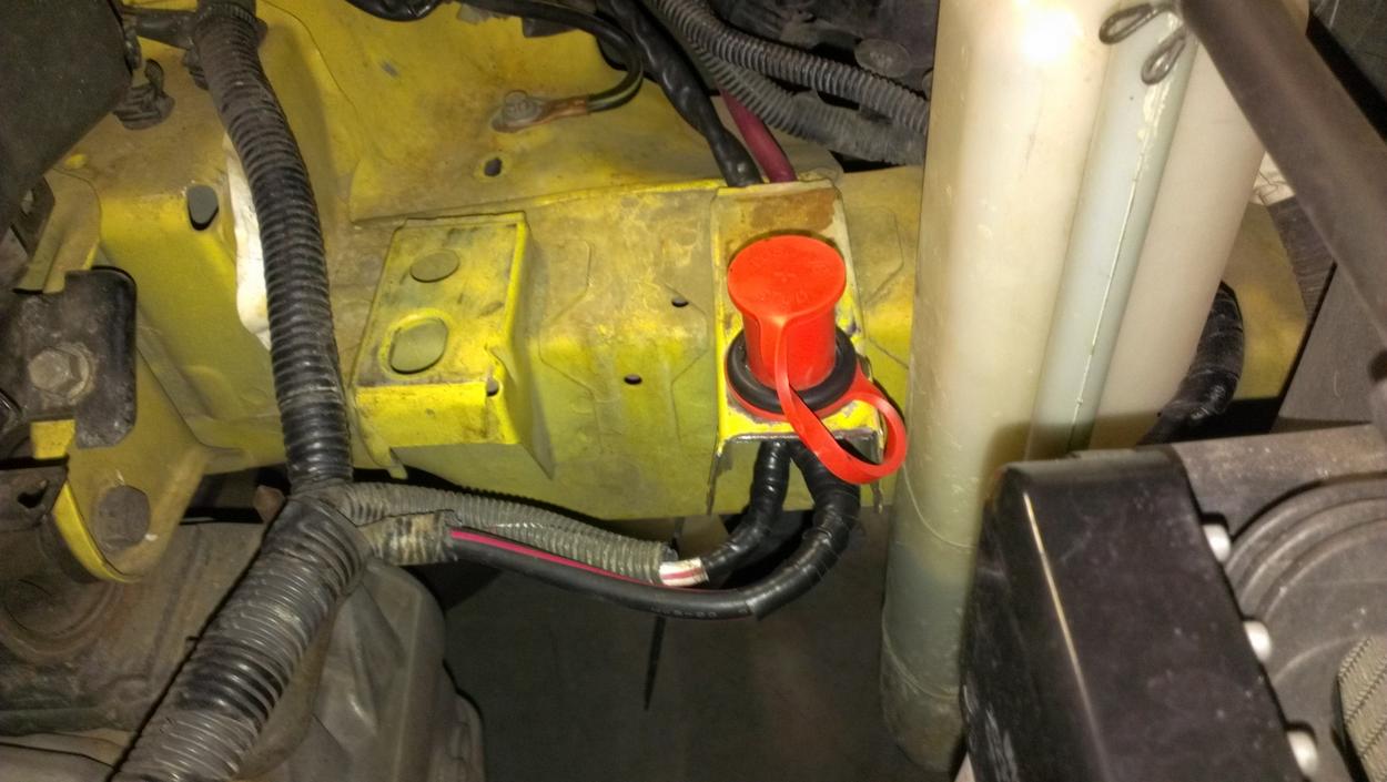

Alternator
Ok, a while back I relocated my battery to the trunk. Anywho i finished my positive terminal post mount under the hood and need to mount the alternator power wire that has a fuse built in to it. Mine doesn't say what the amp is on the fuse and I don't plan on using the stock one. So far from what I have searched seems to be that that particular fuse is a 100 amp. Does anyone know for sure. I just am asking to make sure. Most of the posts seem to be for evos. Thanks for the answers from anyone who knows.
Thanks
aRon.

Just an fyi incase anyone else needs to know, after calling a few different dealerships and getting different answers, I found a guy at one dealership parts department that knew for sure it is a 120 amp. I for sure thought someone on here may have known for sure.... lol
