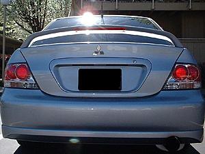

To remove the badges from your car you'll need...
-Floss
-Goo gone
-Hair dryer
It's really easy. All you need to do is take a hair dryer and heat up the badge for aprox. 2-5 minutes until the badge is nice and hot. Then you take the floss and carefully wedge it between the badge and the adhesive tape. Go back and fourth with the floss and use the Goo gone to get the adhesive tape to come off easier.
You don't really need a hair dryer but It's alot easier if you have it.
Here's a picture of the rear of my car without the "Lancer" and the "Ralliart" badges.
Hope this helps some.
