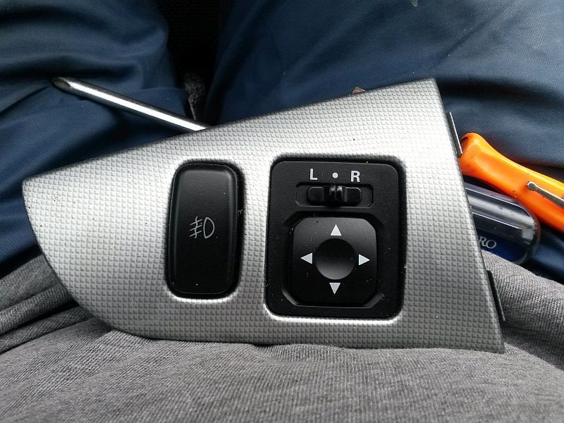

This year the 13 year old faux carbon fibre grey soft-touch finish on my dash inserts began to smear a bit and stay really sticky. I took them to a respected shop to have a vinyl overlay applied. However, the vinyl would not permanently adhere to the inserts. The installer tried different glues but could not get satisfactory adhesion, and he couldn't get the old sticky finish off, even after trying various chemicals.
So I take'em home and try goo-gone and all kinds of other stuff. No joy.

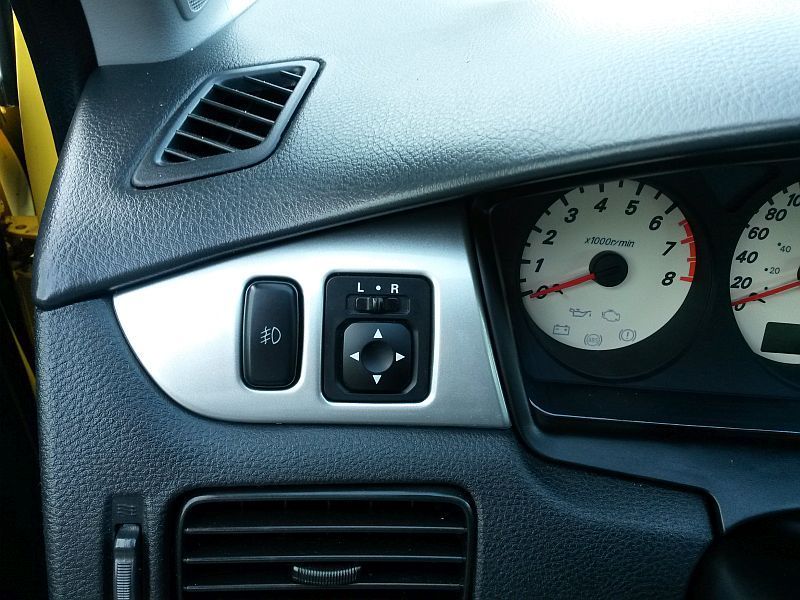

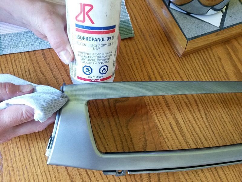

Then the wife walks over and rubs on 99% isopropyl alcohol with a little towel. BAM. Wiped the old stickiness off no problem. Underneath was a shiny, perfect aluminum grey paint finish that matches the rest of the interior. Took about 10 minutes to clean up both inserts.
To experiment, I tried cheap vodka but it's lower alcohol content was too weak. Must use 99%.
