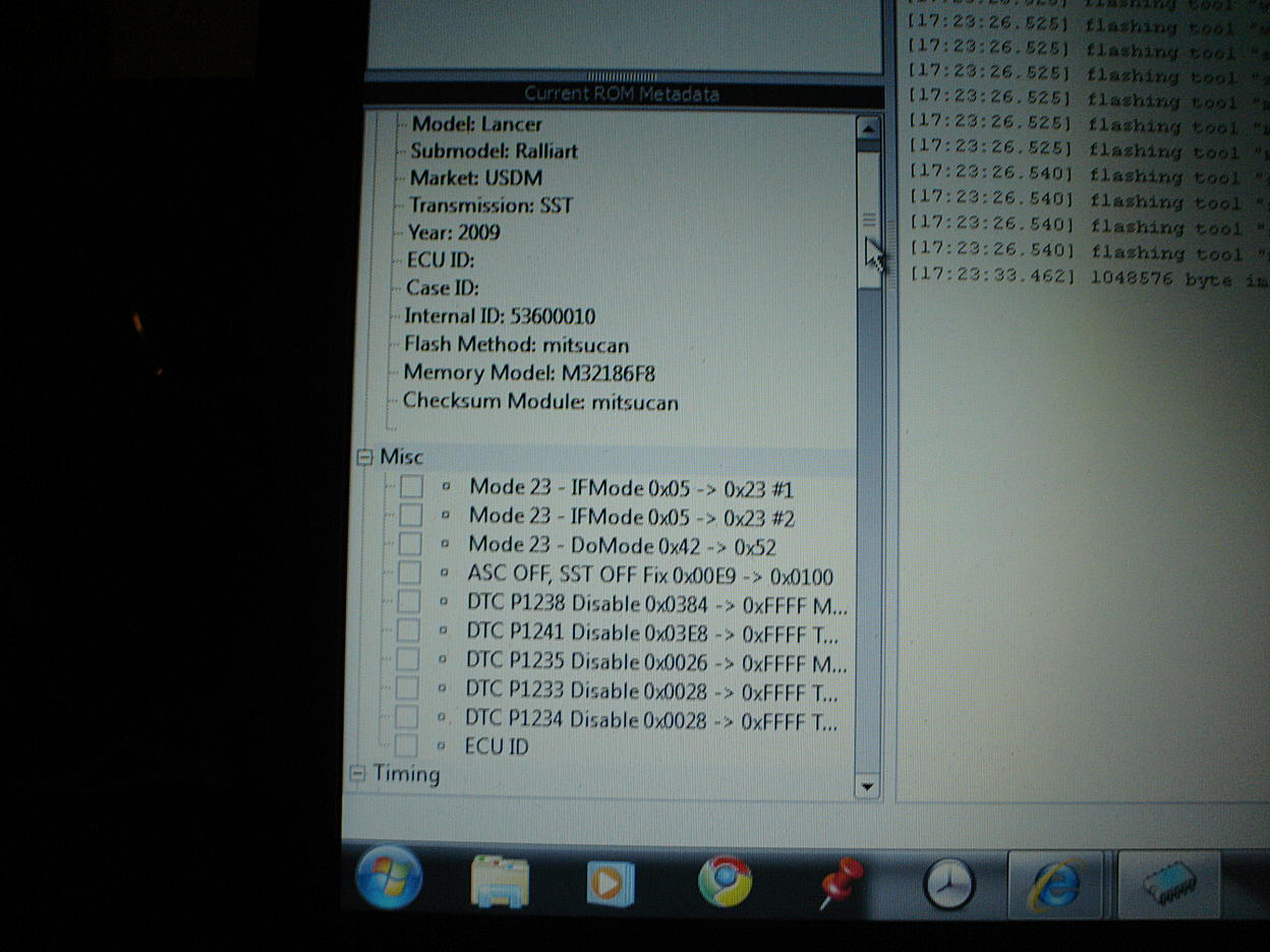

Ok.. question.Im guessing since theses are unticked thats why I can't log. I need to enter the value amount 0x23,0x23, and 0x52 to actually enable mode 23. I was told the rom image already had it, but I thought you had to manually enter this correct? If someone could verify this looks correct much appeciated...

Open all three mode23 boxes and see what they say, s/b the second value in order to work (i.e. 0x23, etc)

They already say 23,23,and 0052. Does everything look to be in order? It does need to be entered manually in order to use the mode 23? I assuming this is the actually prolem.. forgive my lack of tuning and computer skills...Not my specialty. Thanks

So long story short ''not my speciality'' I overlooked some things but officially logging data as of now. So something not so complicated turned over kill from stress and not so much experience. Still learning and thats a other reason to log data. Very awesome to see some much info that never know until you "talk to the car" Very funny way to put it.
