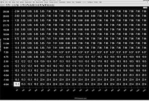

Ok guys, my car was also done at cft and from what i can tell it worked pretty dang good, I attached a pic of my timing table and would appreciate comments regarding it. Some great views on this thread so no hijacking here but just wanted to also get an angle on mine...
Any of the AEM guys please feel free to give your thoughts ;-)...thank you.
That timing map needs some work. Flat timing and running too much timing at peak torque for pump gas and not enough at high RPM's.
Agree

AMS,...which column needs some work u think, or can you expand on that a bit? Hey great job by the way on Jasons car down here from Jax ;-)...

My bad, I saved the map on my home computer and when I tried opening it up it must have opened up a default map and somehow converged it with what I had open on my EMS software at home. The download of your calibration here at the shop today is completely different than what I downloaded last night. You didn't change the calibration file since last night did you?
Still from the screen shot of your timing map 17 degrees at 20psi at peak torque on stock turbo is way too much. For some reason the map I dowloaded last night showed me 26 deg of timing across the boost area of the map.

You are not talking about my map are you?...no 17's but 7's at peak torque at 22.
Sorry, I wasn't talking about your map. Your timing does need work though, for safety reasons and possibly more power. Of course you can drive it down and we can tune it, and on our new AWD dyno none the less!
It needs work

precision:...can you ellaborate on that and can you help me? I will fly your butt down here if need be ;-)

Same as he said with the other ignition timing map. Most ignition timing is used around peak torque and it's a flat ignition map. Doesnt look like they cared to find where MBT was or spend enough time period.
