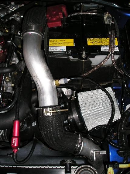

air temp sensor:
Attached Thumbnails Converting the car to speed density-evo-001.jpg   Converting the car to speed density-evo-002.jpg
